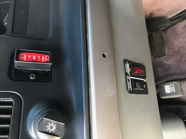

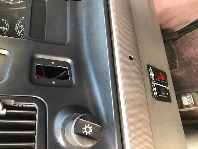

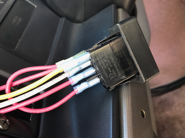

1- Wire connected to the Store/In Use switch inside the cab mounted next to the momentary switch for combining both batteries. This wire provides power to turn the house solenoid on and off for use or for charging the house battery.

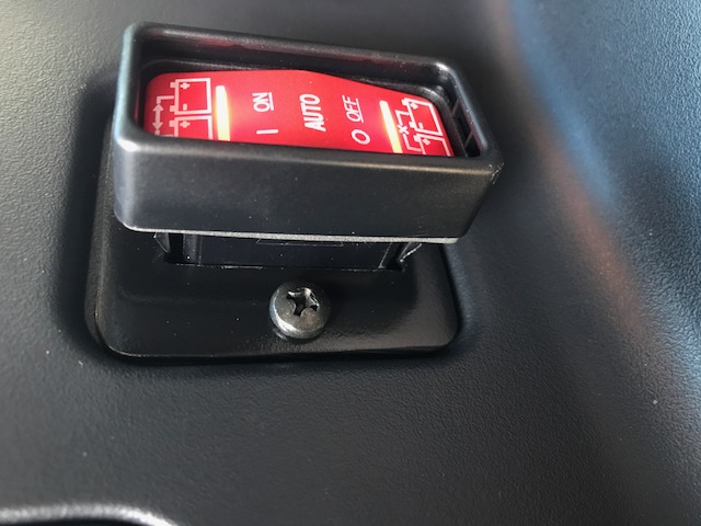

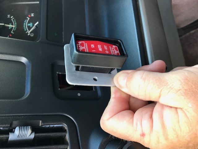

I like a switch myself. The reason for a remote switch/solenoid was likely just because with a switch, you have to have it close to the battery (because you don't want those big cables to be *any* longer than they have to be). With a relay and remote switch, it can be anywhere one wants to run a small wire and put it. Blue Sea does make a remote powered battery switch (for big boats where the engine room might be "miles" away). It may draw power too (I'm sure they have specs), but perhaps not as much as an older solenoid.reddingnative wrote:In regards to the power draw of the old school house solenoid, I'm thinking I might, at some point add a Blue Sea battery switch in place of this solenoid if it is more efficient.
I prefer just plain switches if possible. They are pretty darned robust, not too expensive, and don't lend themselves to "mysteries" as they are really straightforward. But some installations or owners favor a remote operation.
