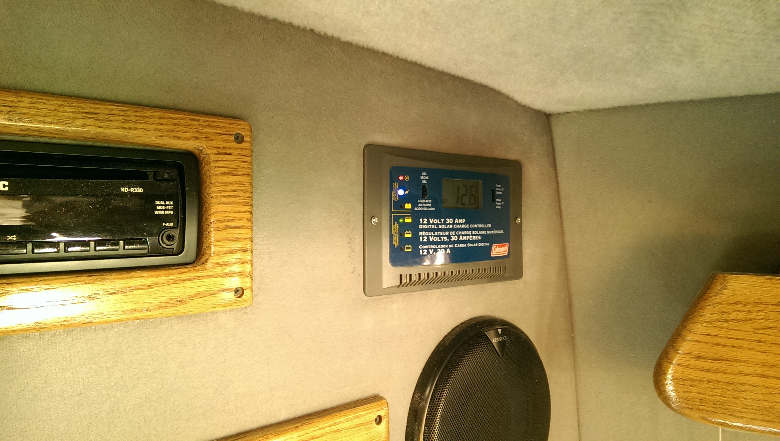

chin_k wrote:
I do have a few more modern 30A PWM chargers laying around in the garage, but they do not have the right type of mount to go in the spot where the current charger is.
This is the controller I found that fit in the OEM opening (I did have to trim the cutout with a dremel less than 1/8" or so):
https://www.amazon.com/gp/product/B004R ... UTF8&psc=1
It has worked very well, much better than the original, and the batteries haven't lost any fluid since I installed it almost two years ago, and I leave the 12V switched on continuously.
