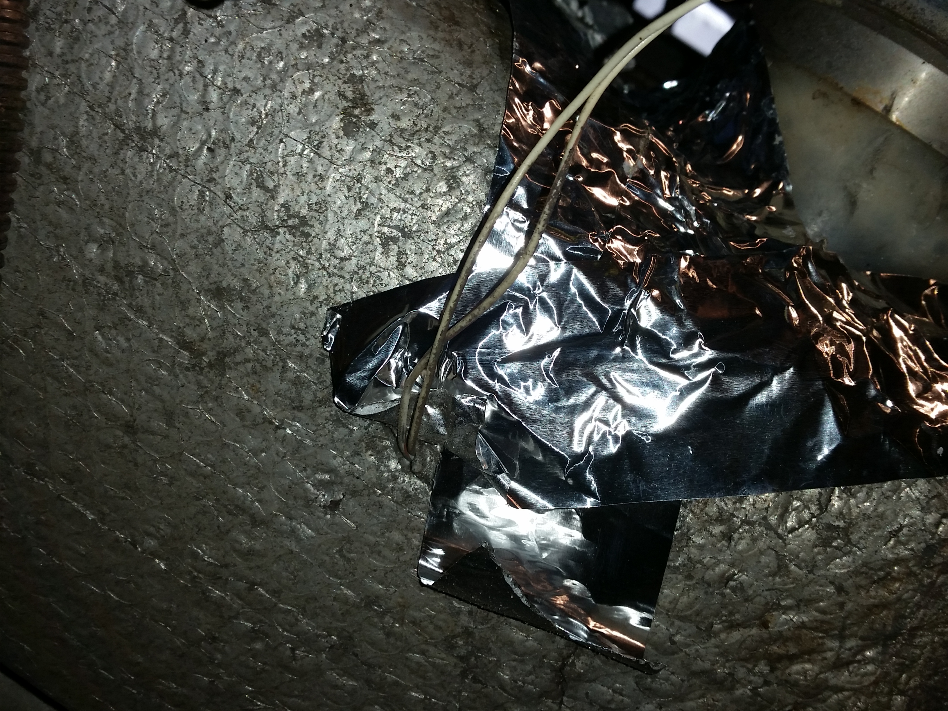

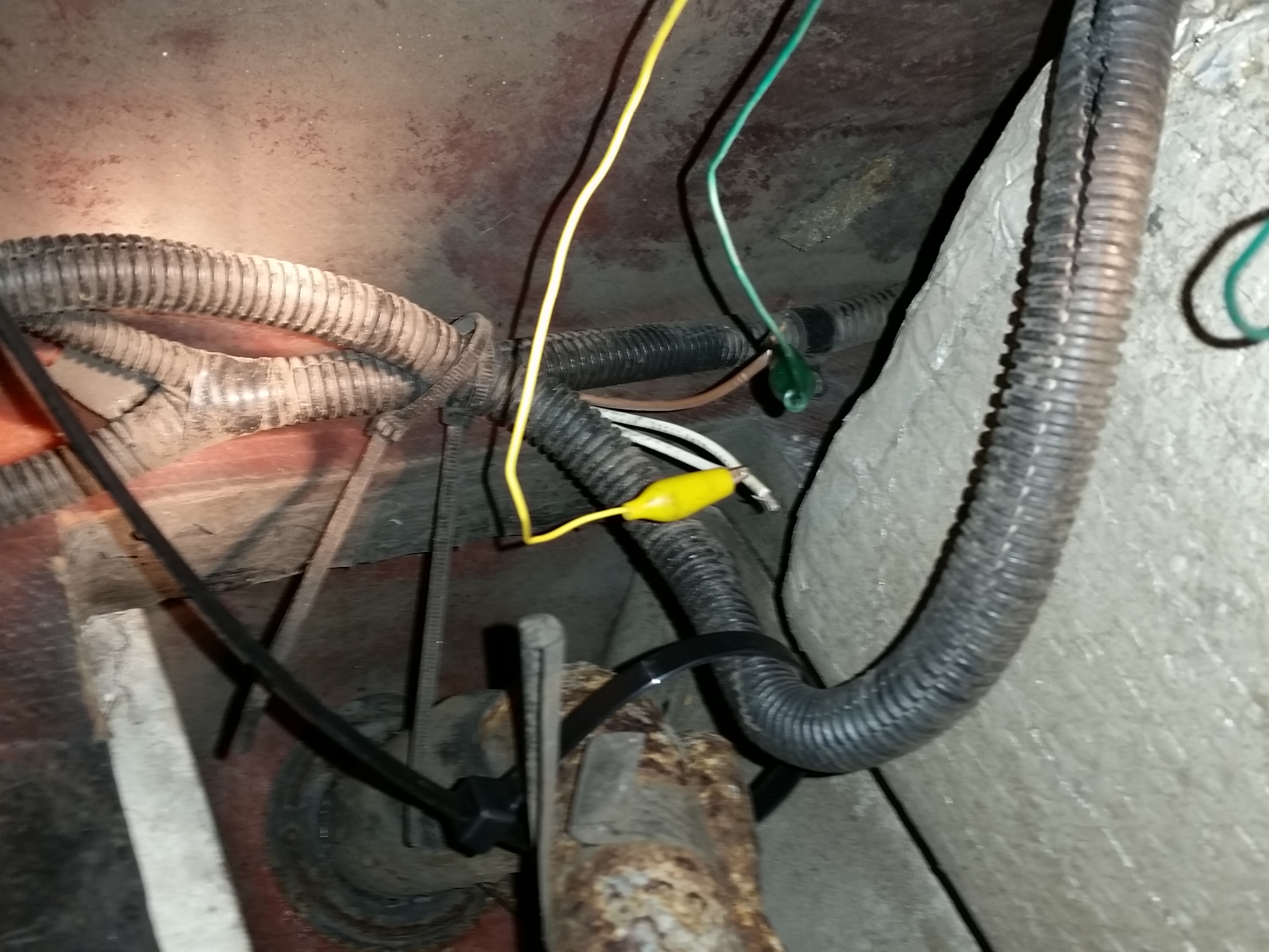

I've gotten the tank heater wiring, gray tank level and propane level monitors working. I'm not sure about the black tank level. I see two white wires coming out of the black tank that don't lead to anything and nearby I see 3 wires coming out of a harness - two white and one brown. Pictures attached. I'm not convinced that these two white wires coming out of the tank are for the level. Can anyone help with identifying where the black tank level wires and where they go to under the chassis?

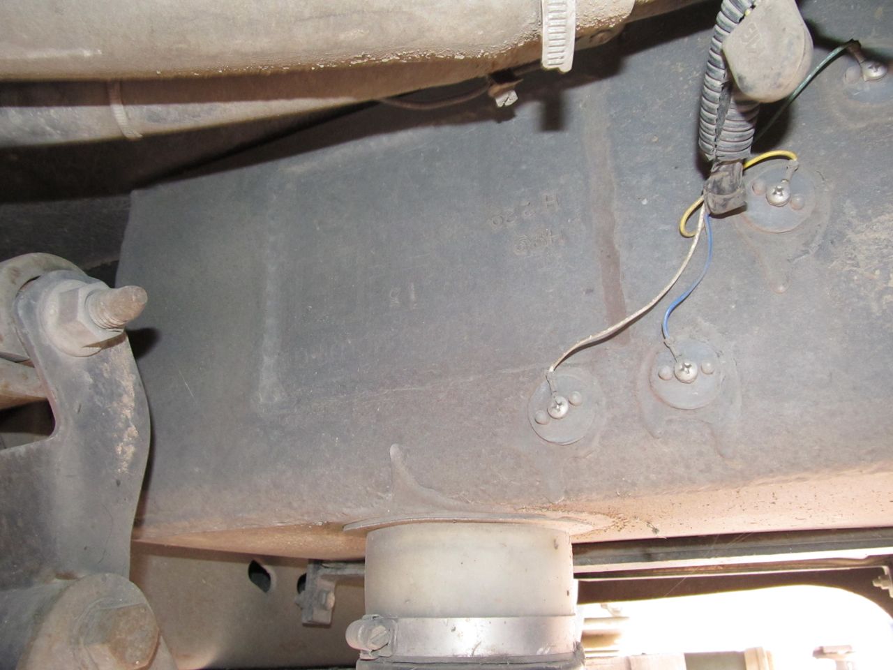

First is a photo of the side of the black tank, with all four monitor wires in place. As you can see, there are white, blue, yellow, and green wires (notice they step up in thirds like the readout).

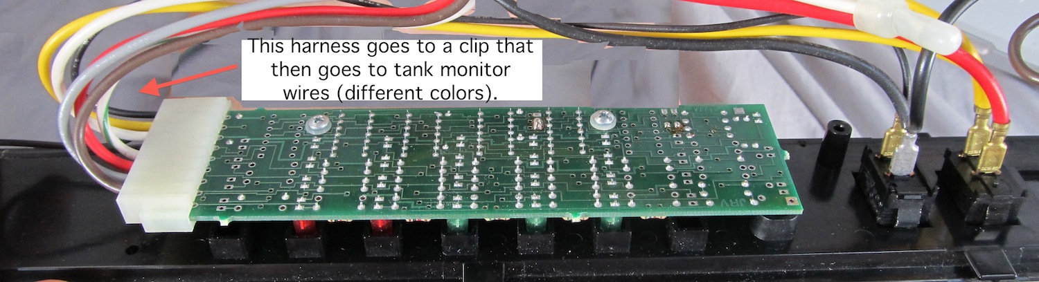

These come in to the left hand side (in the photo and in real life) of the back of the monitor panel (the monitor strip pops out of the range hood). The colors don't match because that's a "harness" coming out of the monitor panel's green circuit board for the tank levels. I have each one marked from before I took it apart (I eliminated it), but either have to dig them out or see if I can find a photo showing which is which. I'll post back if I do.

Basically on the side of the black tank there are four wires starting at the lower left and going diagonally up to the right (in thirds, natch). Lowest is white, then blue, then yellow, then green.
On the monitor panel (which pops out of the range hood fairly easily), there is a harness coming out of the left (forward) side of the green circuit board on the back. Those are the level wires. The harness colors (provided to Chinook I'm sure) don't match the sensor wire colors, but I do have them labeled or may have a photo (from when I removed it). Will have to find that. If all else fails I have the monitor panel in storage with the wire splices still on it showing which colors join to which.
Another way to see that is that if you pop the monitor display section out (about 2" x 20" panel), then pull it out a little bit you'll see that wiring harness on the left that I show with the arrow. I think if you gently pull that out a bit you'll be able to see where Chinook spliced their wires on and thus figure out which color goes where. You may not need that info, but if you do.
A last note is that, if I remember correctly, those black tank wires (by the tank) go into a loom that may also contain a couple of other wires --- maybe they were the ones for the lighted dump valve area. So don't be surprised if there are more wires joining in at some point sharing the loom.

What you describe makes perfect sense and what I would expect to see exiting the black tank. For better or worse my tank is insulated and the wires I see coming through the foil are the two white ones. They're fairly thin and so I don't think they're for the tank heater. I found other heavier gauge wires coming out at a different location on the tank that I hooked up to the harness for that circuit. Without knowing the make and model of the tank and/or having coach electrical schematics this is really not fun.
