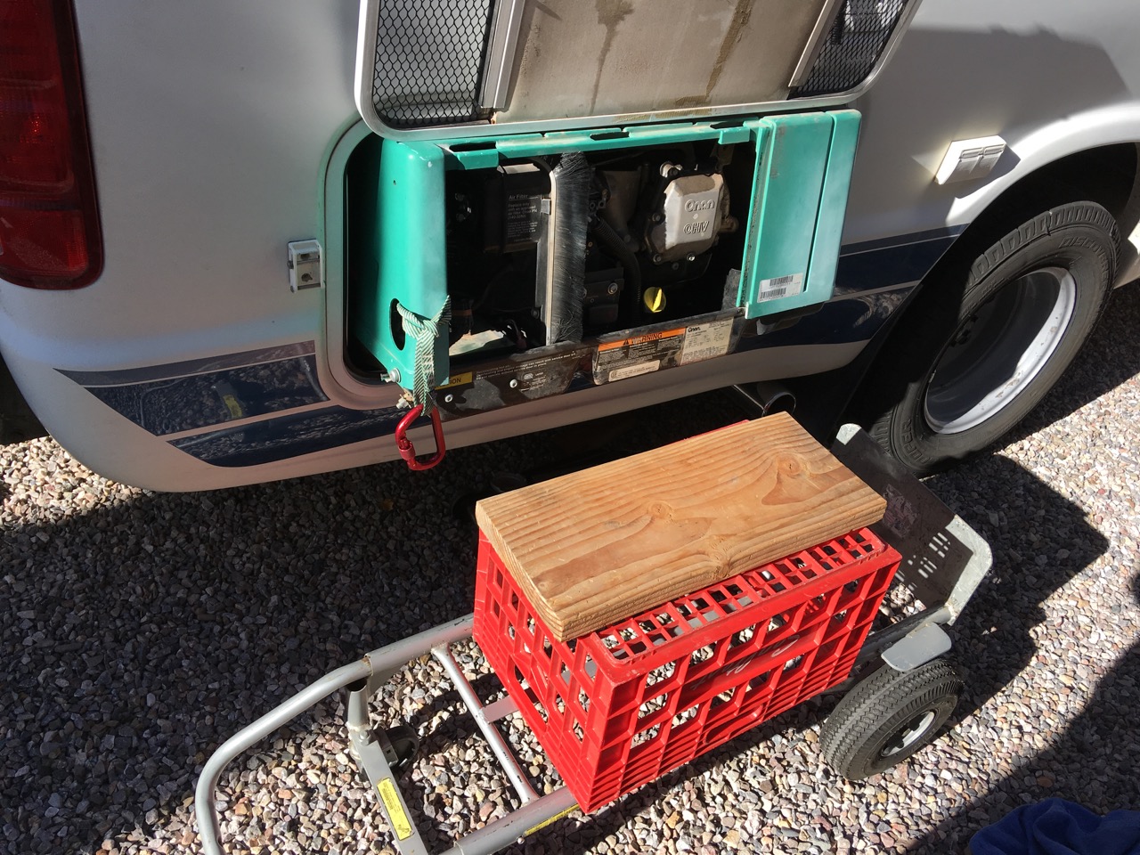

The beast hath begone! Suitably emboldened by Scott’s tips I removed the Onan 4KY this morning.
First, I attempted to remove the hatch trim and door for more wiggle room. No such luck; it was still held firmly in place by some mysterious force even after all perimeter screws were extracted. Prying didn’t budge the trim and only threatened damage.
It was easy to remove the exhaust pipe and five bolts underneath that held the unit to the plywood floor. Now for the harder part - those pesky 4 electrical connections plus fuel hose that were wedged against the left wall. The generator had to be leveraged sideways to the right, just as Scott advised, to gain more working space. Then everything came off with a liberal dose of patience but I finally resorted to wire cutters on the red/green/white wires disappearing under the control board.

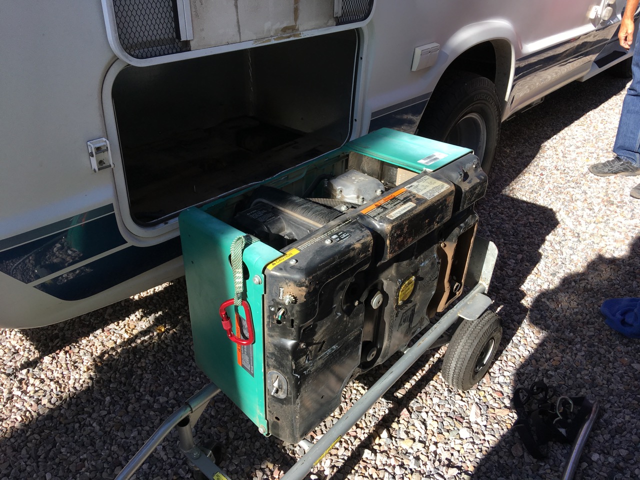

Extracting the untethered generator then proved the hardest part. It needed to come out square to the opening otherwise the case hung up on the door flange. It certainly would be better with this piece off. Damage to the flange became inevitable after I found no way to finesse the situation.

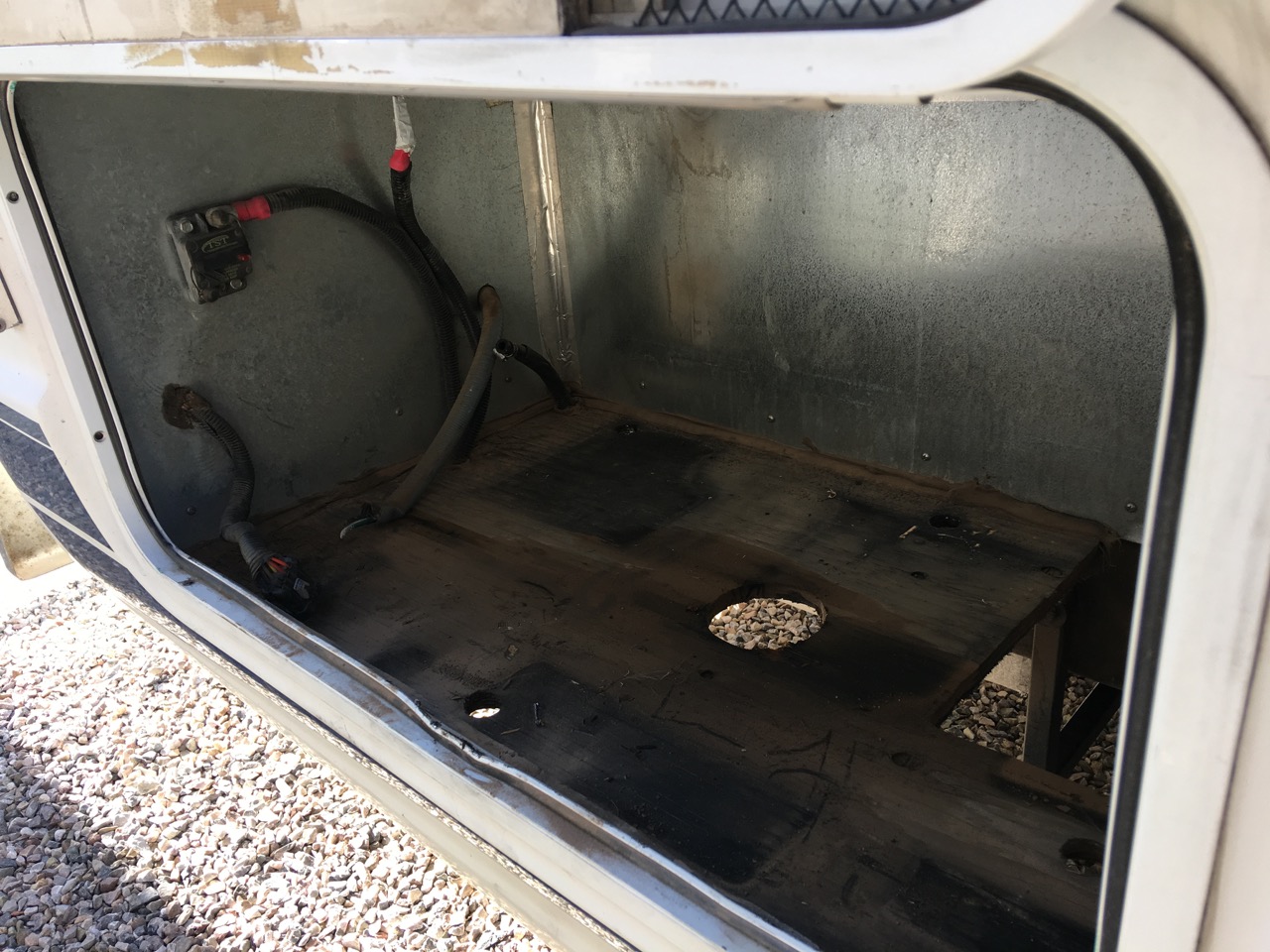

The pictures tell the tale. I wisely placed a hand cart to catch the generator and remove it from the scene for later disposal. Now I’m pleased with all that extra storage space but need to seal the bottom with a nice floor. The original plywood is rather distressed and full of gaping holes that naturally let in dust. Finally, I remembered to plug the fuel line in such a hazardous location under the gas fridge!

File comment: Hmmmm... definitely a tight squeeze
File comment: A good catch as the generator suddenly popped out
File comment: Plenty of room now after some touchup work

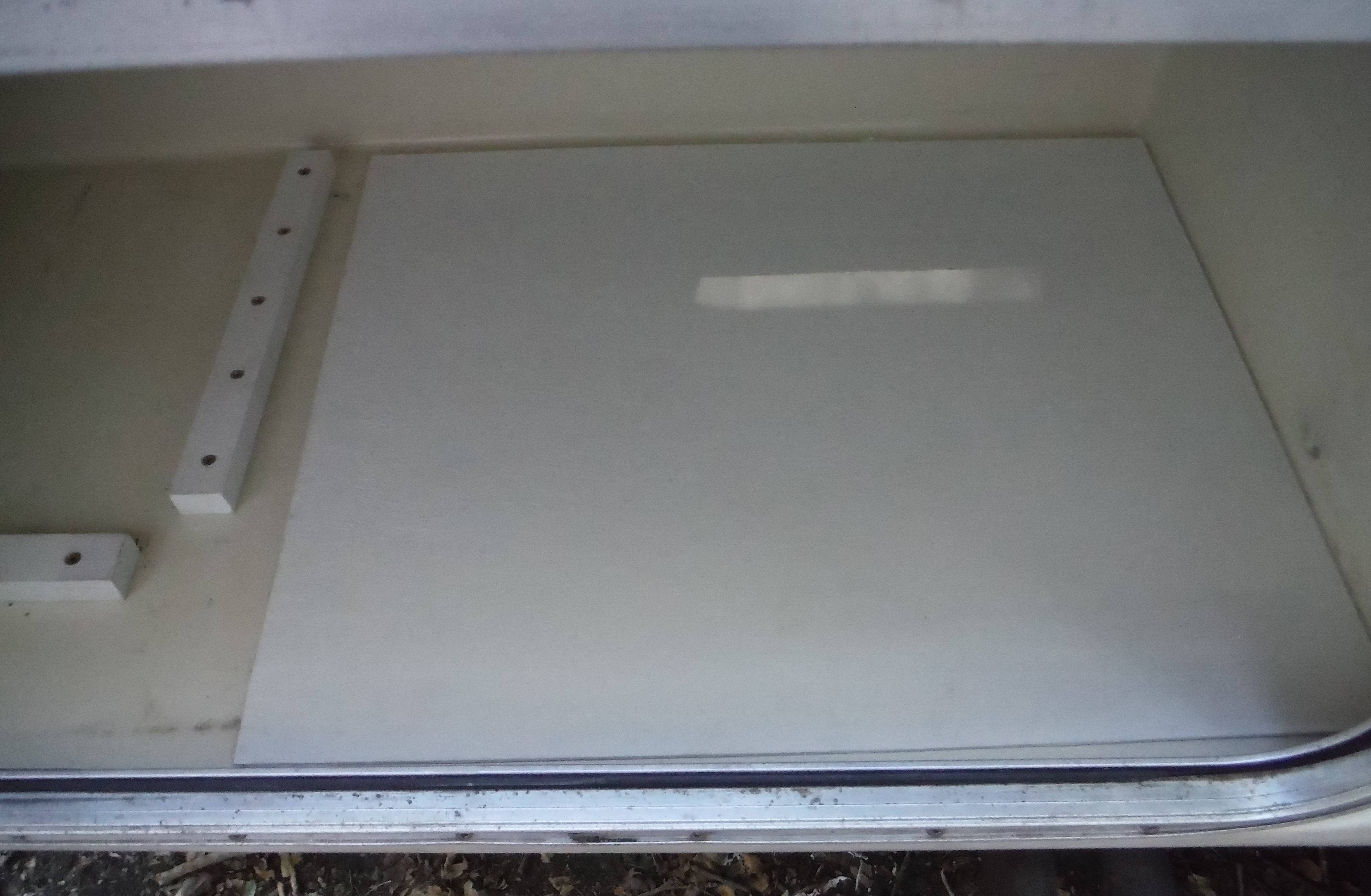

The generator enclosure in my Chinook is all fiberglass, so again we're different, but I wanted to show how I handled the holes in the floor. 1/4 inch plywood, a couple coats of oil based primer, fixed to the fiberglass with acrylic caulk. Underneath I sprayed black undercoating. For the fuel line, the hose is fixed to the bottom of the rig and plugged with a steel dowel pin and hose clamp; it's just as safe as the Onan connection IMO. The three holes to the left are covered by the batteries (not pictured). My door has only one screen section (at the rear); very little dust gets into the compartment. I considered covering it from the inside but it provides ventilation for the batteries.
