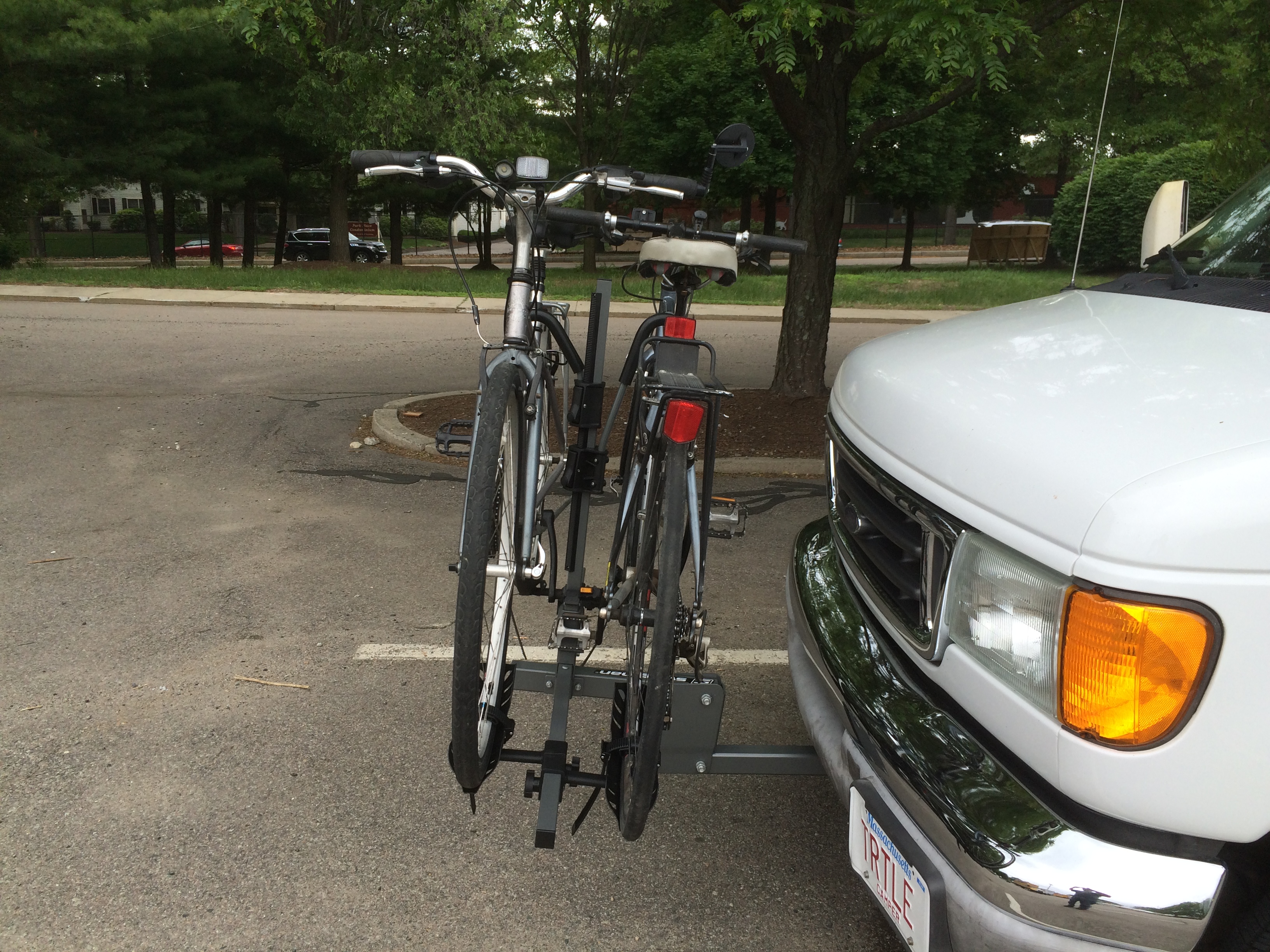

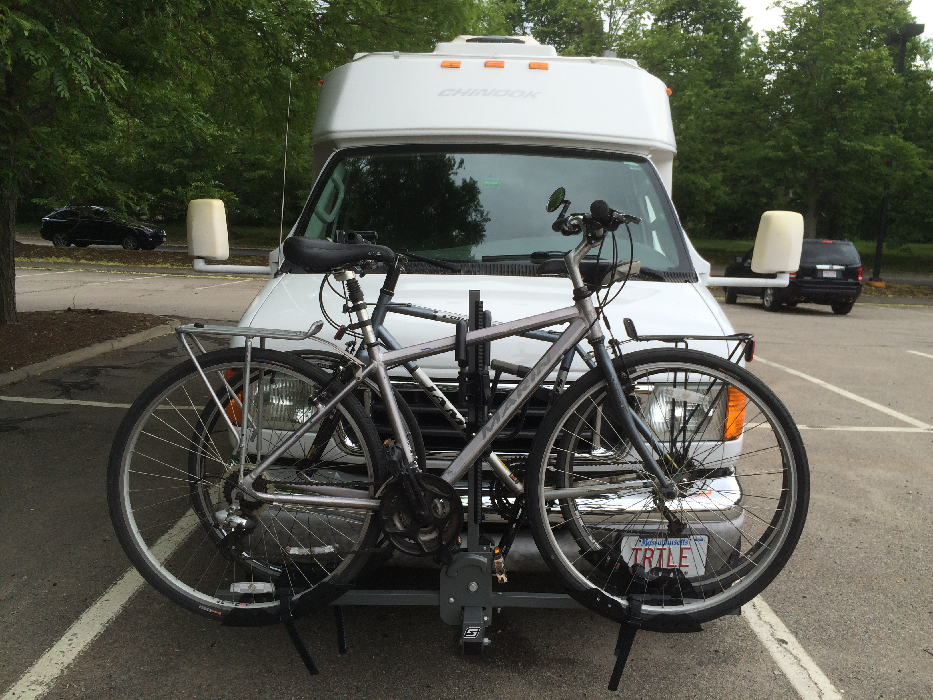

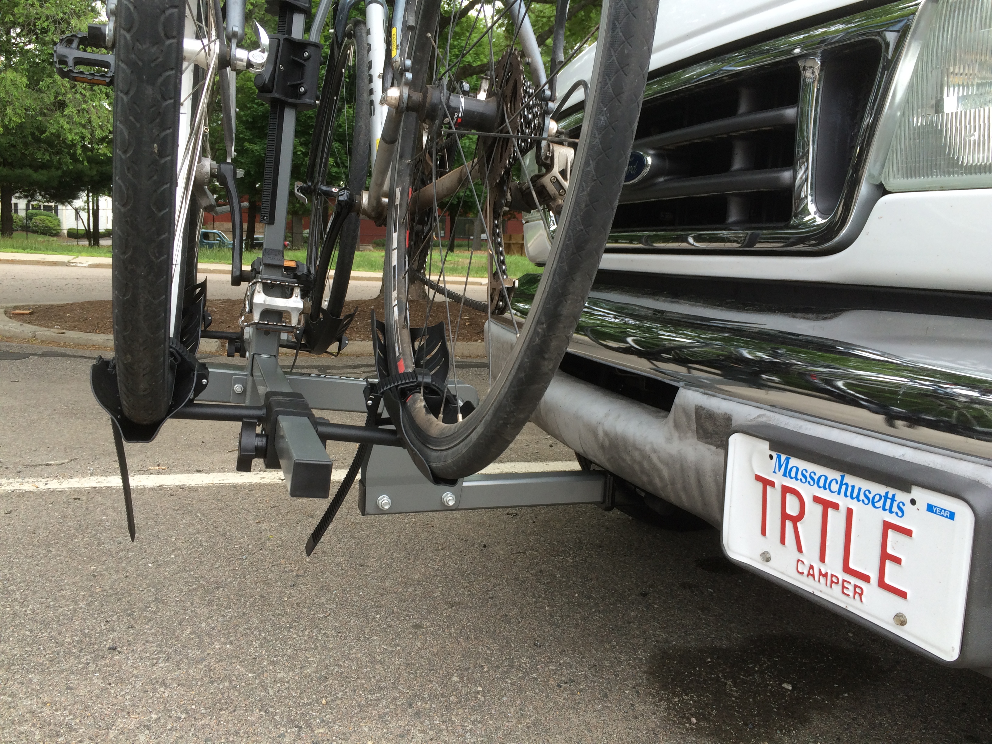

I have put a Swagman Disparch bike rack in front of our 2004 Premier--having previously mounted a front hitch. This is a very sturdy unit (threaded pin through hitch to eliminate wobble), with single crossbar that holds 2 bikes. The out of the box mount diagram was a tad too far out for me, so I re-drilled the plate to shorten the extended distance from the grill...BUT, not so much as to have it so close that bike handlebars would interfere with opening the hood. I spread the mounts for the bikes such that the headlights shine right through the spokes...using headlights has been fine--no issues at all on six week trip last summer from Boston to Montana and back (night driving included). So I imagine that small wheels of folding bike would create even less interference. I also have the option of dropping the rack to hitch level (down about 6 inches from where it is now) to make it easier to mount my new electric bike (Copenhagen Wheel) so motor in wheel will not block headlight...just need to drill two more holes in the plate that holds the horizontal "out" bar of the rack.
I have attached a few pics of the set-up from different angles.
