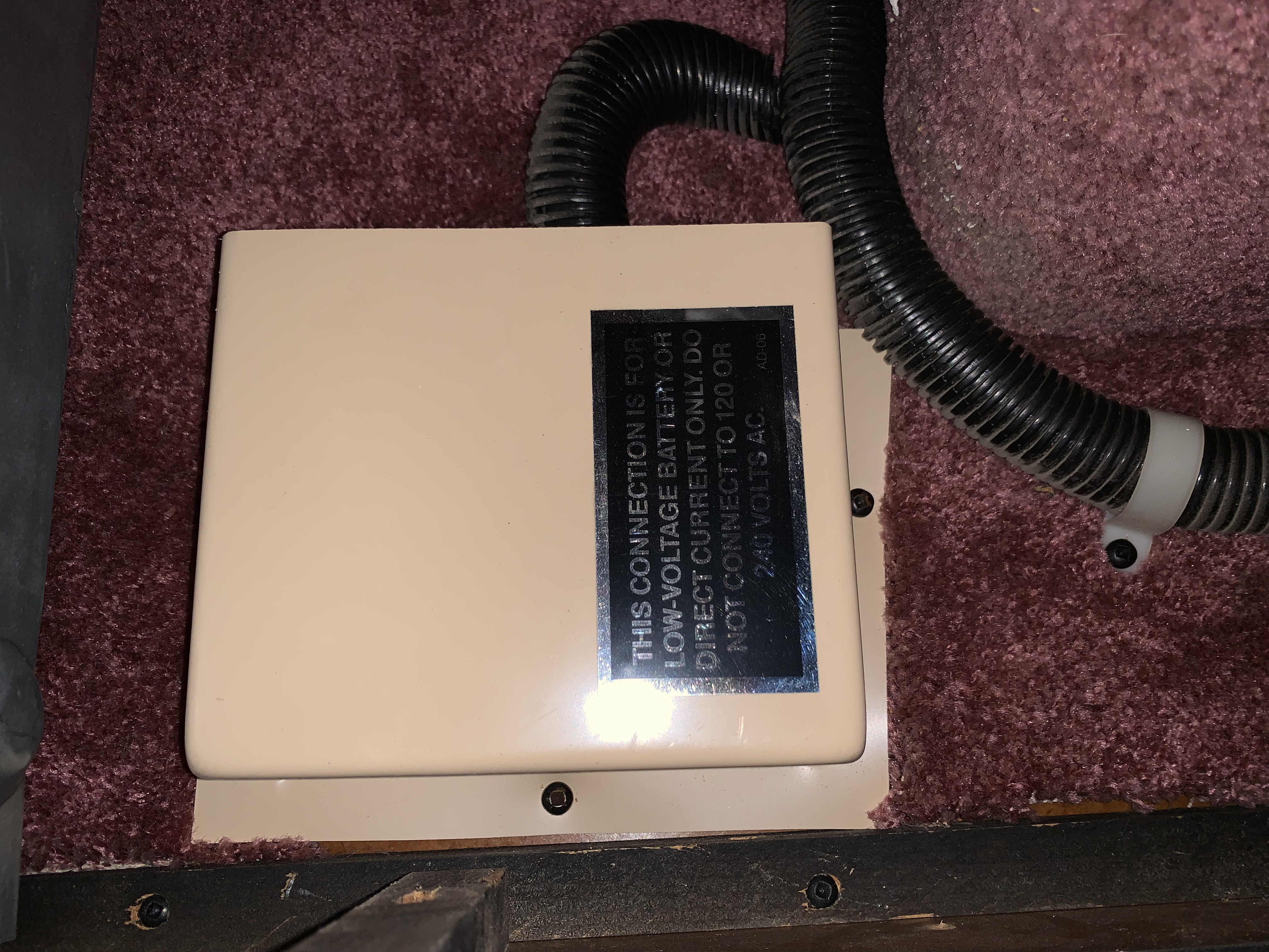

The short stop under the stove is battery to house red positive wire. Right under the stove, behind a expanded mesh door (for ventilation) are the inverter/converter and another plastic cover with 3 square head screws (Chinook seems to love square head screws). Remove that cover and the short stop is behind it. I removed my stove/oven to get to it more easily. 6 screws and disconnect your gas line to remove the oven (4 on top and 2 on the sides...access them by opening the oven door). This circuit breaker/shortstop appears to be the second in the circuit from aux battery to the house fuse panel (first is on the firewall).

Thanks for the reply...generator works great, air conditioner works great. Onward to other issues. Attached are the pics of the door under the stove/oven, the plastic housing that contains a ShortStop and the Texas Instruments Klixon automatic circuit breaker under the hood with white positive wires that feed the generator. Thanks for the assistance!
