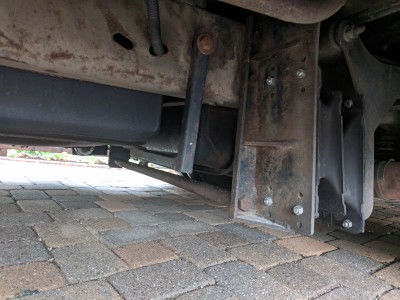

Re: Air lift bags to install on Rear of 2004 Chinook Concourse
Here is a picture of a MorRyde rubber spring behind the rear axle. If you don't have these, you don't have the MorRyde system. If you do, make sure they are not torn or worn out. They can be replaced.
