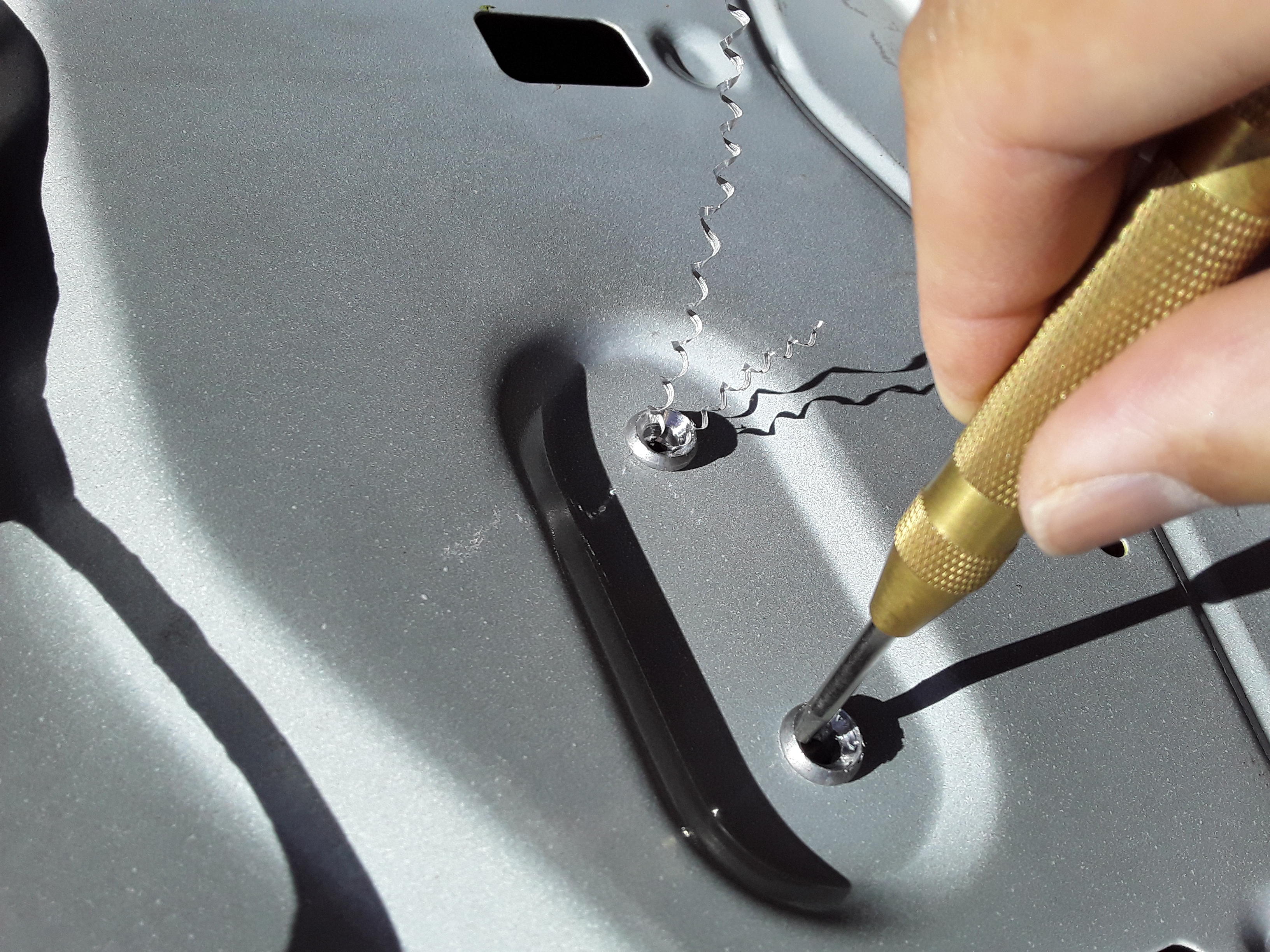

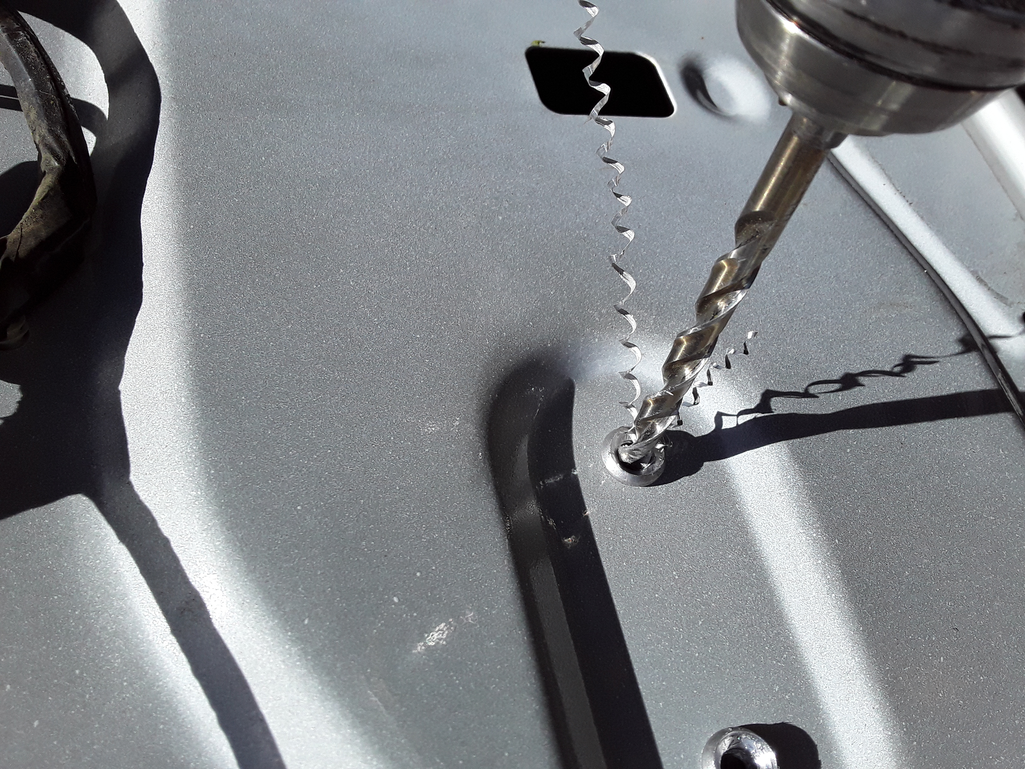

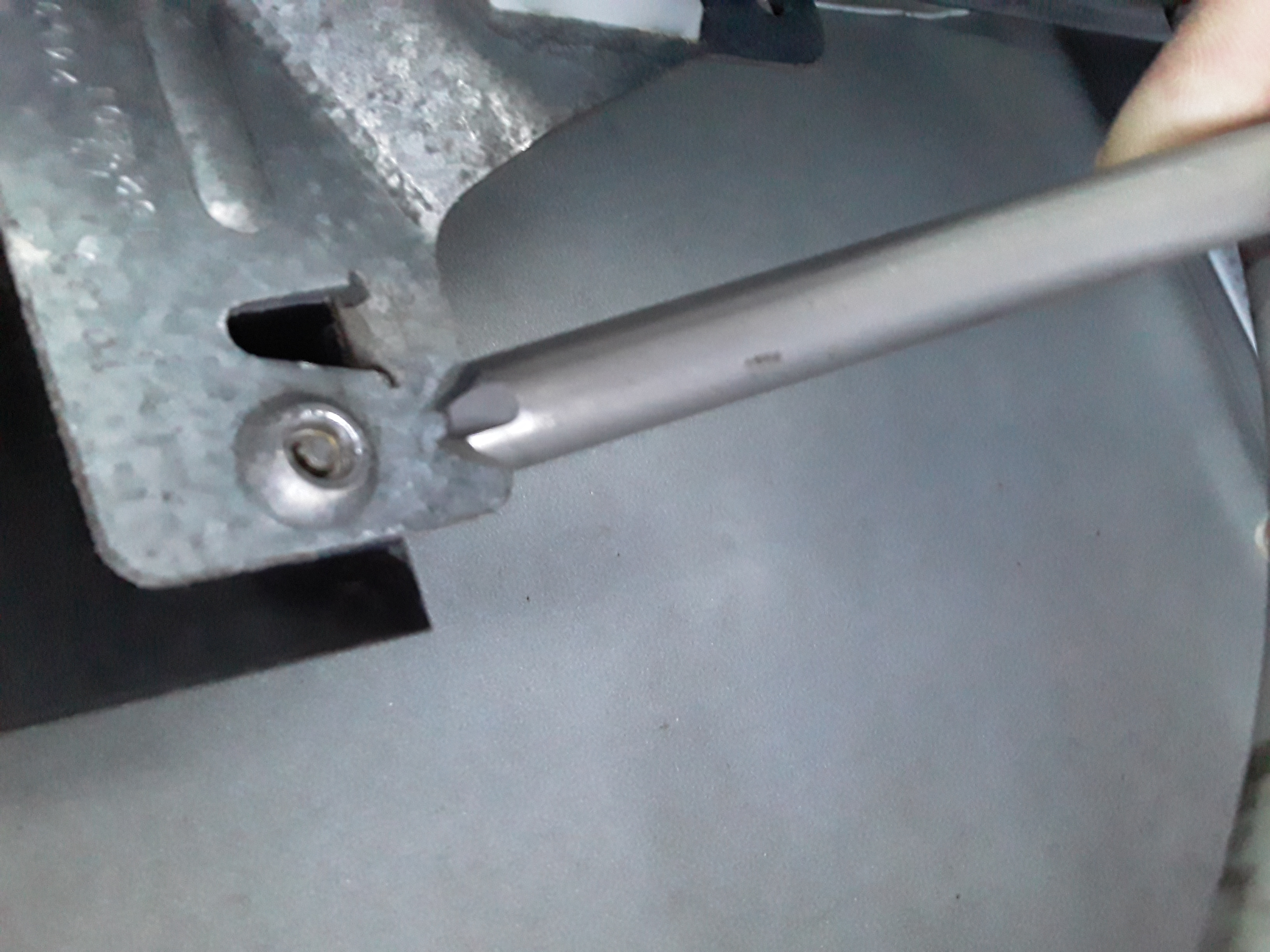

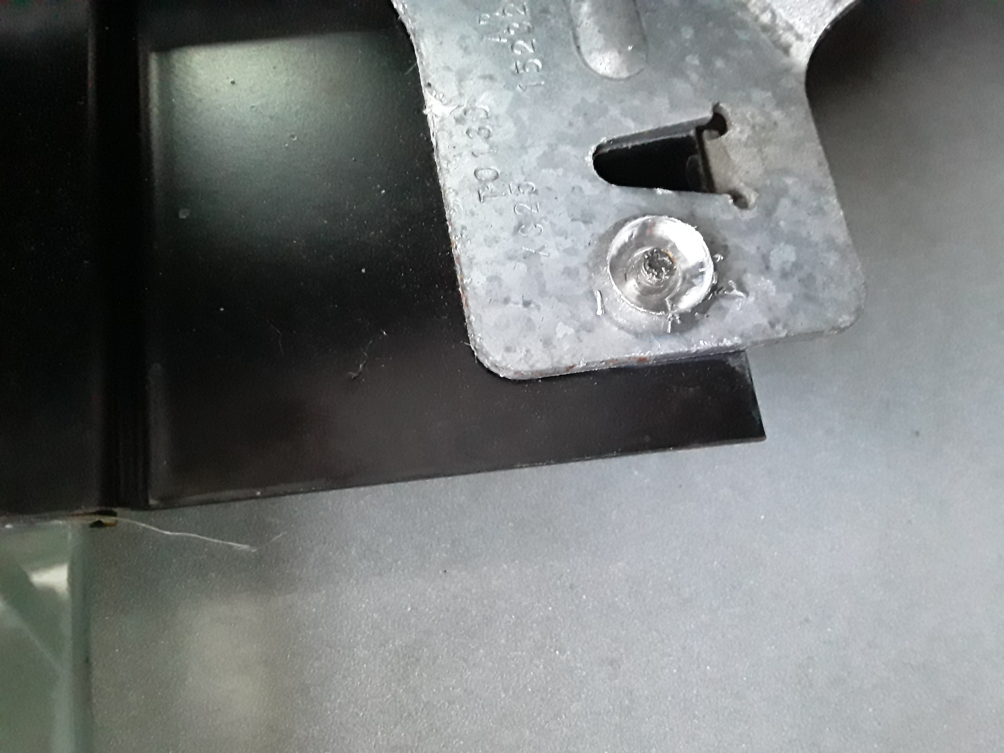

What happened to my regulator is that there is a plastic piece that hold the regulator cable to the carriage that move the window up and down the metal rail. Due to age, the plastic piece broke, and the cable came off so it can't pull the window up. If you have not moving the motor too much, you maybe able to fixed this by adding a metal piece to replace the plastic piece, but if you try to move the window up and down, the cable cassette and/or the cable maybe ruined, and you will need a new regulator. A non-OEM chinese regulator is about $35.
Anyway, the most difficult thing is to drill out the rivets if the regulator is original. You can use the center punch to push out the pin first and skip drilling the soft aluminum. The window is attached to a tap, so the rivet are not directly on the glass. But I would put something behind the carriage to give it more structural support before going at it with a center punch. I tried, but the pin did not come out, so I did an extra step.
Anyway, what I did was to drill out the rivets partially using a CRL "rivet eater", then use a center punch to push out the steel center (it was easy three taps, and it came out easily), then finish it off with a 1/4 drill bit.
https://www.harborfreight.com/spring-lo ... h-621.html
I replaced all the rivets (7 total) with 1/2" long 1/4-20 bolts instead of getting rivets and install them back. I use Loc-tite on the thread.
Being a bit OCD, I put paper behind the panel to catch all the shaving and loose pieces. I don't want to carry extra weight on my RV to cause my MPG to go down
