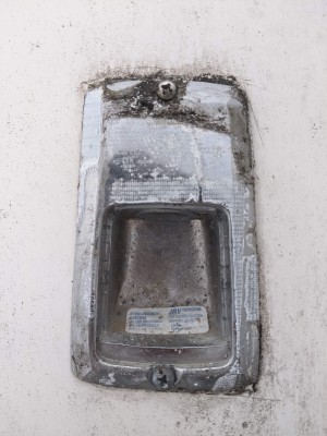

My porch and awning lights have missing bulbs and lens covers. I've searched this forum and it seems like replacement lens exists, but what should I do if the bulb/socket are also missing? Should I replace the whole unit? If so, where can I buy replacements? Also, are there any electrical schematics for how to reconnect these lights to the vehicles electrical circuit?

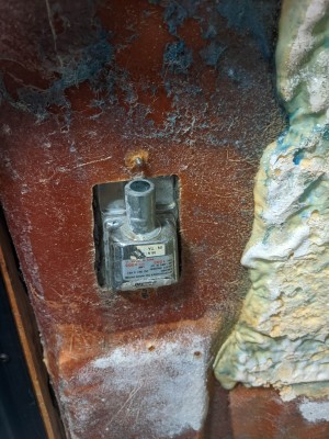

Sourcing replacement units may prove difficult since JRV Products have gone out of business. Not to say a stash of them may pop up on ebay down the road but you will have to keep an eye out. In the meantime you should be able to rebuild what you got just to get them working. You can buy the appropriate light bulb repair pigtail that will come with the wire, lead, and spring. If you need a second wire for ground, soldering one to the socket cylinder isn't difficult. another option is retro fitting if you can find one that is somewhat close to the original or just mount something that covers the hole where the original once was.

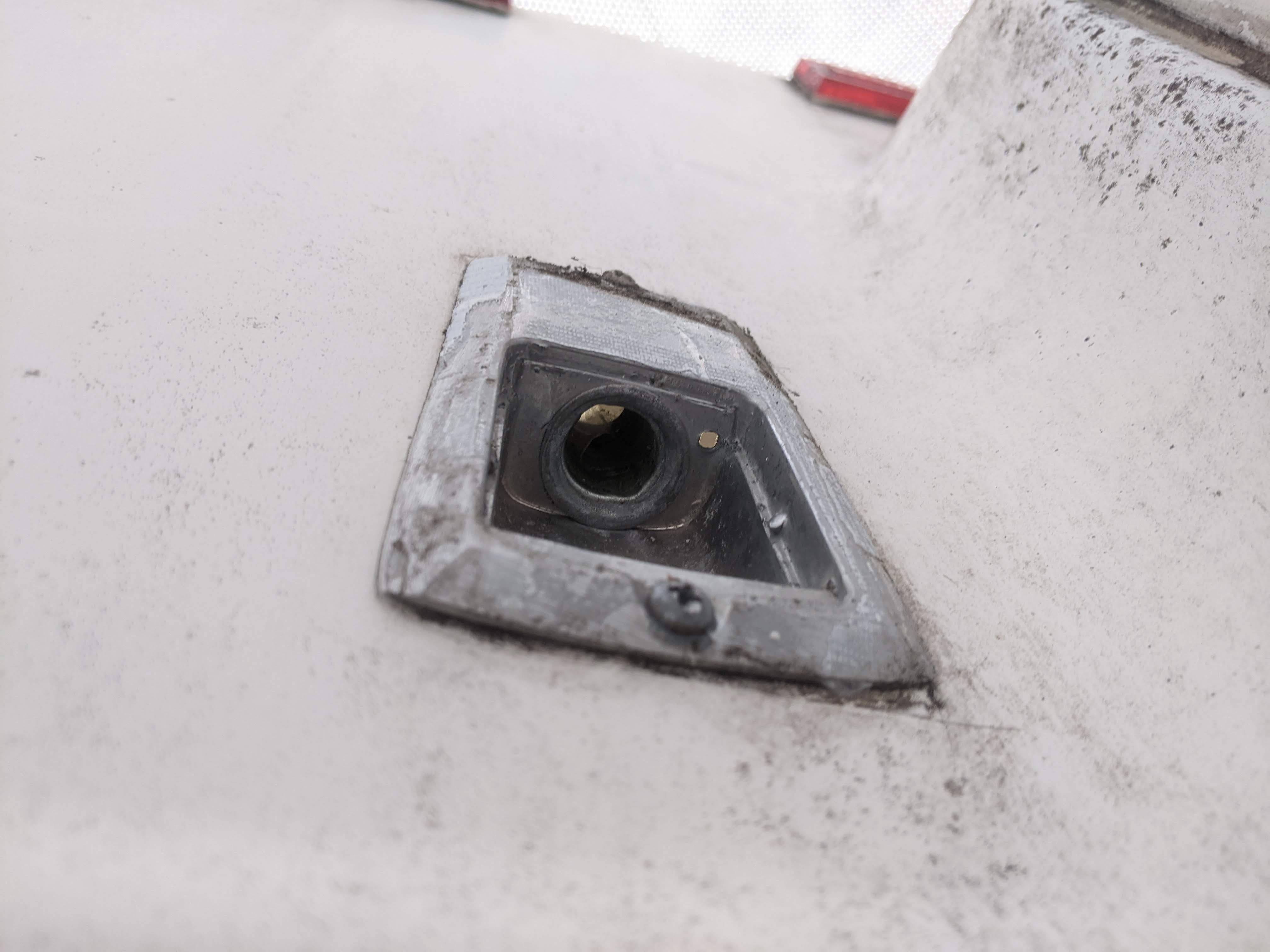

Thanks sm350bl. I found the replacement lens on this website (https://www.woodlandairstreamparts.com/ ... 4178431076), but I am still unsure as to how to add a "light bulb repair pigtail". If you look at the second to last image posted previously, I'm assuming that I would feed the repair pigtail through the opening in the light housing, but how would I attach the pigtail to the light housing?

Yeah I am going to have to apologize. I am not as slick to reference websites or construct a page with pictures. But I did find a picture of what I was referring to online. Since the porch light is a turn lock base ( ground ) and a center point of contact on the bulb for power.
https://www.zoro.com/grote-lamp-socket- ... gLWEvD_BwE
so once the wire is cut from behind the porch light, the pigtail should come out the front of the light fixture. then you would load something like this from the front and splice connect the wire then you should be able to twist a new bulb into it and have it work. put your new lens on and be on your way.

Thanks for you help, the images/links helped me understand! I just ordered the replacement porch light lens and will find the pigtail that will fit in the opening of the light housing. I'll post pictures once it's fixed
