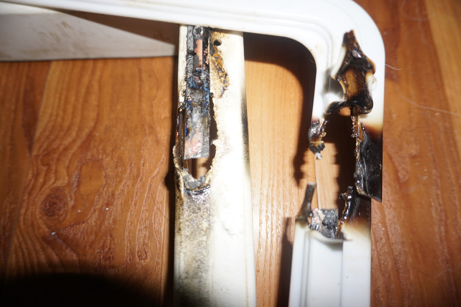

I have a fantastic vent fan in my concourse. Since they do not come with a light like the original vent fans did a person has to figure out how to put a light back in the bathroom when installing a maxfan or fantastic fan in the bathroom. I chose this style of LED light for its simplicity, huge mistake.
These things are a fire hazard so be warned if you have one. It started to rain while i was sleeping and the bathroom vent lid was open slightly, it rained hard enough that water ran down the interior of the open lid and pooled inside this LED light. Eventually it shorted out and literally started to burn and melt. No fuse blown, nothing, this would have likely started a huge fire if i had not smelled it first.

I wired it into the existing wire that powers the fan. That said it should be fused already, but it didnt blow a fuse. I smelled it burning but i couldnt find where the smell was coming from. Then after 5 minutes of looking under the sink and everyplace else i opened the bathroom door and smoke billowed out of the bathroom despite the vent lid being partially open.
It is dangerous, you can see how the plastic cover is recessed to cover the LED strips inside, when water gets in threw the vent lid it acts as a water trap and before long the LED strips are swimming in water. If your rain sensor fails and the light is on youre gonna have problems. Once water is inside that plastic cover i imagine it would take a few days for it to evaporate depending on your climate.

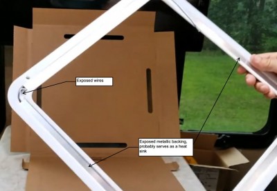

I received the LED unit today, and I looked at the back of it. I didn’t want to completely remove it from the packaging because I am returning it. As I thought, it is not sealed to prevent a short. See the attached photo taken from the Web. The wires are exposed and each LED string on the sides has a metal backing, which I suppose serves as a heat sink.
No wonder it burned!
The other interesting fact is that it has a 1-year limited warranty. But it specifically states: “Warranty is void if damage done to the unit due to:
• water leakage/seepage” (My underlining),
• Among other items listed
Lastly, as Chin thought, there is no indication of UL certification on the item box.

Yes exactly. Now that you have one in your hand you can see how it would eventually fill up with water from condensation or water coming in from the vent if it rains. A person could drill a small hole in each corner so water could drain out, but after my experience they arent worth taking a chance on. I know alot of people have purchased them and i hope they never find out how dangerous this product actually is. Whats worse than the exposed wires is the fact that under each of those metal strips there are electric circuits that are completely exposed to moisture with no protection. You can see in my images that the fire didnt start in the corner where the wires are, it started with the exposed circuit under those metal strips.
