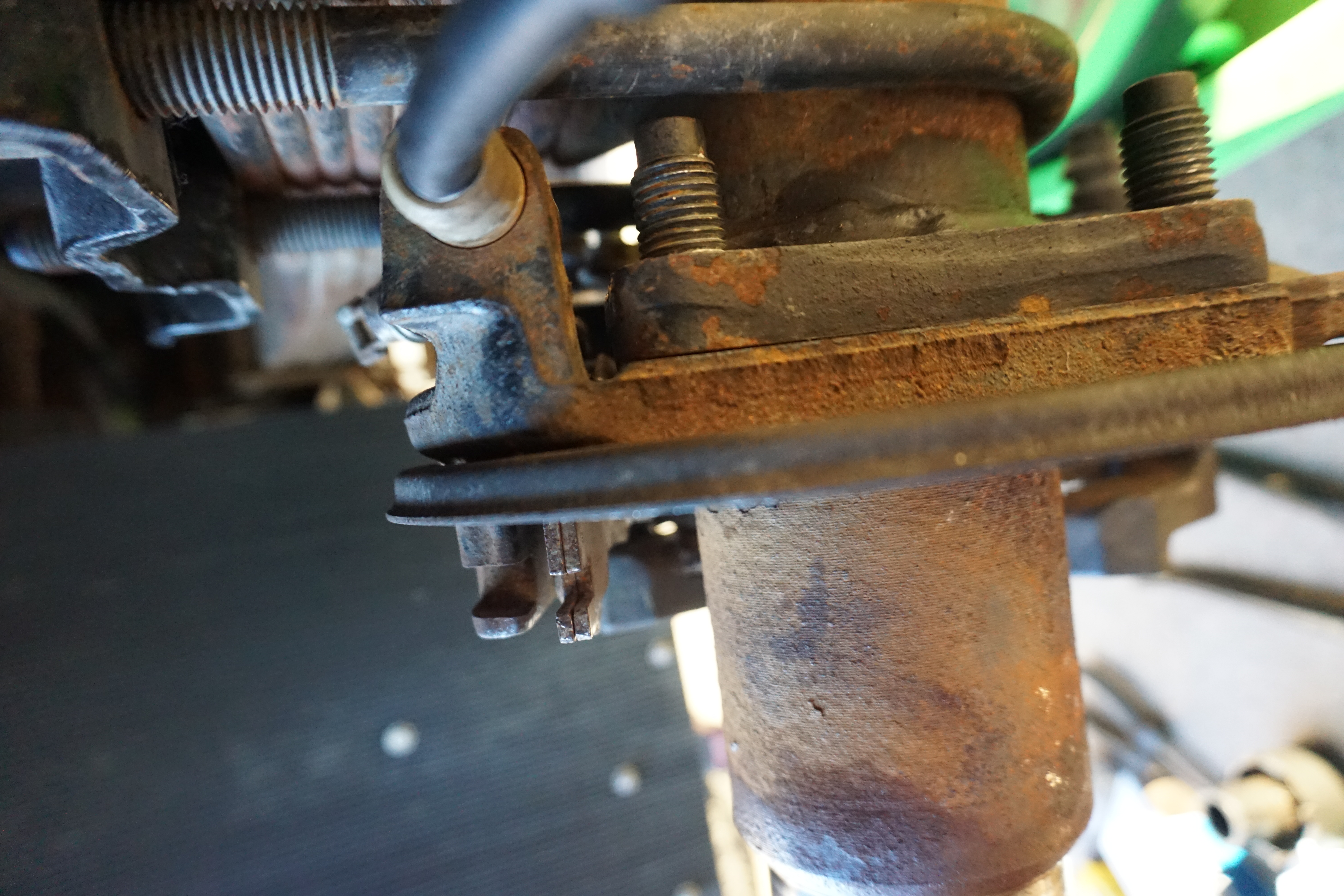

This is a photo of a stock Chinook concourse rear spring with a stock caliper bracket, backing plate, park cable, U-bolts etc... Anything narrower than your existing rear axle is going to present clearance problems.

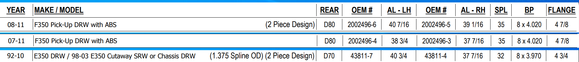

That leaves you getting a Dana 80 from an actual dually truck which when compared to the Dana 70 which is in your truck is not the same width and likely has a different pinion offset as well. Here is a comparison between your two dually pickup options. Obviously one of them is going to be to narrow and the other although wider by a couple of inches is going to push your tires/wheels out of your fender opening. AL-LH and AL-RH means axle length left and right. Your truck is listed at the bottom for comparison.
The next issue is that you stated youre going to run a sterling rear axle. It is my understanding that the sterling axle was only installed in SRW f-250 trucks and excursions, the Dually pickups and F-350 received the Dana 80 axles. The sterling axle will be to narrow for your application and wont work on a dually truck if you plan to retain rear dual wheels. I believe on or after 2017 ford did actually install a sterling axle in the F-350 but dont quote me on that.Concourse 4x4 conversion

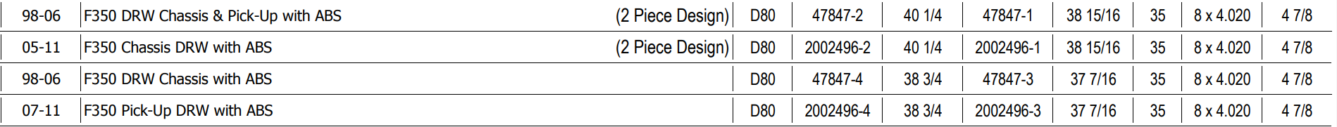

Here are some more axles based on year for the F-350 trucks for comparison. As you can see when compared to the E-series Dana70 dually axle they arent the same. Even though a couple seem like they may work (after cutting off the spring and shock mounts and relocating them) you end up with your tires/wheels sitting beyond your fender openings. Not trying to knock the wind out of your sails just letting you know there is always a compromise. That is exactly why i handled the rear axle in my truck the way i did.
