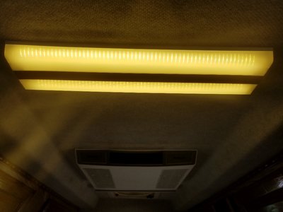

Re: Removing Fluorescent Light Fixtures
Post by rgmullins »
I replaced fluorescents in mine with LEDs. I got a roll of warm white ones off EBay for under $20 that was enough to replace all the lights. They come with adhesive on the back so you can just stick them on, but I added some hot melt glue in places because i was worried about them coming loose if it gets really hot inside.They use less power and got rid of that unpleasant color. I needed to replace my bathroom fan. I found the replacement for $35, but if I wanted a light it was $130. I had enough LEDs left over I drilled holes in the plastic trim and glued them in. I was pretty happy with the way it came out. I also added a strip under the cooktop hood to provide MUCH more light there.
