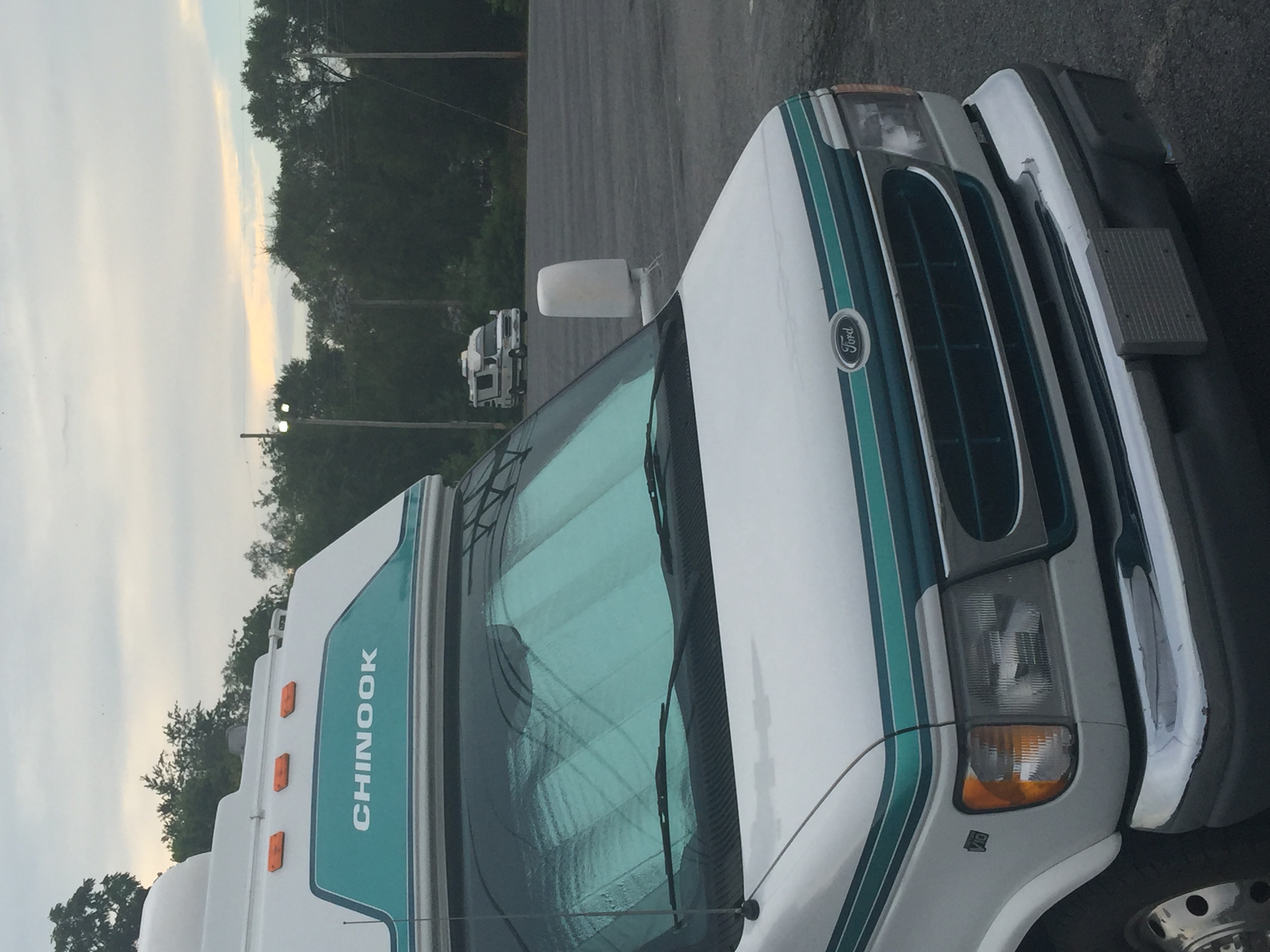

Stopped at the casino in Charles Town,WV. And low and behold another Chinook was parked in the same parking lot. He has a 2000 Concourse with all sorts of modifications to enhance his dry camping. Also, he's the original owner and it's a diesel. He can't remember the last time he used shore power. Engine just turned 190k. I hope he joins the forum to provide some input.

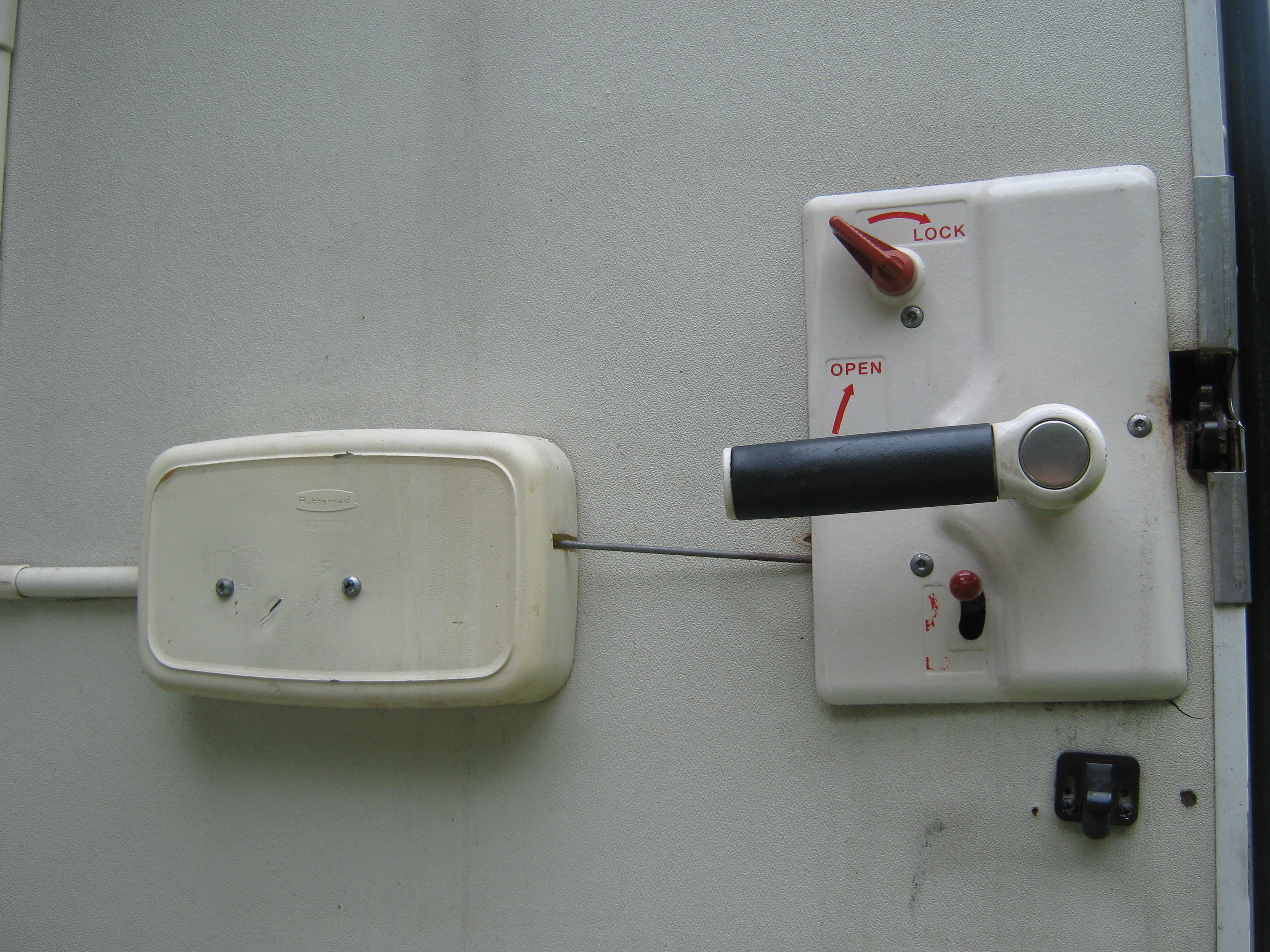

Gary was correct, I just turned over 190K mi. on my single-owner 2000 diesel Concourse. It has been to all 4 corners of the country and most everywhere in between. I bought it new in 2000.
The remote entry unit I used was from Bulldog security, and, yes, it is a special hook-up. I used a Bulldog Security door lock/unlock module on the rear door to mechanically activate the lock. I ran the 2 conductor cable from the rear door to a point under the dash on the passenger side where the connections for the front doors were made. I also wired in a 'hidden' switch which unlocks the rear door. I've never been 'locked out'. The wiring for this came directly from the Bulldog instruction booklet with a special hook-up for the hidden switch.

Gary was correct, I have 190K mi. on my single-owner 2000 Concourse. It has been to all 4 corners of the contiguous 48 states and most everywhere in between.
The remote entry system I use is from Bulldog Security and I wired in a door lock/unlock motor (also from Bulldog) to the rear door lock. I also added a 'hidden' switch to unlock the rear door. I've never been "locked out".

Gary was correct. I have a 2000 single-owner diesel Concourse that just flipped over 190K mi. It has been to all 4 corners of the lower 48 and most everywhere in between.
The lock/unlock module I use is made by Bulldog Security and has 4 buttons on the remote. The 4th is for programming, but, the others are for lock all, unlock front, and unlock rear. I mechanically connected the rear door lock to a Bulldog motor and wired it to the module which is under the dash on the passenger's side where the front door wiring appears. I also added a 'hidden' switch to unlock the rear door so that I can never lock myself out. I have too much time on my hands.
