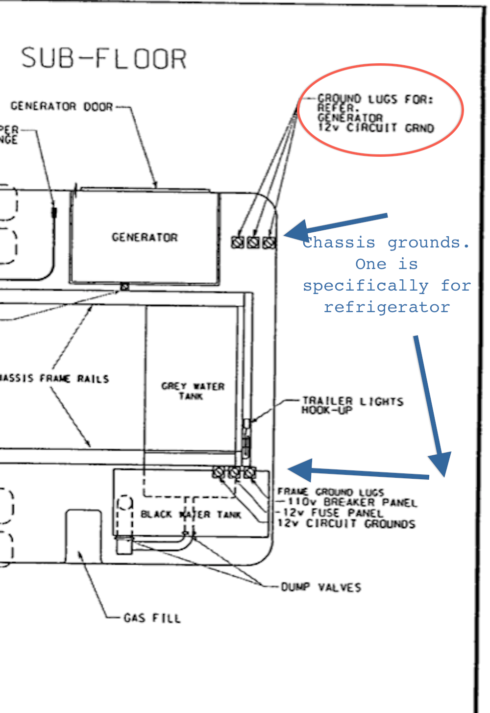

7) Never hurts to check grounds. Have you cleaned up the chassis ground for the refrigerator? It will be a screw/connector attached to the frame (go under the Chinook) back behind the generator. Here is a diagram: (There are three more on the other side for other DC functions - they can get dirty/corroded and then not make a good connection.)
(Click on to enlarge)
