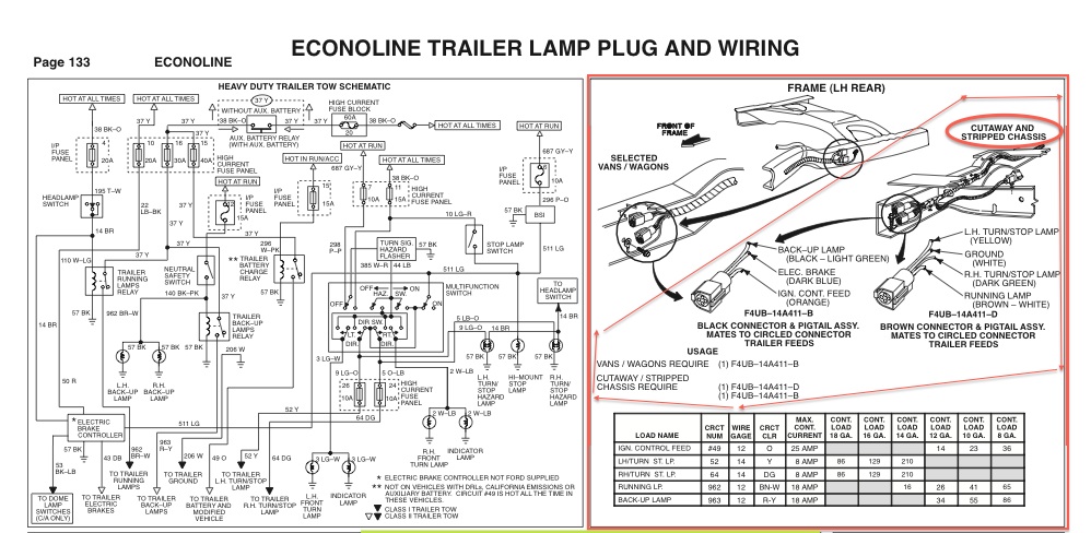

1) Chinook didn't use the usual Ford wiring to power the taillights. Instead, they took the "cutaway and stripped chassis" trailer light wiring (two wiring connectors provided by Ford) and used one of them (the one that powers the basic trailer functions vs. the "extra" ones) to power the taillights and the marker lights. But wait, there's more...
So, I knew that Chinook had used this "schnozzle" (as I call it because the Ford end connection sort of looks like a periscope) to wire the taillights, because when I got my rig I wired in a new trailer lights connector. For one thing, I like a 7-way style plug (even if not using 7 ways), and for two, I needed one of the additional wires (the reverse light one, to power my trailer's surge brake lockout solenoid). So okay, I crawled under to disconnect the original four-way trailer connector. I had the Ford "camper wiring kit" drawing, so I knew what I was looking for (where the four-way joined the schnozzle). But wait, what are these OTHER wires attached to the trailer wiring schnozzle? And they go up into the Chinook floor...?!?
Long story shorter, yep, Chinook used those wires to power the Ford taillights. Good to know, since it's unconventional. I tucked that away for future reference and finished my trailer wiring job. Trailered many miles with no problems, until...

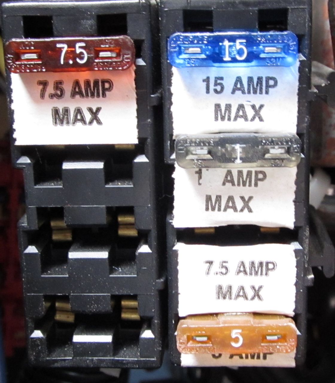

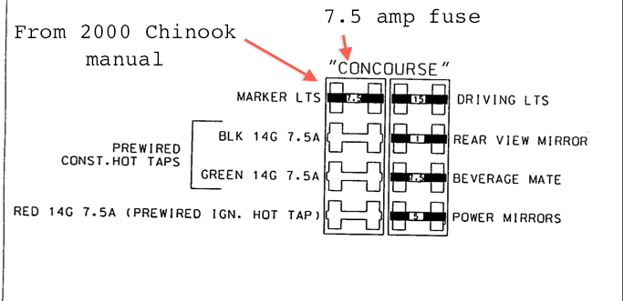

Here are some supporting documents:
Excerpt From Ford's extra wiring document, showing the cutaway and stripped chassis wiring "schnozzles." Chinook used the brown one to (also) power its Ford taillights and body marker lights via the fuse shown in next attachments.
Drawing from 2000 Chinook manual depicting their added fuse block by driver's left shin. This drawing is for the Concourse. Premier has only one row but marker lights fuse is also the top one, also 7.5 amps (according to adjacent drawing in manual).
Photo of actual fuse block in 1999 Concourse. "Missing" fuse previously powered the black/grey tank "auto drains" (shudder!).

Our wiring does vary,the photo you post shows 2 rows of chinook added fuses under the steering column,my 2001 has a single row,your photo shows separate fused circuits for marker/driving lights,on my rig these are combined to a single fuse,at the top circuit position.Cant say,but I guess these circuits are powered like mine from the 30 amp fuse in position 14,at the power distribution box under the hood.I do know that in regard to the faulty relay C ,I believe the manual listed it as controlling backup and Towing lights.but I want to check that next time I head to my rig.rooney

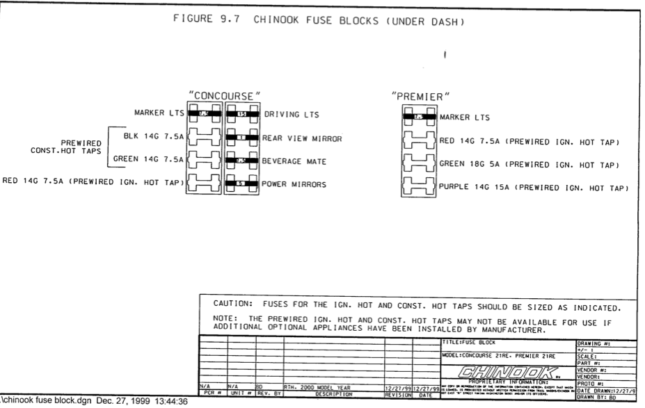

Rooney,
I think it got a bit buried in my post, but what you describe vis-a-vis the two-row vs. one-row added fuse blocks is the "usual" difference between a Premier and a Concourse. So not necessarily a year thing, but more of a model thing. In my original post, I edited the drawing from the 2000 manual so the Concourse part might appear larger, and only made note in the text about the Premier difference (since OP has a Concourse).
Here are both of the diagrams, which are side by side in the manual (2000 manual in this case since I had it handy). My 1999 Concourse is as this manual describes also, as it happens.

Thanks,I did not recall seeing that diagram,strange since there are plenty of empty fuse slots in even the premier that they did not separate the running and marker lights there as well,which seems like it would give you a greater degree of safety.Still if your wanted to verify if the green 30 amp fuse in the power distribution box under the hood at position 14 was controlling these circuits on the rig in question seems fairly simple to pull it.and see if you have backup/running/marker lights/.?my guess would be between 2000 and 2003 (production chassis years)they are consistent but I am just guessing.Rooney
