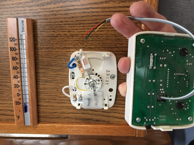

Feeling pleased with myself I then moved on to the thermostat. I mean, how hard can it be? Just two wires to form a loop with the blue leads to the furnace relay. First step was to expose the furnace and confirm the relay wiring to thermostat. No luck as it quickly runs out of sight then quite a distance behind carpeted panels.
The other exposed end at the thermostat is not helpful either as it is an ambiguous 4-wire RJ11 telephone jack with flimsy 24 gauge wires. Hardly sufficient gauge for 0.7 amp needed over 15’ to the furnace relay. These ran to a logic board in the old digital Comfort Center controller and from there up to another board in the discarded air conditioner.
I tried to trace the telephone wire back from the thermostat to hopefully discover the heavier blue wires from the furnace - to no avail. I merely confirmed after laborious disassembly of the overhead bin flooring the wires disappear along with other circuits and snake into the wall and ceiling space. Of course I looked at my Chinook owners manual for guidance but it had no wiring schematic for thermostat to furnace.
So my next idea is to run the new wiring across the forward overhead bin and find a neat path to tuck out of the way down to the furnace. Perhaps I should test the circuit first before getting too deeply committed. Surely inspiration will come after the therapy of exposing my travails in public and a senior's nap.

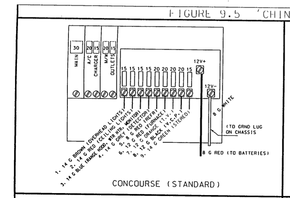

I can tell you where the furnace wiring is on my '99.
Starting at the "brown box," the furnace has its own DC power wire/fuse. I have in my notes on the original wiring "#6) 20 amp -- 12 gauge red - furnace." I don't believe this wire serves anything else.
This is corroborated in the 2000 manual, here is an excerpt. Note the #6 fuse position. BTW, the model "with Nu Heat" has the same wiring on position #6.

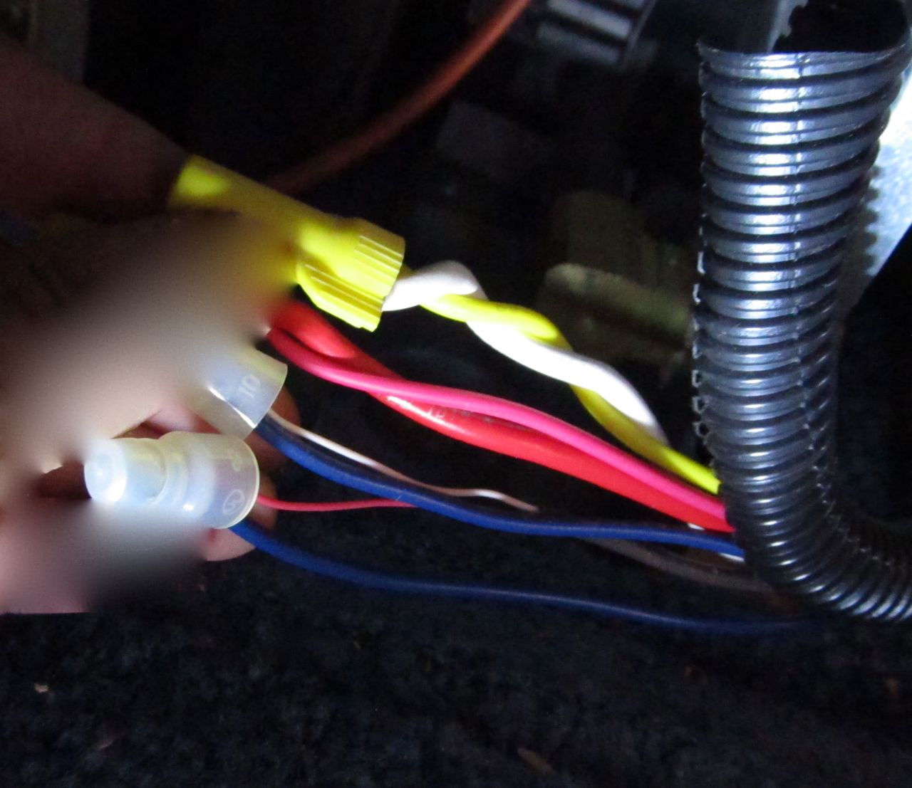

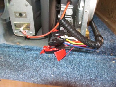

I'm going to look in my photos from when I took out the furnace to see what color the wire is when it gets around to the furnace. BTW, there is a yellow wire in that same area that goes into the floor. I am 99.9% certain that feeds the propane gauge (signal goes to monitor panel).
Here are a couple of photos of the wiring at the furnace end. First one is before I disconnected anything. Second one is after but gives more of a big picture. The power wire is still the red 12-gauge wire.
And yes, that red wire goes through the channel that's up in the roof/wall junction area behind the long cabinet.
The path of the "phone cord" is through the roof on a diagonal over to the area in the overcab behind the solar controller, then across the overcab ceiling (right behind the face panel in the open), then through the wall chase and into the cabinet with the Comfort Control.
Does this combination of information help you with the thermostat wiring?

Thanks Blue~Go - most helpful. It is sound policy to take pictures BEFORE pulling stuff apart. Yes, #6 is the 20A furnace fuse I removed before starting work.
I have progressed by mounting the new thermostat and running a 16 gauge wire pair, neatly tucked and routed up and over inside the forward bin then down to the furnace, completely bypassing that circuitous and now useless “phone wire.” Some drilling was required in the name of expedience - a 5/16” hole in the bin wall behind the driver. The wire pair is out of sight there in that little nook.
This is from the Suburban NT-16SE Installation Manual:
“Connect the thermostat wires to the blue wires on the right side of the furnace. If your furnace is equipped with a thermostat that has an adjustable anticipator, the anticipator should be set at .7 amps.”
Tomorrow I plan to finish the connection to the blue pair shown in your middle attachment and disconnect that spliced red / white phone wire. Then we shall apply ze voltage and see if she comes alive!

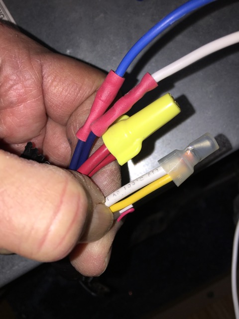

It’s ALIVE! The furnace fired right up after completion of the wiring job. It took 20’ of wire to cross over from thermostat to furnace. I used 16 gauge blue and white primary wires. The first attachment the new analog thermostat terminating my new blue / white pair mounted on the bin with the back of the removed digital Comfort Control for reference. The other phone wire pair must be to power this unit. Ignore the wire colors in the picture as this was just a test piece used for illustration purposes. The original is now tucked out of the way under the bin floor.
The second attachment shows the splices I made to the blue furnace wires. The red and white phone wires were cut off and can be seen just above my thumb in the furnace bay. I've learned my lesson not to assume these jobs are simple plug and play. The Chinook wiring is so well routed only major gutting of the interior could expose it all. I wasn’t about to go that route.
Brief Recap:
* Remove air conditioner = open circuit to controller, hence furnace becomes inoperative
* For heat only a simple two-wire analog thermostat is sufficient
* For proper burner on/off duty cycle the anticipator setting is 0.7 amps
* The wires must not be too thin (e.g. 24 gauge phone wire) as voltage drop then becomes an issue
Now for road trip without fearing the cold. I should end with another pithy quote: “Problems that remain persistently insoluble should always be suspected as questions asked in the wrong way”
