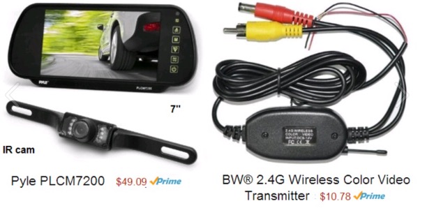

Two years ago I bought something similar to Colorider, plus wireless trans/recvrs are dirt cheap these days, too.
viewtopic.php?f=8&t=48&hilit=camera&start=0

As I recall, I had to buy an extension cord for the cam. I ordered it at the same time for a couple of bucks. The RCA wire (the video one) had an interesting feature that came with it. It had an extra red wire coming out of either end, probably used as a sensing wire for an alternate wiring plan. It was tiny, but the camera uses such a small amount of juice, I was able to make that work as the camera power wire, meaning I didn't have to run an additional wire to the front. I'm sure that makes no sense, but when you see the wires it comes with, you'll figure it out.

Oooo. Thanks for the memory jog.
Like you, I ordered an extension video cable in case the wireless didn't work, and it had that extra wire. Like you, I figured I could use it to power the camera from the overhead cab switch I installed for my mirror-LCD-display.
As it turned out, the wireless worked fine hooked up to the backup lights, so I have not installed the extension wire.
However, I've often thought of changing the wireless transmitter to be connected to the running lights instead of the backup lights. That way I could just use those to turn it on all the time.
