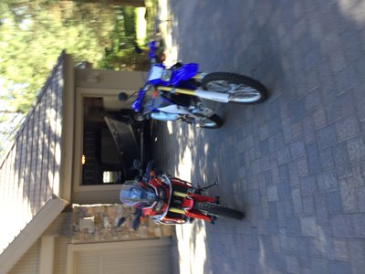

I wanted something that could cary a 600 Lb motorcycle

At 600 lbs, you're better off towing a trailer since you're either pushing or exceeding the rear axle weight. I tow a Kendon 3 rail trailer with 3 dirt bikes behind my premier. Maybe some day I'll tow my street bike too (big touring bike), but I'm not old enough to trailer it yet.

Re: Motorcycle & Motorcycle Carrier
My Africa twin weight is 530 lbs. I have a glacier 2500. I hope it's not too much weight for the class 4 hitch
