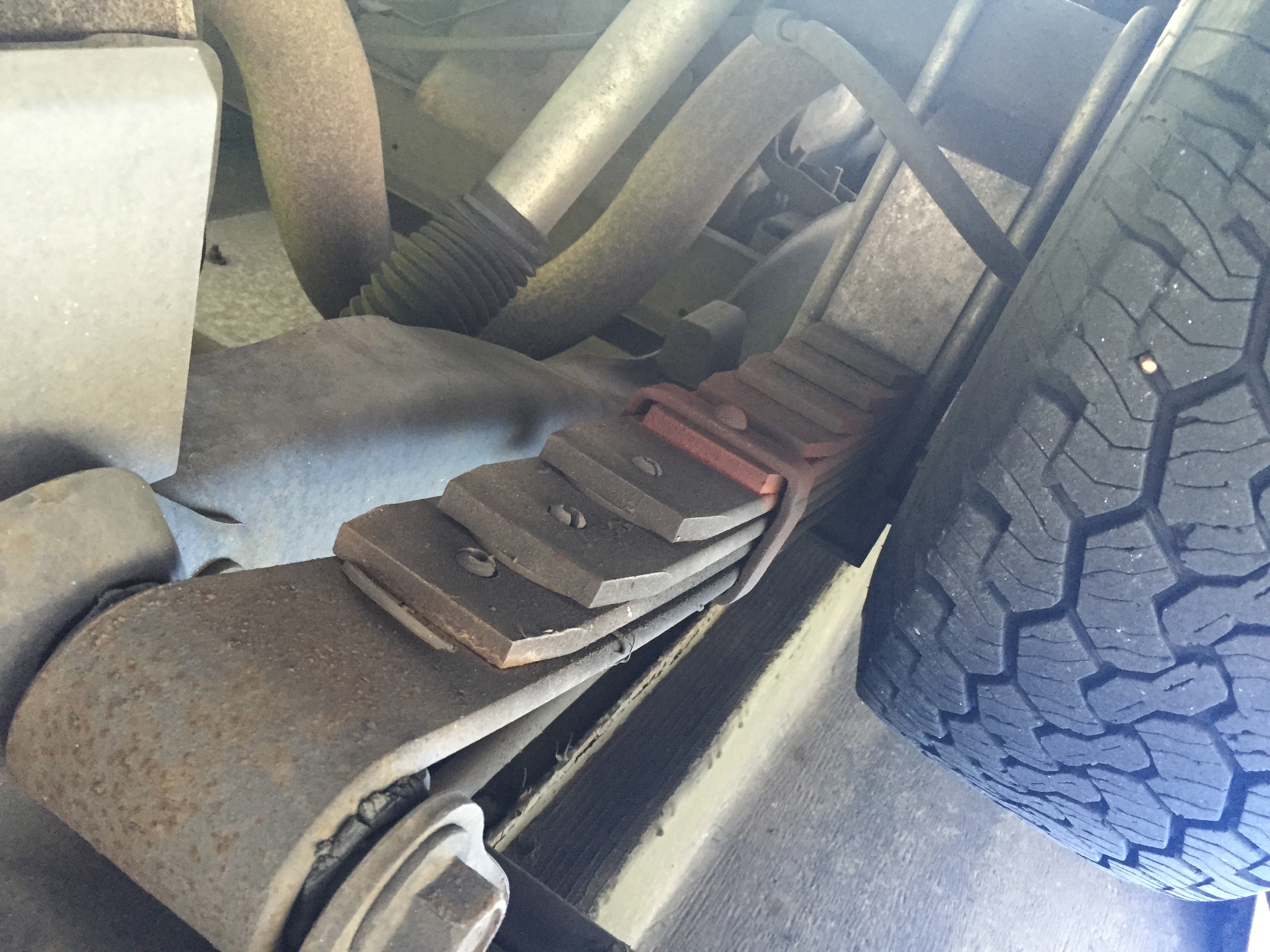

Mine is still the stock chinook spring with a 3" block to raise it. I keep forgetting to take a pic though.

I will probably have a spring shop pull a few leaves out when everything is back together.

Anyway.. Finally got some pics of my rear springs. Looks like I have 9 leaves. Your rig looks higher in the back than mine. Oddly though, my spacers look taller than yours. I guess your springs are just that much stiffer.
