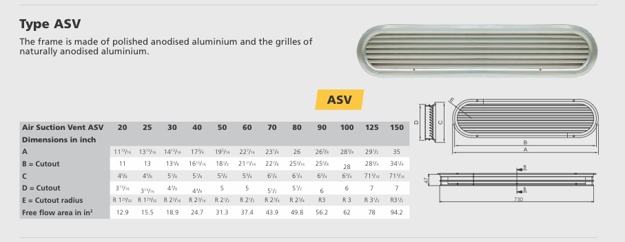

Some examples below. Once nice thing is that they always list the ventilation area, so if you are wanting to calculate (for example, I think the BD35 wants 25 square inches) you can do so. One thing that I'm not sure of though, is how one compares relatively passive area to intake area when you have a marked chimney effect. I would think the latter would require less intake area (in fact sometimes it's critical - my former woodstove worked perfectly with a 6" chimney; an 8" chimney would have *reduced* the draft and made it work less well).
Vetus ASV louvered vent and DBOX dorade box

Since the planned placement of my refrigerator would make it impossible to have any sort of inner dorade or pipe where the current lower vent is (because the refrigerator will be right up against the outside wall, essentially), I have thought about either a different lower venting (intake) scheme, or.... do I really need/want exterior venting?
Taking the latter first, no, I don't need exterior venting. I have been running my "portable" CF-50 (same BD35 compressor, albeit smaller box) indoors for over two years now, and it runs just fine. Granted, if it's 95ºF in the living room, the compressor is adding unwelcome heat to my already warm living space. But on the other hand if it's 40ºF outside, it's.... adding welcome heat to my living space. So that may be a horse apiece. On the other hand, I can hear the compressor fan (it's very quiet, but still audible to me in very quiet ambient situations). If the venting were completely exterior, I'd be able to isolate the sound, I believe.
But is that worth having two big holes in the Chinook shell? And/or the complication and space of a chimney even if those holes are well conceived and sealed? Not so sure about that. If I were in hot climates exclusively, I'd say yes for sure. Or if the world were so quiet that hearing the refrigerator compressor fan was a constant annoyance (I WISH the world were that quiet). (But also, apparently the stock fan can easily be replaced by a quieter/better one, so I'll be doing that in any case.)
Still, I don't like to not do something just because I haven't bothered to think of a good way. And I guess thinking about these things is my version of "counting sheep," so....
