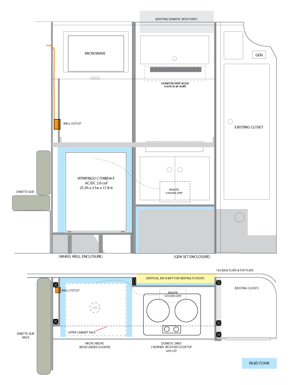

Somewhat related to this topic:
I have the Vitrifrigo C75 AC/DC with external compressor. I will be installing the fridge where the old stove location was (above the wheel well enclosure). Then locate the remote compressor unit on top of the generator enclosure box (originally the bottom platform for the old Dometic). BTW: I have removed the old carpeting and pad form the gen box and installed Dynamat. I am also retaining the "air chimney" for ventilation, using the outside access door for fresh air intake and the roof vent for exhaust.
My question, is there a way to improve the design of that access door which is so prone to leaking? After a rain, there is always a little puddle of water on top of the gen box. Roof vent is not leaking. Is the problem inherent with the 3 vents, the seal between the door frame and body or the door seal itself? Any remedy will still need an "air intake" in that location.

Blue~Go wrote:And now you've re-kindled my desire to put the compressor up by the ceiling. It would intake warmer air there (vs. the cool floor) but maybe not that much warmer. OTOH, where it would be an annoying challenge, is in constructing the cabinet and getting it up there. Reason is that the copper line to the refrigerator box is not detachable, but of course who wants it dangling at the front of the cabinet. Of course it can be figured out.
Installing my new fridge in the old stove location necessitated a small "access hole" be cut in the lower portion of the original forward vertical fridge wall, which is now a somewhat modified reinforced septum/support wall in my remodel. This access allows just enough clearance to slide the remote compressor in and set on top of the gen-set box by the lower outside access door vents. A cover panel for the access hole will be screwed in place and have proper grommets for the supply lines. Service for the remote cooling unit is by way of the OEM outside vent door or inside via the new stove top lower cabinet back panel. This remote compressor location offers quiet operation and allows for a "natural convection" ...fresh ambient air intake and exhaust air rising/exiting thru the air shaft/roof top vent.
...in theory...?
The plan...
