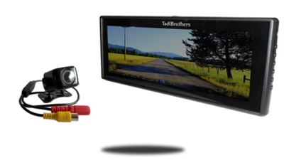

I decided to take the plunge into this endeavor as well. With my on-going rig remodeling project, the interior rear entry and fridge side of the galley have been basically gutted for new cabinet work, etc. This will give me the opportunity to run video/camera cable along the passenger side of the rig. After researching several install ideas, I determined I wanted:
• a "hard-wired" system (not wireless)
• full time rear view (not just for backup)
• at least a 9" wide color monitor to be placed where the mirror is now
A Tadi Brothers system (http://www.tadibrothers.com/catalog/bac ... kup-camera)
seems to address all my wants:
• 9" Mirror with 170° Backup Camera SKU93228
• Color
• Clips over existing mirror
• On while driving or in reverse (Mirrored Image)
It would appear I can tap into the existing rear view mirror power wire and use the "powered video cables" to feed the camera. Seems easy peasy enough (?).
• Color

That looks sleek. Isn't it nice how easy it is to access wiring (and other things) when you simply remove the walls?
For me I think I want to retain the functionality of the rear view mirror. It's sort of ironic, because for years I have driven larger vehicles with only side mirrors, and in those the rear view mirror was basically useless. I'm completely used to driving without it.
But.... I've grown to like it in the Chinook! First of all, I like the temperature readout (although my compass doesn't work, darnit). And second, after I added one of those "prismatic" lense dealies to the rear door, it's actually amazingly useful (I never would have imagined). And I use it to look into the back to see what just made that falling noise.... Plus it's a backup if the (planned future) rear view camera ever fails.
(Also the prismatic lens dealie is nice at campgrounds, because I can see "to the sides" if I want to know if someone is approaching, etc. - not a big thing, but handy.) (I always kind of secretly laughed at people who had those, since I didn't "need" one because I know how to drive with side mirrors - now I have one and like it )
OTOH, I can see how that would be nice and clean, with no "extra" monitor hanging around in the cab. Cluttered cab... ugh.
I've procrastinated on this long enough that the "wireless" systems are almost starting to seem like they have matured enough to be useful. OTOH, running a wire is not that hard, and then you know you're good.
I hope you'll post as you go -- maybe I'll get inspired and finally install one myself!

As per my previous post on this topic, my hard-wired camera system installation includes a TadiBrothers rear-view mirror/monitor that clips onto the OEM mirror. The new mirror monitor will be for full-time rear viewing and not connected to reverse lamp switching.
The existing stock Ford mirror has LED temp/compass readouts. I've searched the internet for wiring diagrams for that mirror with no success.
I would like the new mirror/monitor to power off-on like the OEM mirror (ignition activated?).
Has anyone tapped into the OEM mirror for 12v (+,-)?
2001 Concourse Ford E350

Leaving the stock mirror wiring alone, I've decided to hardwire the TadiBrothers mirror monitor directly to the auxiliary fuse panel for a direct 12v ignition switchable power source using a blade fuse tap. Fishing a 2-wire (+,-) from the fuse block up the drivers side pillar and under the headliner to the mirror location should work. I'm guessing a run of less than 10 feet.
What gauge wire is recommended for this type of hookup? Haven't been able to find an amp draw rating for the monitor/camera. It can't be much. Will 16 gauge work?
And which fuse can I piggy-back onto without problems?
The "beverage-mate" is gone, so that's an empty slot ...but was saving that for an additional 12v/USB auxiliary port on the console.
Again, this setup is full-time rearview monitoring.
Thanks,
HoosierB The Electrically Challenged
Thanks,

Just curious, but don't you have the pre-wired ignition or hot taps on that fuse block already? I thought that was standard on Concourses, and it's shown in the manual. Here's the page from the 2000 manual:
As far as wire/fusing, 16AWG (presuming 105ºC rated wire) can be fused to 25 amps if not bundled or not in an engine space. Presuming you only have the camera on that circuit, I'd probably fuse it lower. You may even be able to fuse it really low and cover the camera as well (say if the camera says to use a 5 amp fuse; rather than the main larger fuse and then an inline fuse you could just fuse the whole circuit to 5 amps).
I bet the camera would not draw a whole lot (should be able to find out), so the pre-wired ignition hot tap in the lower left should work, it would seem.
