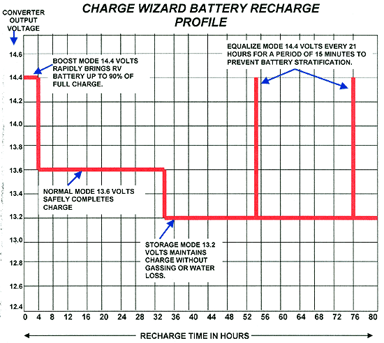

I read an internet thread where someone called Lifeline, and was told the PD charger was pretty optimal for their batteries.
I guess I see what you're saying about the voltage, but it still sounds to me like they're saying bulk mode is 14.4 up to 90% SOC, then it drops to 13.6 for what could be called absorption for hours, and then finally later on to the typical 13.2 float. Chart from PD:
PD charger voltage profile

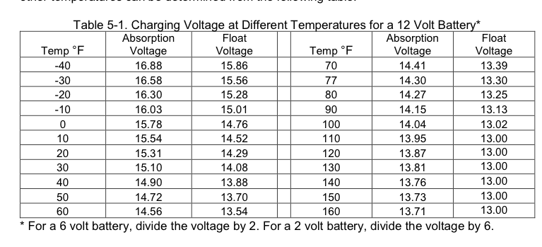

Yes the voltage outputs of the PD charger look very close to a match for what Lifeline calls for.... at 77ºF. That's the potential catch. If your batteries are at a temperature other than 77ºF, the voltages called for are different (higher when colder; lower when hotter). Especially with the batteries in an outside compartment, there could be some big temperature swings. Even for mine, which are inside under the couch, they are typically quite a bit colder than 77ºF in the morning hours, when the charging tends to occur (using solar).
As far as I know the PD charger does not have available temperature compensated charging, so it won't be "right on" unless the batteries are at 77ºF. When a charger does have temp comp functionality, it's just a matter of attaching a small ring terminal or sensor to the battery post or case (depending on the style). The the charger's built in temp comp function will add or subtract at a certain rate (usually adjustable to match the rate the batteries want) so that the voltage is the *equivalent* of those original voltage settings at whatever temps the batteries are actually at. This might be 13.7 (vs. 14.3) if they are hot, or 15.0 (vs. 14.3) if they are cold. Since tenths of a volt count, it's a fairly large difference.
That's not to say there's no place for the PD charger. To my mind it's just about knowing what given charger can and can't do, and then deciding how it fits your use case/philosophy/etc.
Here is a chart showing the effect of temperature on charging voltage requirements (to be equivalent to the suggested ones at 77ºF). This is from the Lifeline Battery Manual.
