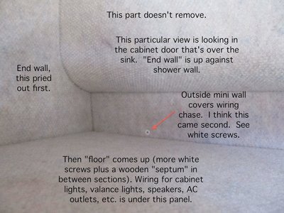

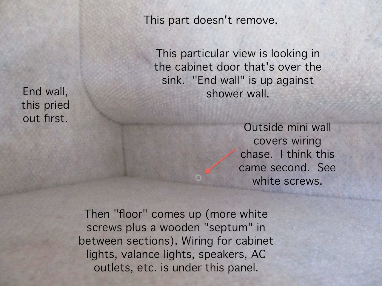

1996 might be different from my '99, but I can tell you how mine were wired. Now let me think back....
Okay so for starters, mine were on circuit #1 in the brown box, which was a 14-gauge brown wire. That I am sure of (for my rig).
The positive wires for the valance lights were also (still) brown. Basically the way my upper cabinets were constructed, they had some "false" areas that hid wiring. To get to those areas I first pried out the inner/end carpeted pieces. Then if I remember correctly the outer wall strips come out. The main fore-and-aft wiring chase is behind that. Then the bottom comes out and there is a bunch of wiring lying in there including positive feeds and the negative "bunches" (white wires). The lights had little "flag shaped" slide on connectors.
Let me see if I can dig up some photos and come back to post them.
Okay, so again, yours might not be the same (things seem to have standardized a little bit more starting in 1997), but here is a shot looking up into the overhead cabinet over my sink. Straight ahead is the outside wall, to the left is the end of the cabinet by the shower wall. Behind the mini vertical strip on the outboard wall is the main wiring chase. Under the false bottom is wiring for cabinet things. If you click on the image it should enlarge.

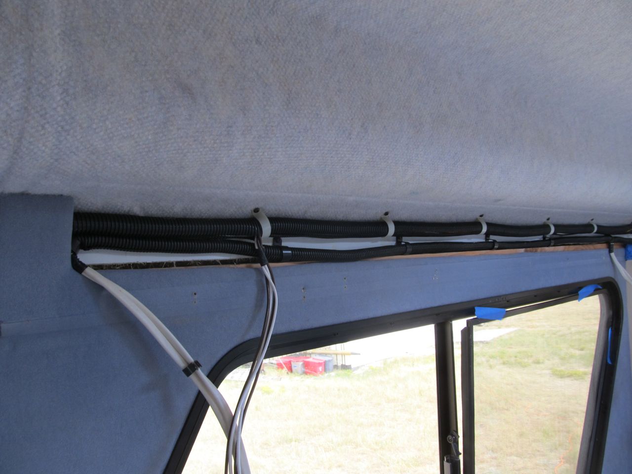

This example is from the other (passenger) side, with the upper cabinets removed. Here you can see the wiring "chase" that's behind that mini vertical strip exposed. The fatter bundle is DC wires; the thinner one is AC wires. The brown and white wires hanging down I'm pretty sure are the ones that powered the cabinet and valance lights. Brown is positive and white is ground. (As you can see by the blue tape, I had not perfected my "plastic straw" screen clips yet --- although you probably have different windows in 1996). Interestingly, on the driver's side all of the same wiring in the chase was not in loom. I added loom so now it is tidy like the passenger side. Maybe they ran out that day....?

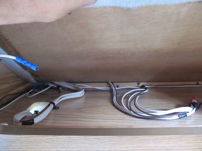

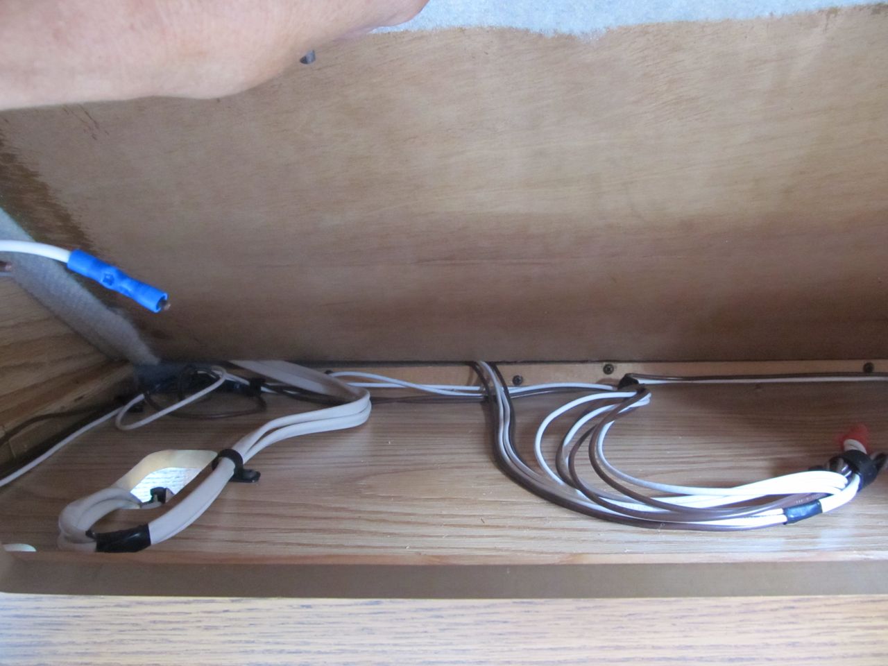

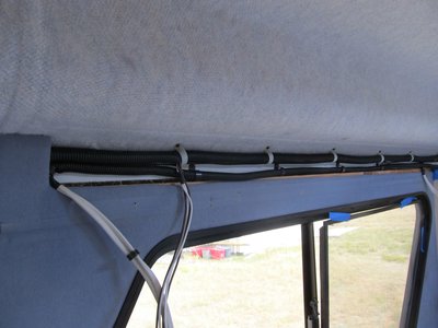

Here is an example (I think this is the passenger side again) of the wiring under the false floor of the upper cabinet. I think this is the same wiring that you see in the previous photo, but when it was in the cabinet.
