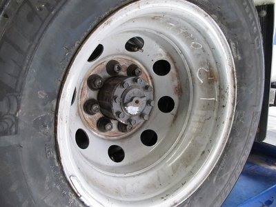

Attached is a pic of one of my tires. The stem extender holder has come loose from being attached to the underside of the lug nut. Been that way since I got it in March and I keep forgetting to address it. Today I went looking for a tire iron to loosen it up so I can slide it back under. Turns out I only have a standard iron onboard. Am I missing something or do I just need to purchase a larger diameter tire iron to remove it? The compartment I found the tire changing tools is located behind the spare tire.
The picture is not of the tire in question, but of how it's supposed to be attached.

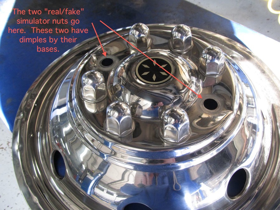

I was just looking for something else, and ran across these photos. They're from before I had the Tireman extenders put on.
This is one of the front simulators off - with holes where the two "real/fake" lug nuts are, and then the "fake/fake" ones still in place (which never come off, unless someone does something wrong).

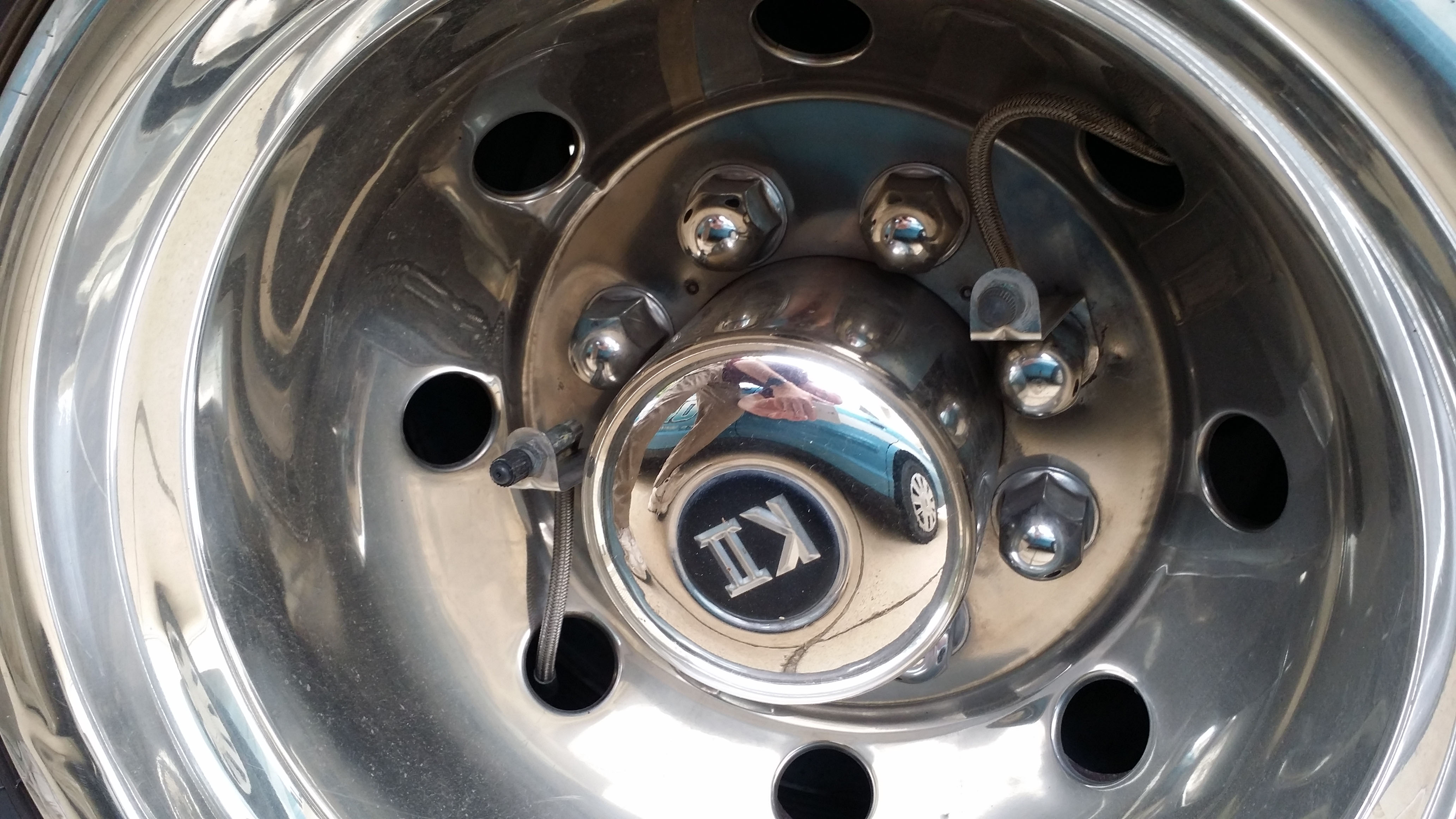

And the wheel and "real/real" Ford lug nuts underneath (rear this time).
What I can't remember at the moment is what goes on the Ford lug nuts to hold the simulator on via the two "real/fake" simulator nuts. Reason is that I just helped a buddy with his 2003 (which has little threaded inserts that go in via hex wrenches), and I can't remember if mine has those or some other arrangement. You sound like the type of person who will figure it out (but then I figure it's nice to have data in the thread for future/others too).
