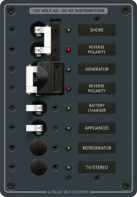

I didn't really need an automatic transfer switch (no auto-start generator or anything like that), so I went with a marine type AC panel that incorporated a manual source selector and the regular AC circuit breakers. The way it works is that there is a "main" double-pole breaker for each power source (in my case, generator and shore power) and then the breaker panel is made so only one can be switched on at a time. Hence you have to choose *either* generator or shore power on the panel. I like that it's completely simple, robust, and easily visible (of course so are separate cords/sockets).
Here (below) is a photo of the panel I chose:
You can pretty much see how it works: There is a black "lockout" slide that has to cover one of the sources in order for the other one to be flipped on. Simple and manual. The two main breakers in this case are 30 amp, as original. You can see they only have two of the regular breakers installed: You can of course add the other two, and they come in different amperages. They also supply a selection of labels. This is a typical way to handle the AC panel on a boat.
I don't think they make this exact one anymore, but you can still get panels that function similarly. This worked out well for my Chinook because there are two main sources, and four breakers, just like the brown box had. There are also fancy (and nice) rotary switches, but since you still need main breakers it's another thing to buy and takes more space/wire/etc. With this type of panel it's efficiently all in one. Marine breaker panels aren't the cheapest way to go though.
You may have a slightly different situation if you have three sources (i.e. shore charger, generator, and separate inverter that you want to power your same AC outlets). OTOH, an inverter/charger will just count as one source. I don't have either of those situations, as I only have a simple stand-alone inverter that has its own outlet, so that's on the DC side.

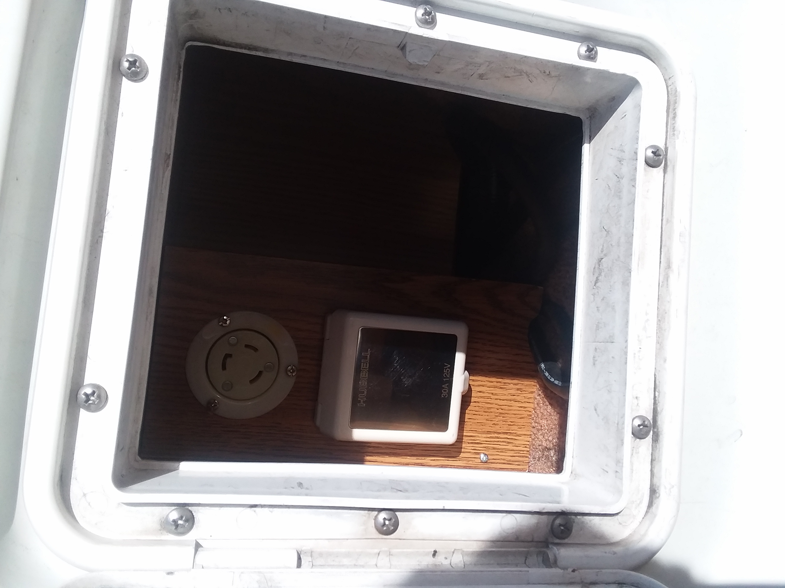

My Chinook has the old shore cord that attached permanently. I pulled the whole cord out and replaced it with stranded 3X10 cable. I added a twist lock adapter to the old cord. Here is what it look like inside the box. As you can see, I also added the generator outlet on top of that. I am looking for some kind of cap to cover the outlet, but don't know if such thing exists.
(Sorry if the picture is rotated.)
Edit: I will add a new floor to hide the cord on the carpeted area, but I have other things to do first.

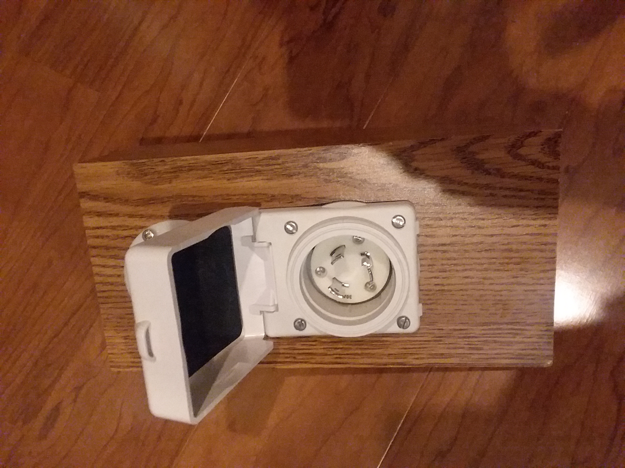

twist lock inlet installed on particle board for test fitting
installed twist lock inside the electric service box.  Notice the cut out on the bottom to fit the cords.
