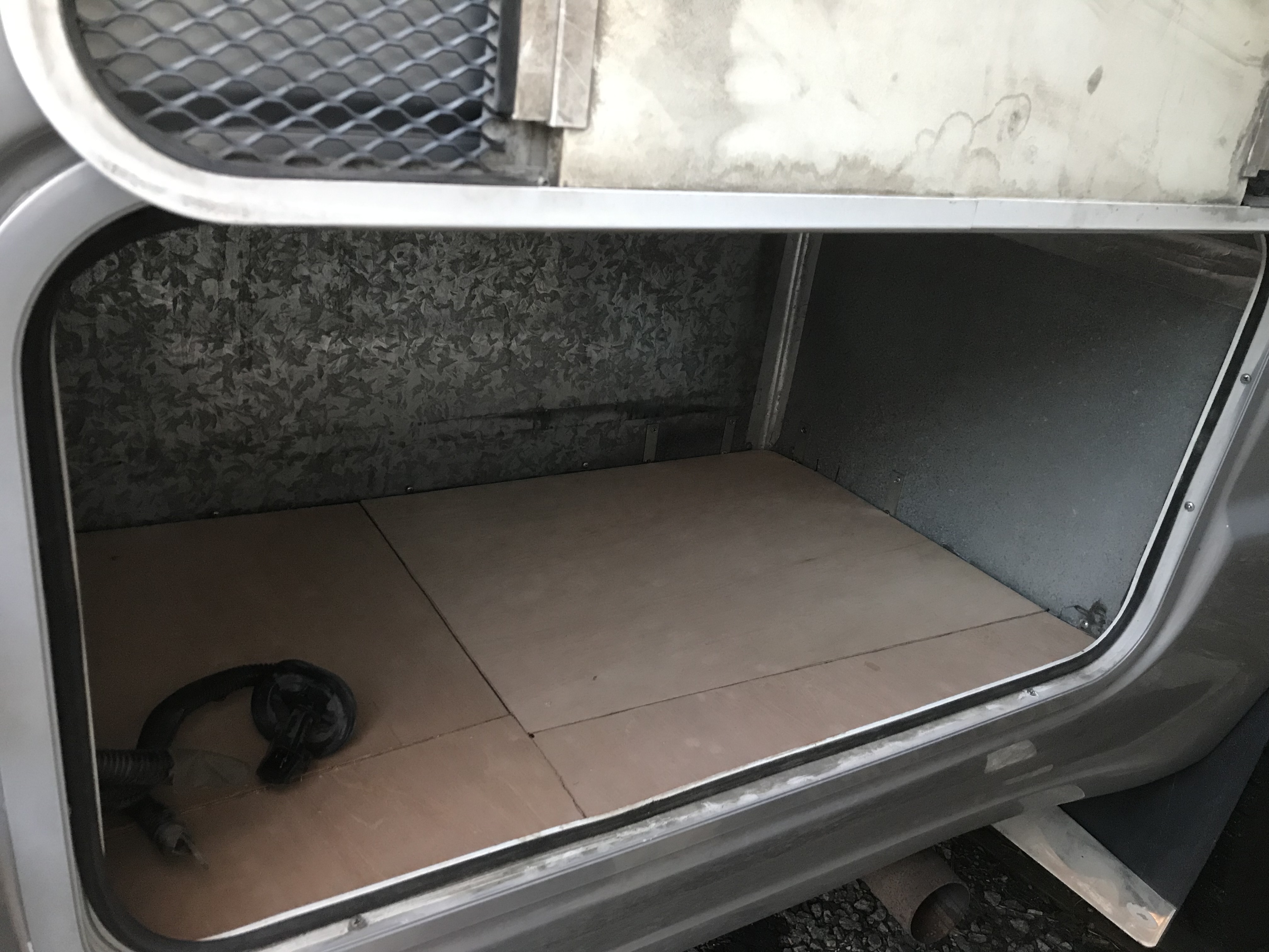

Last the storage pics...the removed generator storage

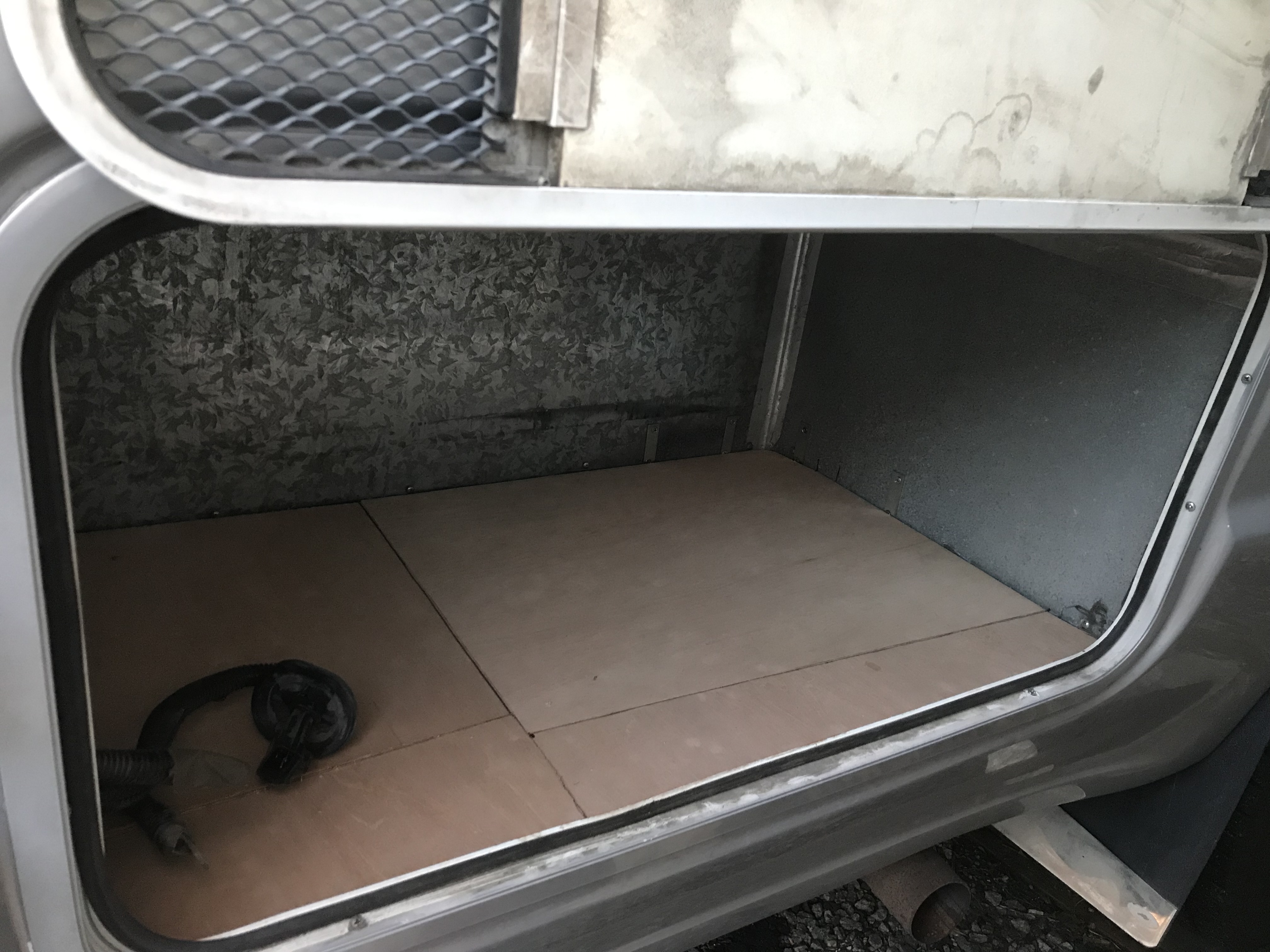

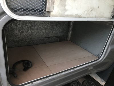

Blue-Go--regarding my pulling of the Genset. My rig is a 2004 Premier and the Genset was located on passenger side rear behind the back wheels (below the frig guts). It was a 4000 watt gas, not propane with a compartment door that is hinged at the top and swings upward. To remove it, I worked a sweet deal with my local RV repair place-They would remove the Genset, cap all lines and connections at no cost to me, in exchange for my giving them the Genset. It was in mint condition of course, since I never used it, and only ran it every couple of months for an hour or so to keep it in shape. Both of us were happy with the deal. So, I was left with an empty galvanized box that was well sealed on sides and top. The bottom was very solid, with a couple of holes for lines, and an open square about 10" by 10" in the back front corner. I dealt with the hole by attaching four "L" brackets (2 each side) to the sides of the compartment that would support the 1/2" marine ply flooring as it overlapped the hole. I laid the floor in four pieces (you can see the cuts in the pic), which made it easier to install--the box is NOT uniform, so template and careful cutting is necessary. When weather warms, I'll calk around the edges. And for additional weatherproofing of the compartment, I have templated and cut plexiglass to fit the two wire mesh openings on either side of the compartment door. I'll calk those in as well. I'm really happy about this new storage! So useful--bike gear, fly fishing waders, leveling blocks, extra water...with room to spare! We won't know what to do with all the room we will now have inside (particularly under the dinette, where we tend to put things that have no where else to go). Hope this helps...you should definitely do it!

Thanks for the info on the genset removal. Sounds like you have the exact same arrangement as me. Same location, same box. Onan 4000 gas generator. I have no idea why I have not removed that thing! Thanks for the encouragement. Clearly I need it! Or really what I need is a forklift

...and yes--trading the Genset for more storage (given how we use our Rigs) is well worth it. Can't remember if you have one or not, but the portable Honda Inverter generators (1000 or 2000 depending on need) are terrific...and oh so much more quiet than those onboard beasts. Coupled with a smart charger (I have the NOCO Genius 15000), its a great way to top off battery bank (or my Copenhagen Wheels) on a cloudy day in the middle of nowhere.
