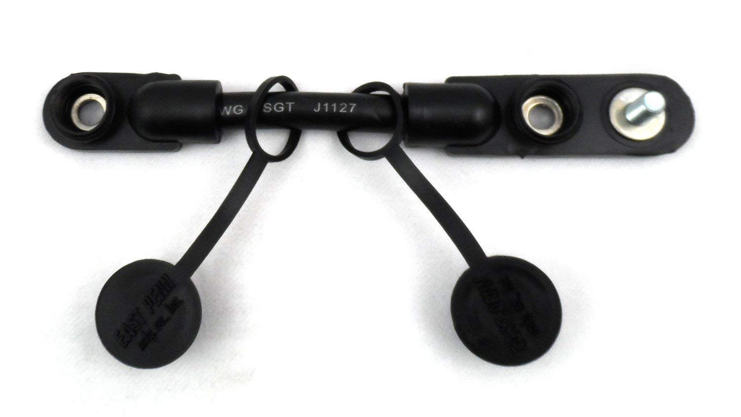

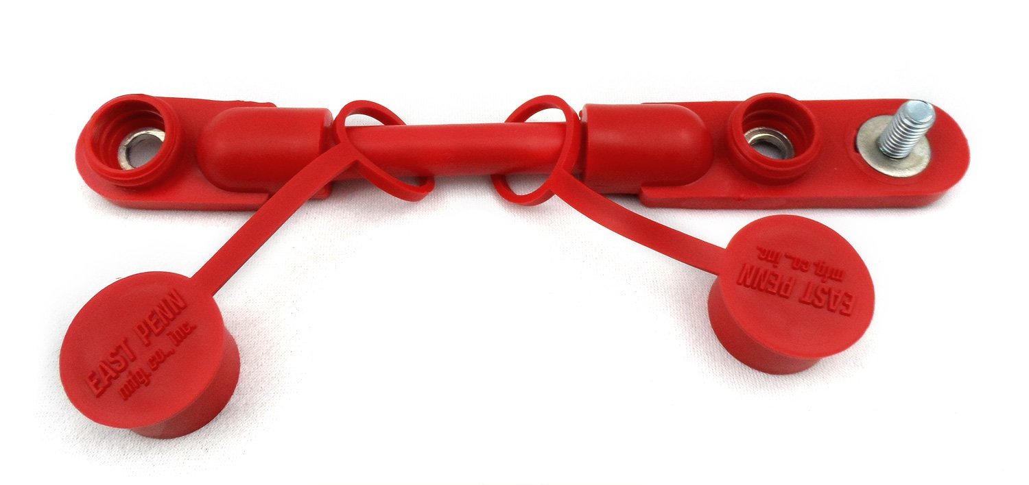

I prefer AGM bats (IMHO). Always worked for me, no problems. And worth the extra $. I installed these bat cables (Amazon) to tidy things up. Blue~Go will have excellent advice on all this for sure.
