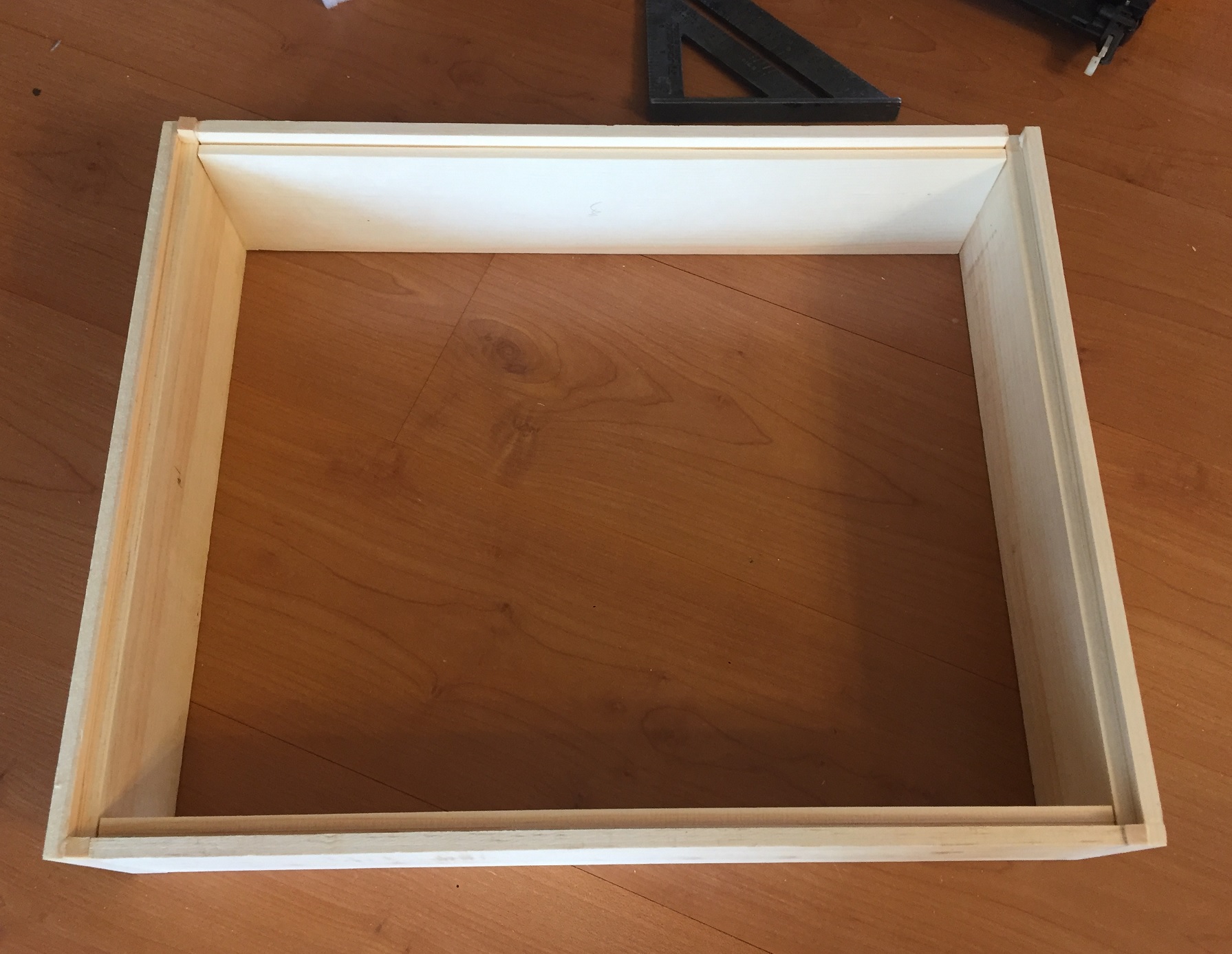

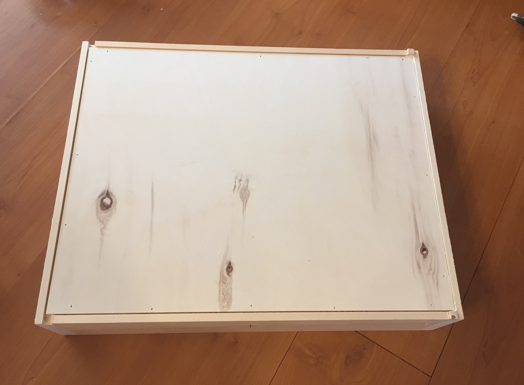

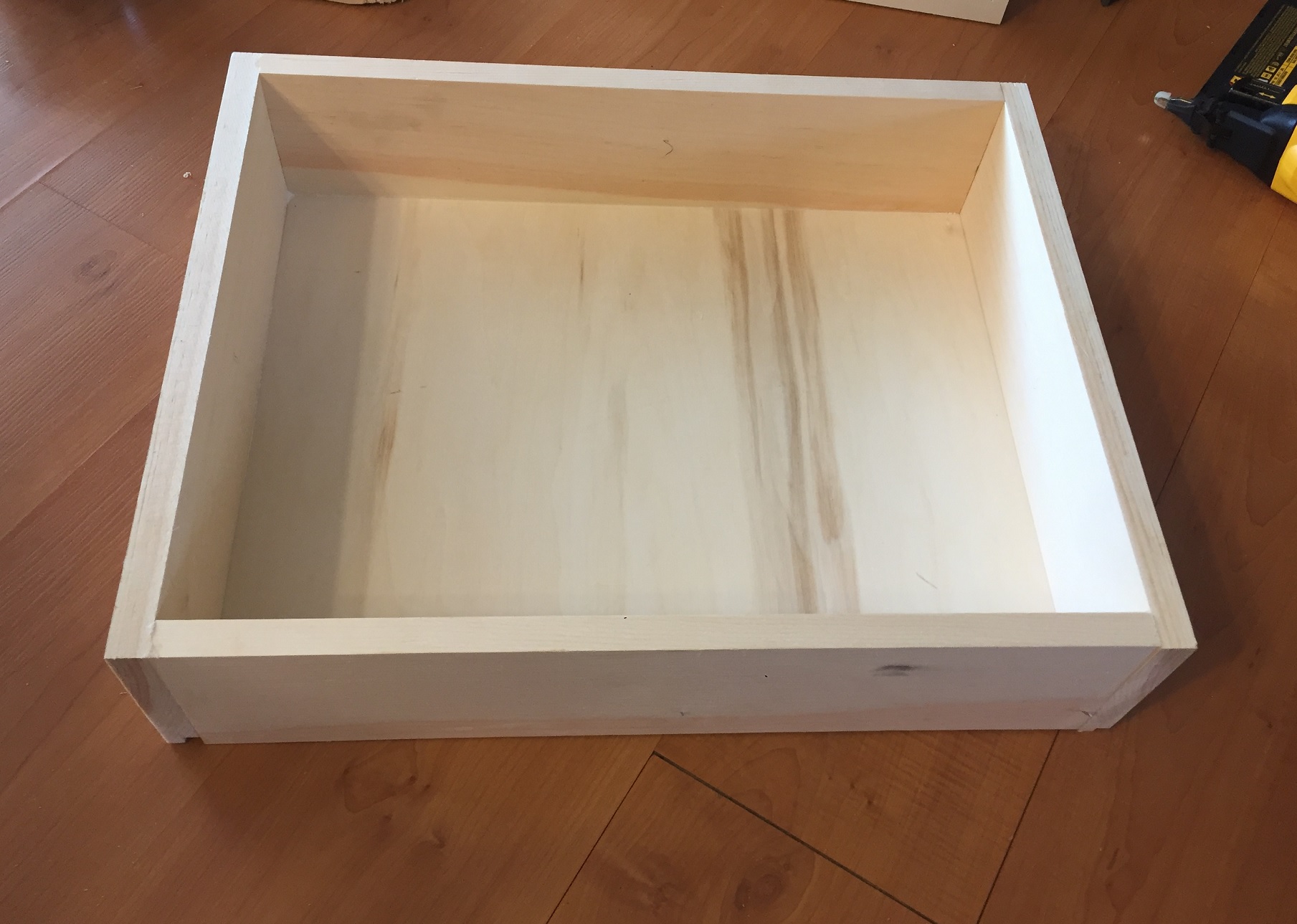

Alright! Cut all boards to length and then ran them through the table saw to cut the rabbeted edges to accept the plywood bases. Did the quicker and dirtier full cut which will create openings along the corners which needs to be filled with blocks to cover them. I glued them in and still need to trim and sand them off, they won't be noticeable when finished. Cut the leftover plywood I had to the right sizes and glued and nailed them in place. 1/4" ply is overkill and 1/8" would have been plenty but free is free.
I didn't spend time time cutting dovetail joints or doing anything "too" fancy, just simple butt joints and glue, just fast and simple but sill clean.

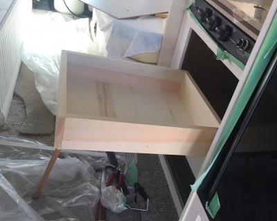

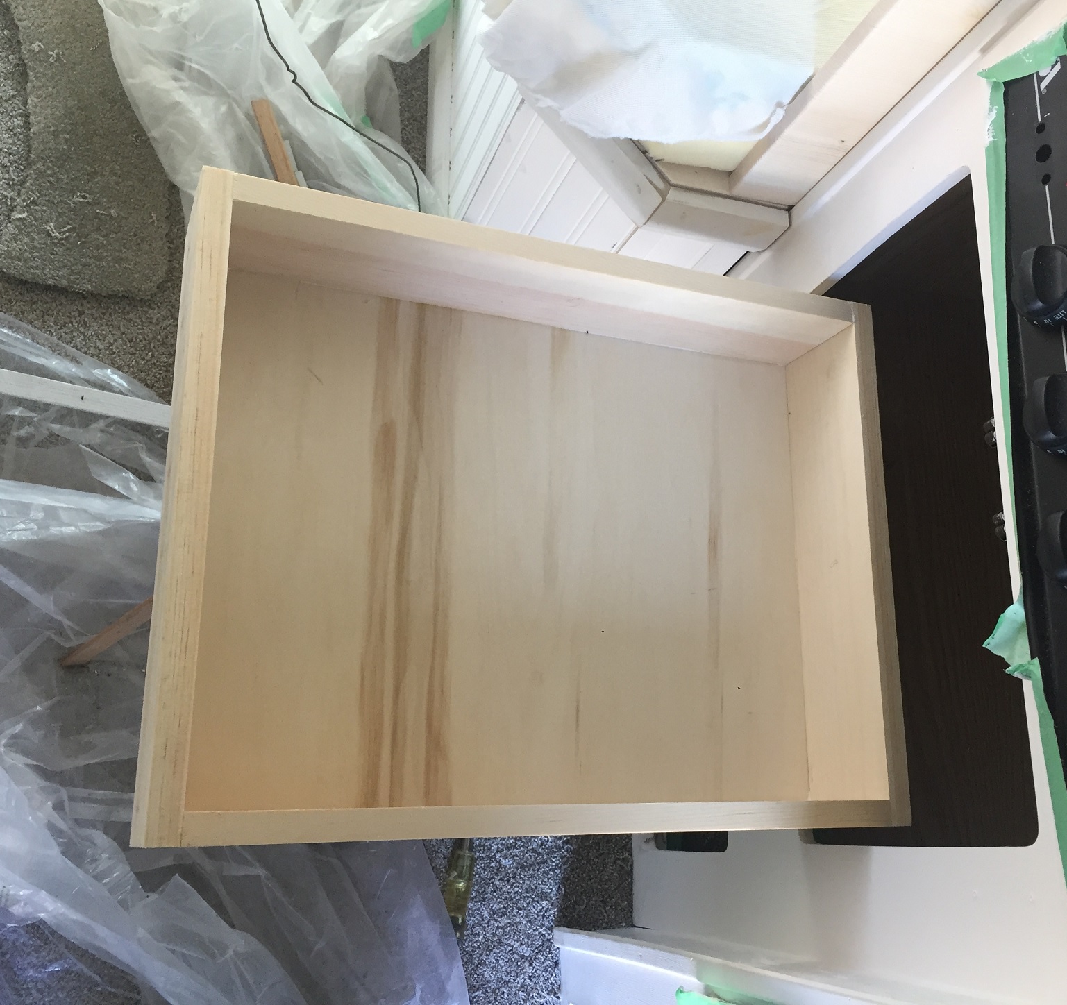

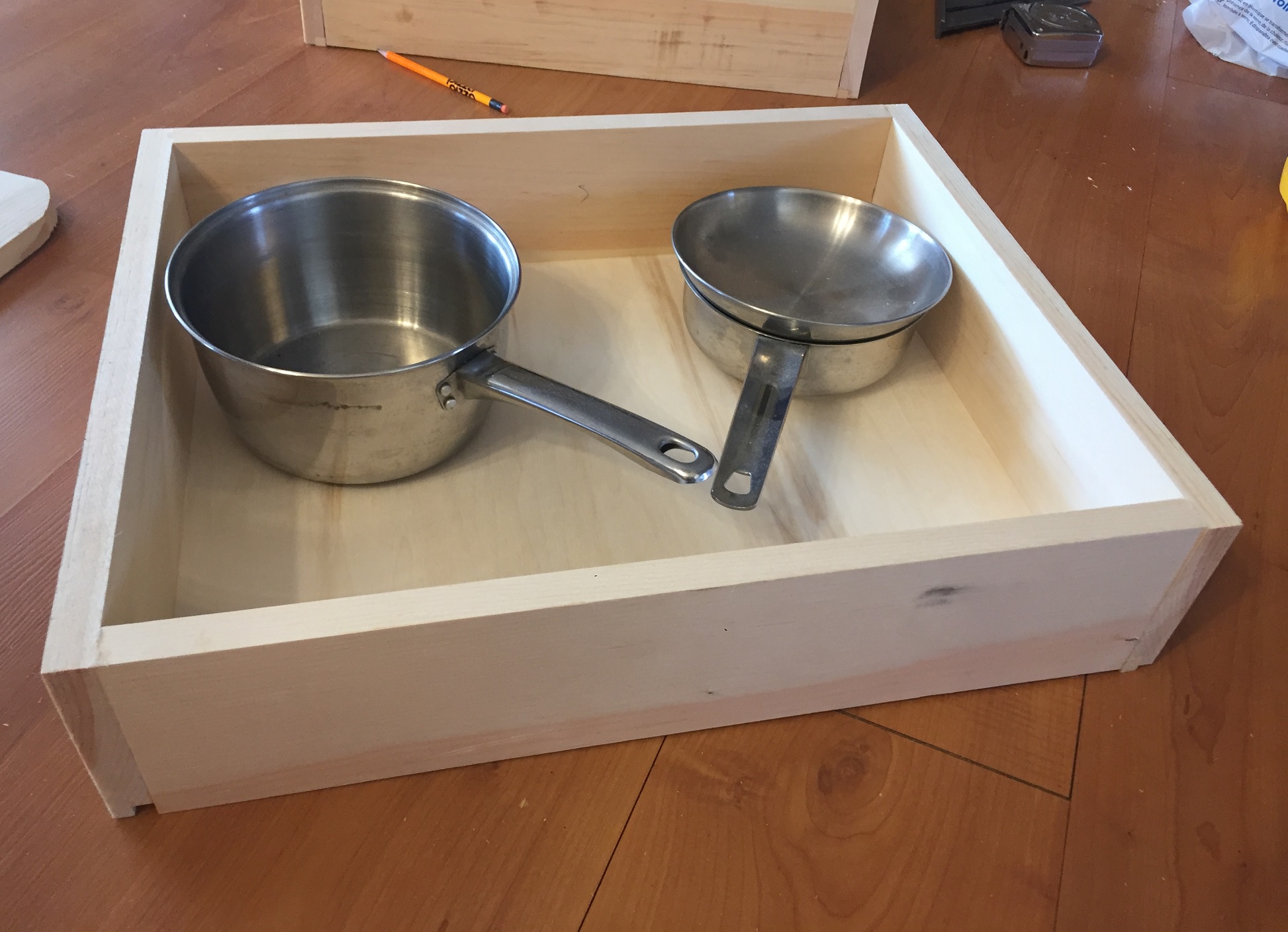

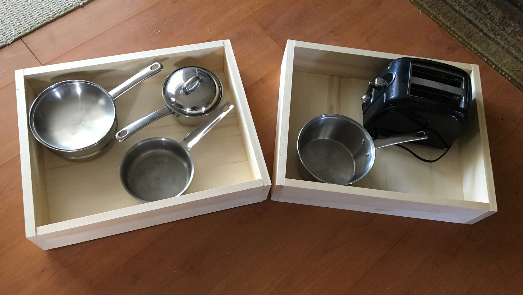

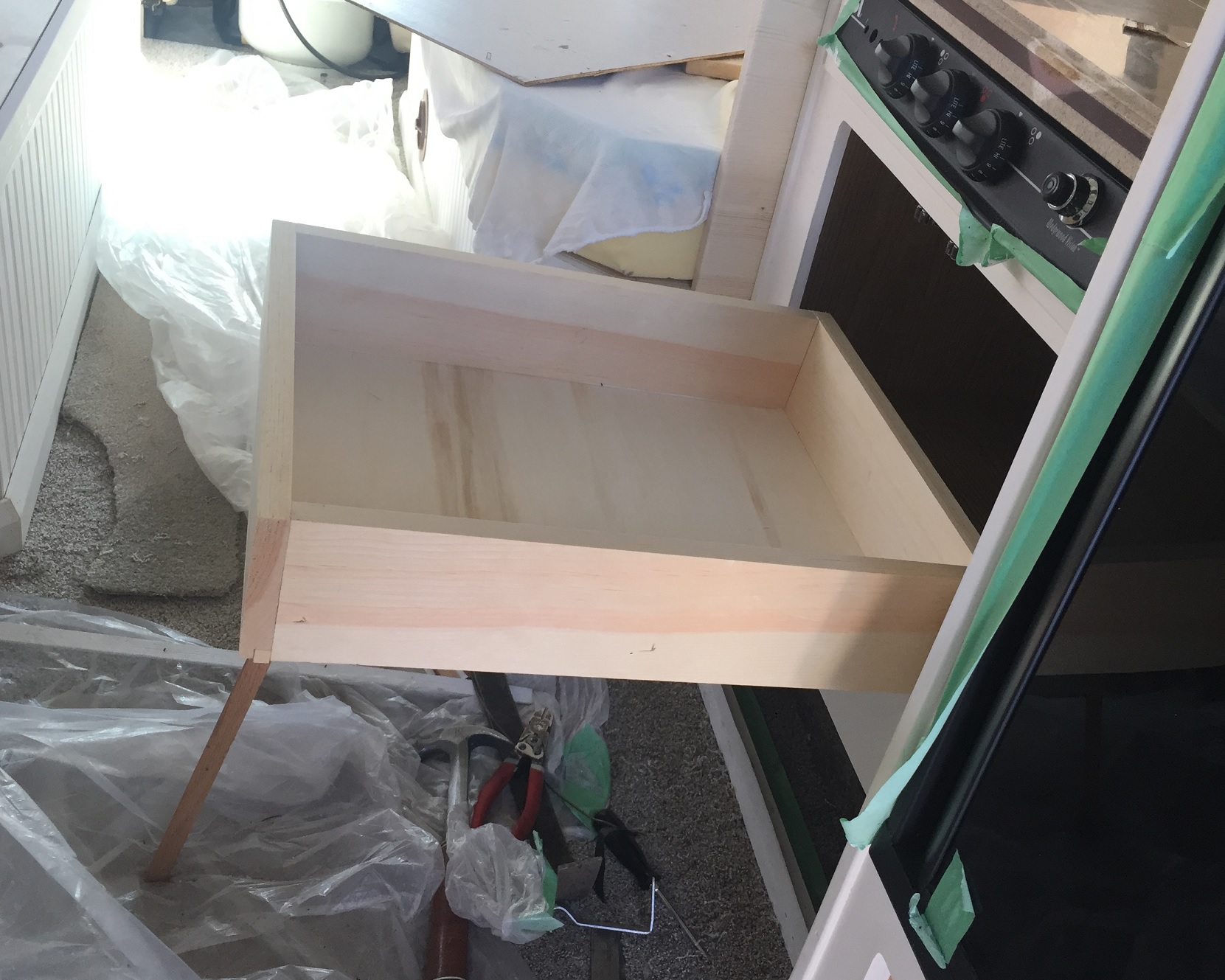

This little pot set came with the Chinook and the height appears just about perfect! Final images show a fast mockup in place and the drawers fit in both length and width, so it's onto the bearing slides. Unfortunately, they don't arrive for another day so I guess it's on to filling a couple of tiny nail holes and trimming the filler blocks and possibly getting my side pieces and panels cut to fit. All in all, I'm excited to see how this all works out but so far so good

All holes filled, glued in the corner blocks. A couple of edges are out 1/16" but a few passes with some sandpaper and everything will look really nice. I'm liking where this is going

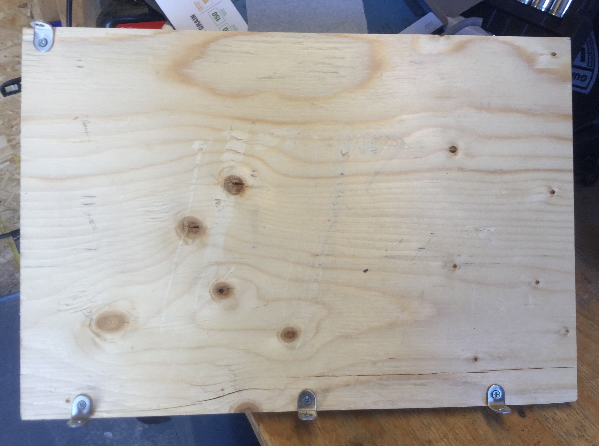

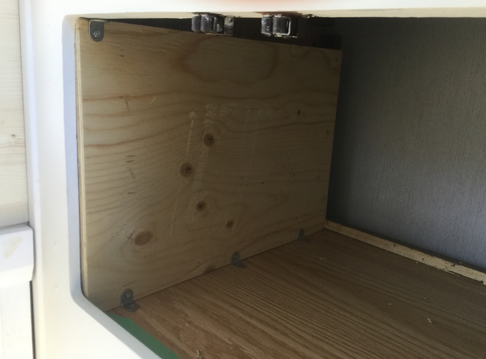

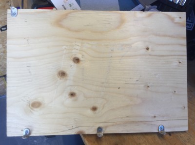

Well, as usual, change orders are needed. The original plan of having two side pieces to support the side panel will be difficult to execute. After careful measurements, the carcass is out of level/square so to use my two hidden support pieces will necessitate cutting them on angles and trying to get them to fit and still keep a pretty reveal (edge) on the front panels which will be seen. Didn't like that, so after cutting the side panel to size, I found that there is a mounting edge on the top of the opening that I can screw an L bracket into, see the photo. Each side panel will have 3 L brackets across the bottom edge and one on the front top corner. If I have to, I will add a support bracket across the back. I know, confusing. Once it's done, it will be more obvious and it's actually a simpler install. It will also allow a little side to side wiggle room so the front end edges that will show can be as equal as possible.

This should be a little clearer with the rough install of the left side panel and top L bracket. Bearing slides will be mounted to each side wall...
If there is any deflection at the top right corner, I will add a support piece between the two sides and that will create enough rigidity I'm sure.

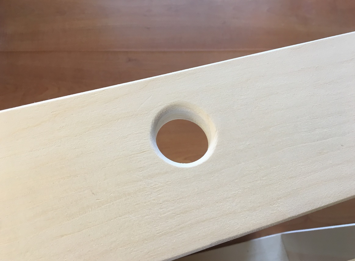

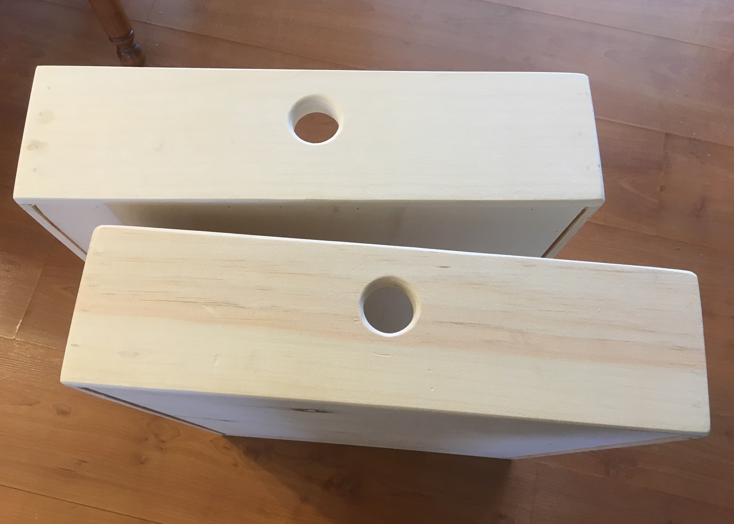

Got my dates mixed up, slides don't arrive until Monday! Oh well, was going to install drawer pulls but then realized that would add length to the drawer, cost to the job and weight to the RV, so decided to simply cut some holes and sand them all down. I like the simplicity a lot. Now, we wait for Amazon...
