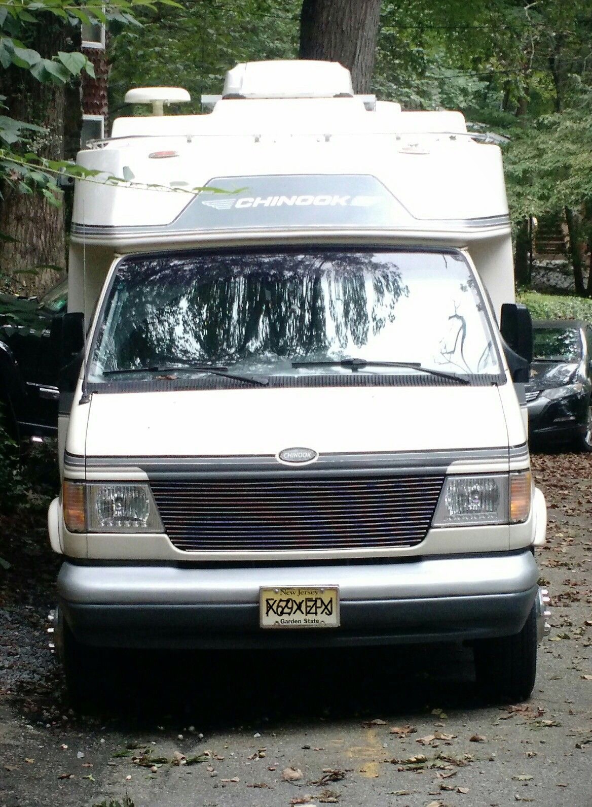

Could customize one of the Ford emblems.ASaucyBurrito wrote: ↑August 19th, 2019, 6:06 am The local junk yard was having a 40% off sale, so I picked up a new grill and headlights to try to spruce the front end up a bit. Total investment was $40 for these. I actually purchased both this style and the big chrome oval style. I think the dual Ford emblems look a bit silly, but I don't think it stands out too much. The oval style requires a different mount that I didn't snag, so it's this for now in any case.
If you zoom in a bit on my front, you can see that I printed out "CHINOOK" on an oval drawing on vinyl printer sticker paper (though regular paper laminated would likely be okay too)... and wrapped it around the old emblem which I removed first.
Probably would be even better to cut out the same shape in flat plastic or wood.
