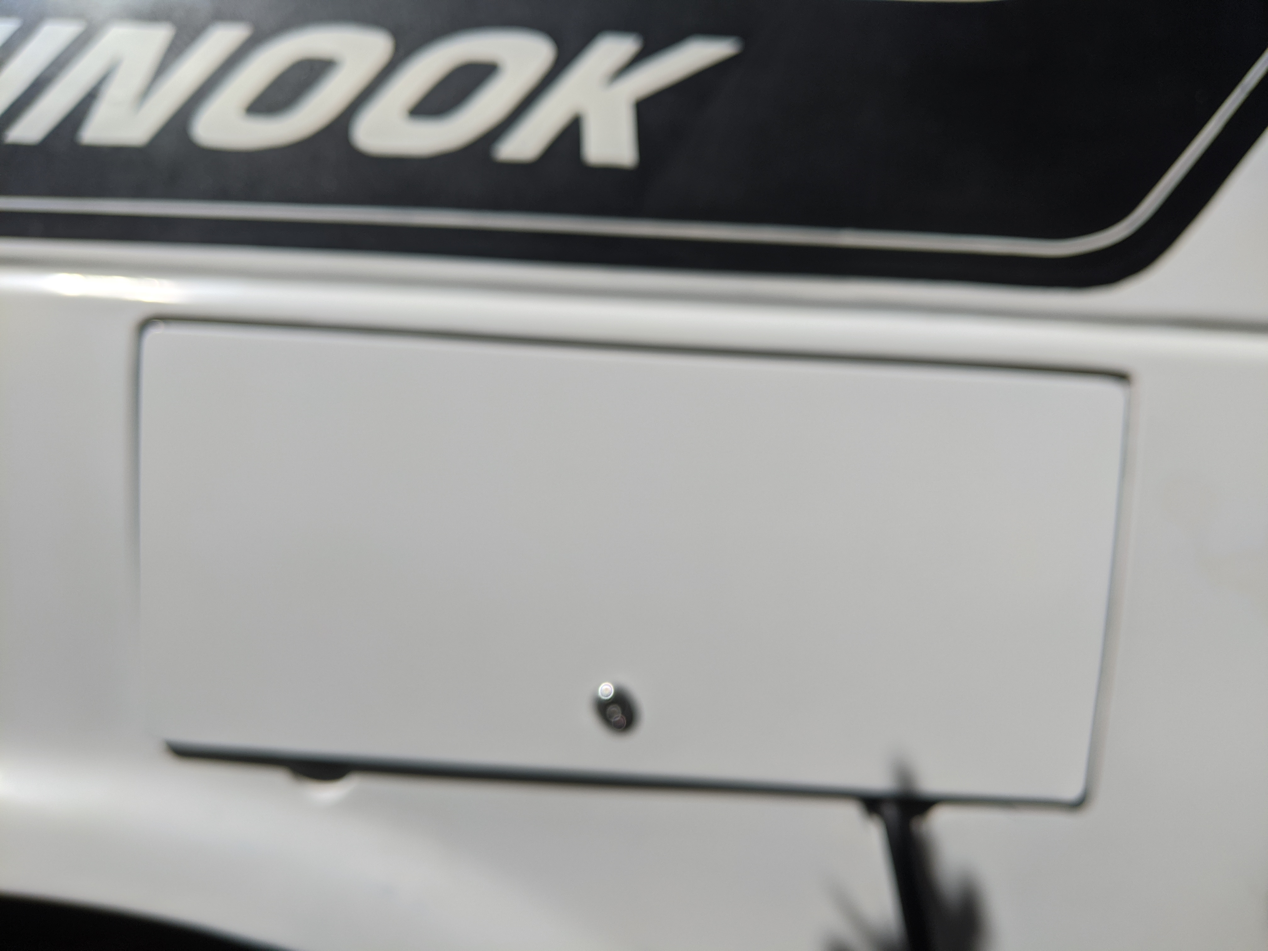

Just reread. Since I have an 01, are you saying that the hole is the compartment on the drivers side is the same on the Concourse? They just used a different bucket that included the shower? Or am I thinking about that wrong?

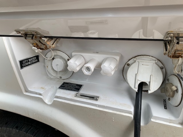

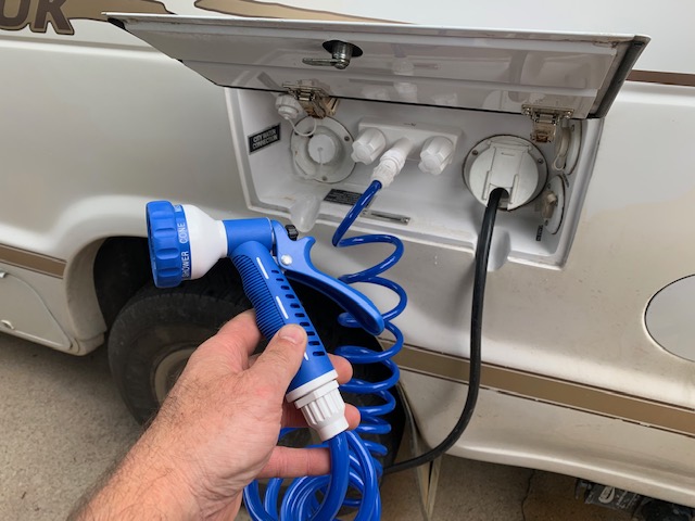

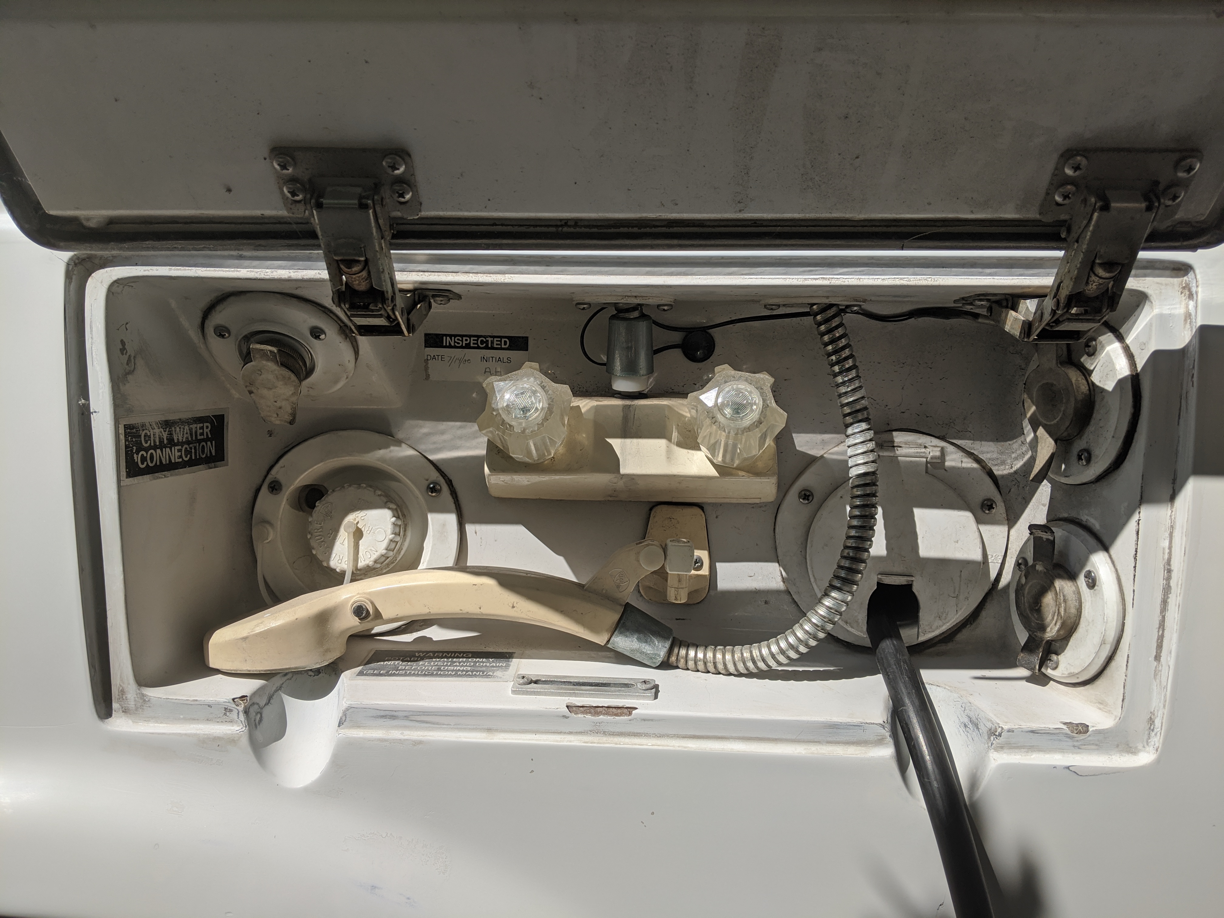

In the 2001 Concourse Model year, they consolidated the water, electricity, cable, and (yes) phone hookups, and outdoor shower into a single compartment on the driver side. The compartment is right behind the sink, so access to the plumbing and electricity was easy during construction, not so easy now with the sink and cabinetry in place. If your 2001 Premier has the same access panel, the outdoor shower plumbing is probably stubbed out there, as I believe the outdoor shower was available as an option. On the older models, the bathroom sink provided plumbing access for the shower, so a separate shower compartment was installed above the storage compartment behind the spare tire.
Here are some pictures of my 2001 Concourse hookup compartment with the shower:

Excellent! Yes, mine looks exactly like yours, sans the shower and whatever is above it. Is that a light? Now, if the plumbing is behind that panel, Nirvana. Time for a little surgery. Thanks!caconcourse wrote: ↑May 27th, 2020, 3:55 pmIn the 2001 Concourse Model year, they consolidated the water, electricity, cable, and (yes) phone hookups, and outdoor shower into a single compartment on the driver side. The compartment is right behind the sink, so access to the plumbing and electricity was easy during construction, not so easy now with the sink and cabinetry in place. If your 2001 Premier has the same access panel, the outdoor shower plumbing is probably stubbed out there, as I believe the outdoor shower was available as an option. On the older models, the bathroom sink provided plumbing access for the shower, so a separate shower compartment was installed above the storage compartment behind the spare tire.
Here are some pictures of my 2001 Concourse hookup compartment with the shower: Hookup Compartment Location.jpg Access Door.jpg Hookup Compartment.jpg
Edit: OK, so if I drilled through where the shower would go, I would go right through the back wall of the cabinet beneath the sink. And the hot/cold lines are right there for the sink. There’s obviously a space between the exterior wall of the RV and the back of the cabinet. If I could remove the back of the cabinet, no sweat. I suppose I could just punch through both to get hoses through, but then I wouldn’t be able to secure the shower to the inside of the access hatch because it would be secured from the backside. I’m close though! Any suggestions? Anyone have a pic of the shower plumbing under the sink on the later models?

The metal thing above the faucets is the beginning of the shower hose, which disappears into the compartment and then comes back down another opening to the shower head/handle. The shower hose is a flexible metal hose, which pulls out from the top of the access compartment, and stores back into it, similar to the electric cord.
You can remove the back panels under the sink, but you need a little bit of contortionist skills to get to it. There is a side panel that covers the box where the electric cord stores, and some flimsy shelves and panels that cover the back. I think they are all attached with screws you can remove. I would go that route to get to the plumbing rather than compromise the access hatch area trying to get in from the outside.

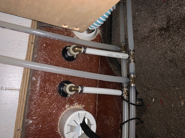

Yes, the plumping is back there. If you remove top drawer you will see the water lines. I looked at my 2000 Concourse and my 2001 Premier, both of them have same piping going to bath sink and installation of new piping would be easier. It looks like piping under would be very hard to reach. The piping on concourse has shut off valves before connecting to outside shower.
