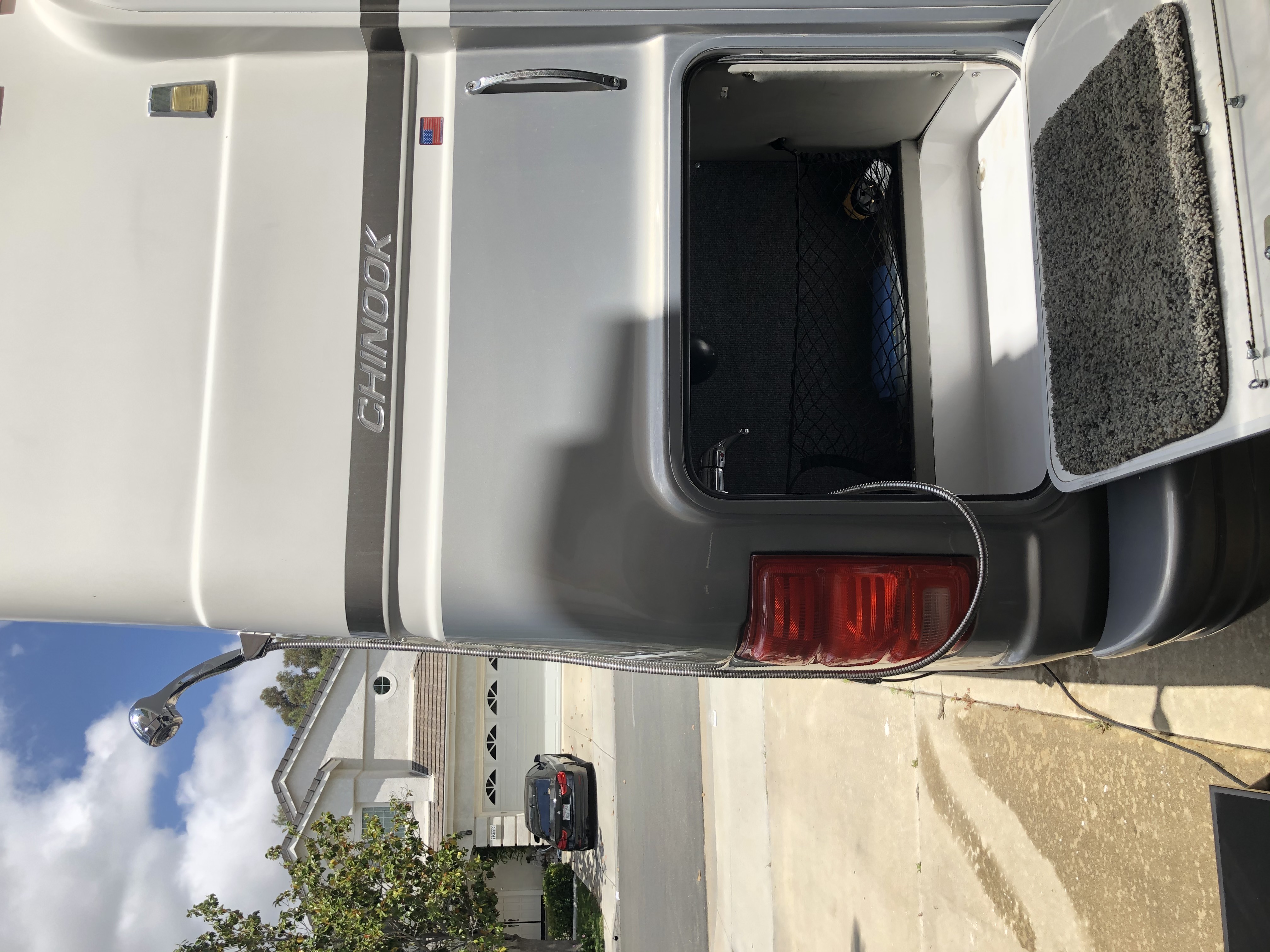

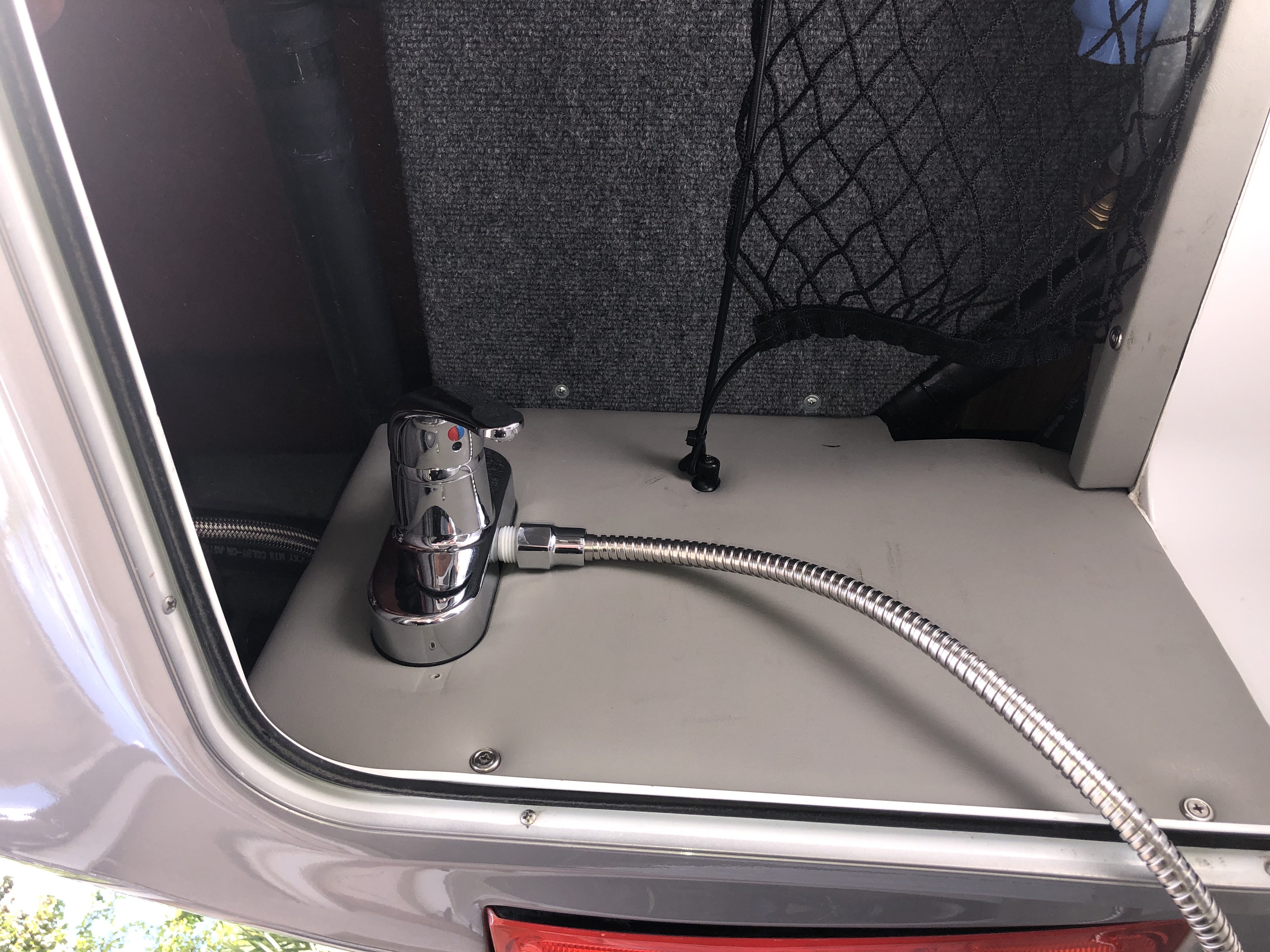

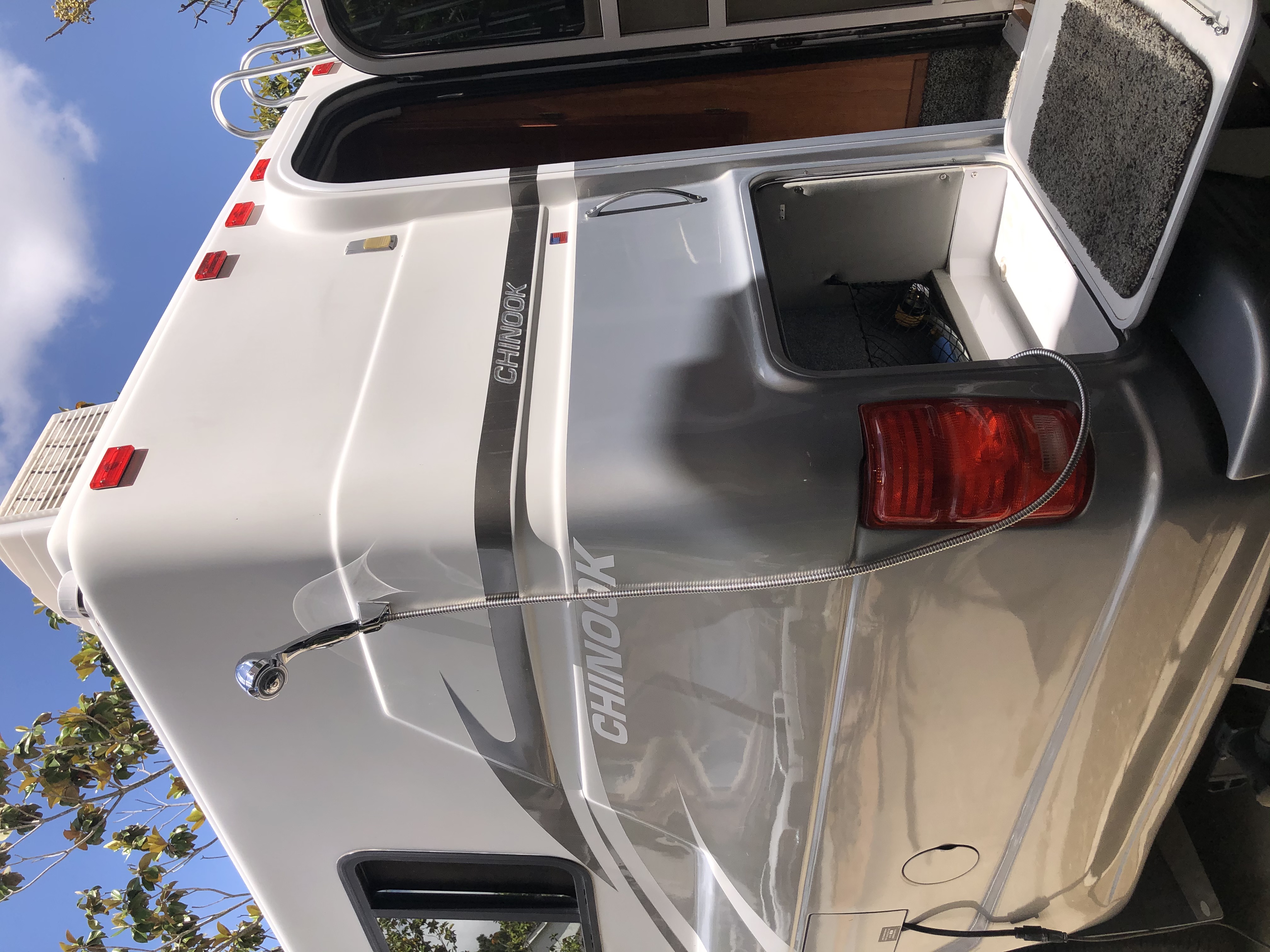

If you click on the image, it blows up and turns to the correct orientation.
