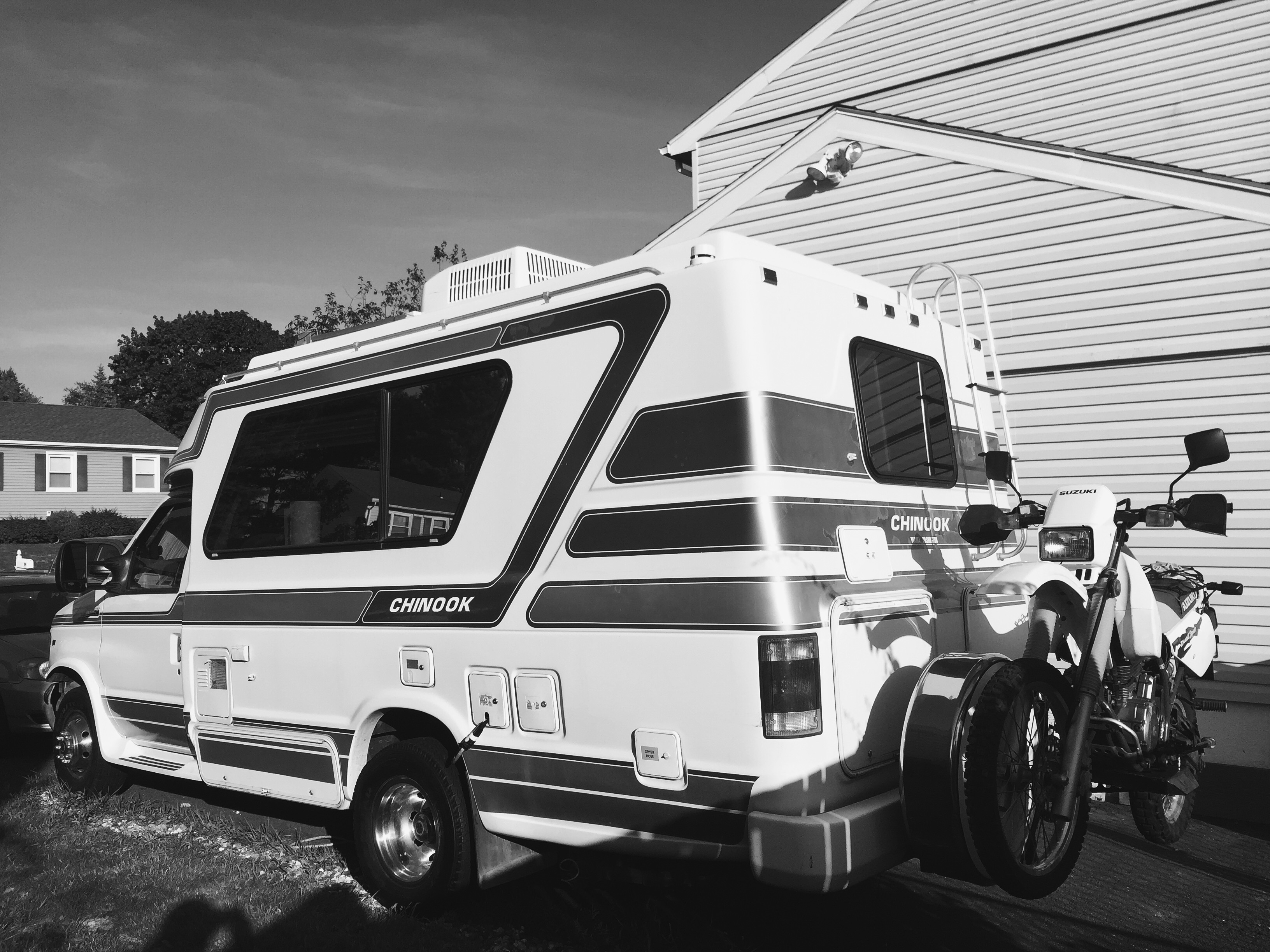

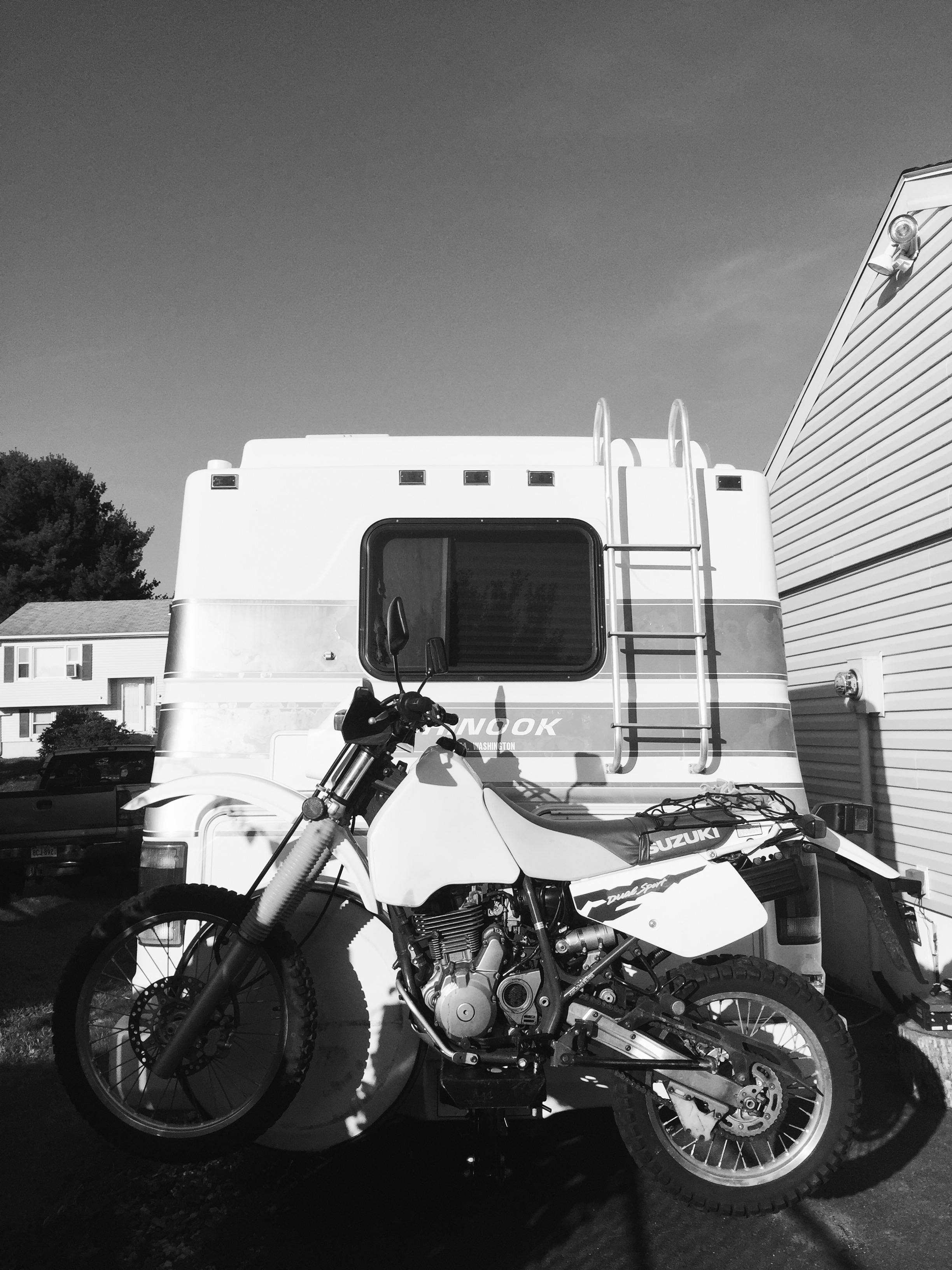

Re: Motorcycle & Motorcycle Carrier
Figured I'd add to this post then create a new one even though this post is a couple years old. After my long hunt for the perfect side door Chinook, and almost giving up and going with a rear entry, I'm glad I didn't. Hanging a motorcycle off the back was the main reason for insisting on a side entry. I found this bottle jack style Moto carrier for $100 on Craigslist! These type of carriers retail for $400 plus depending on which of the three company that offer this style you go with. Last night I finally mounted it up and loaded the DR on the back to see how it sat and I'm very pleased with it. When jacked up and locked in the upright position it sits nice and high and shouldn't effect my departure angles at all.
