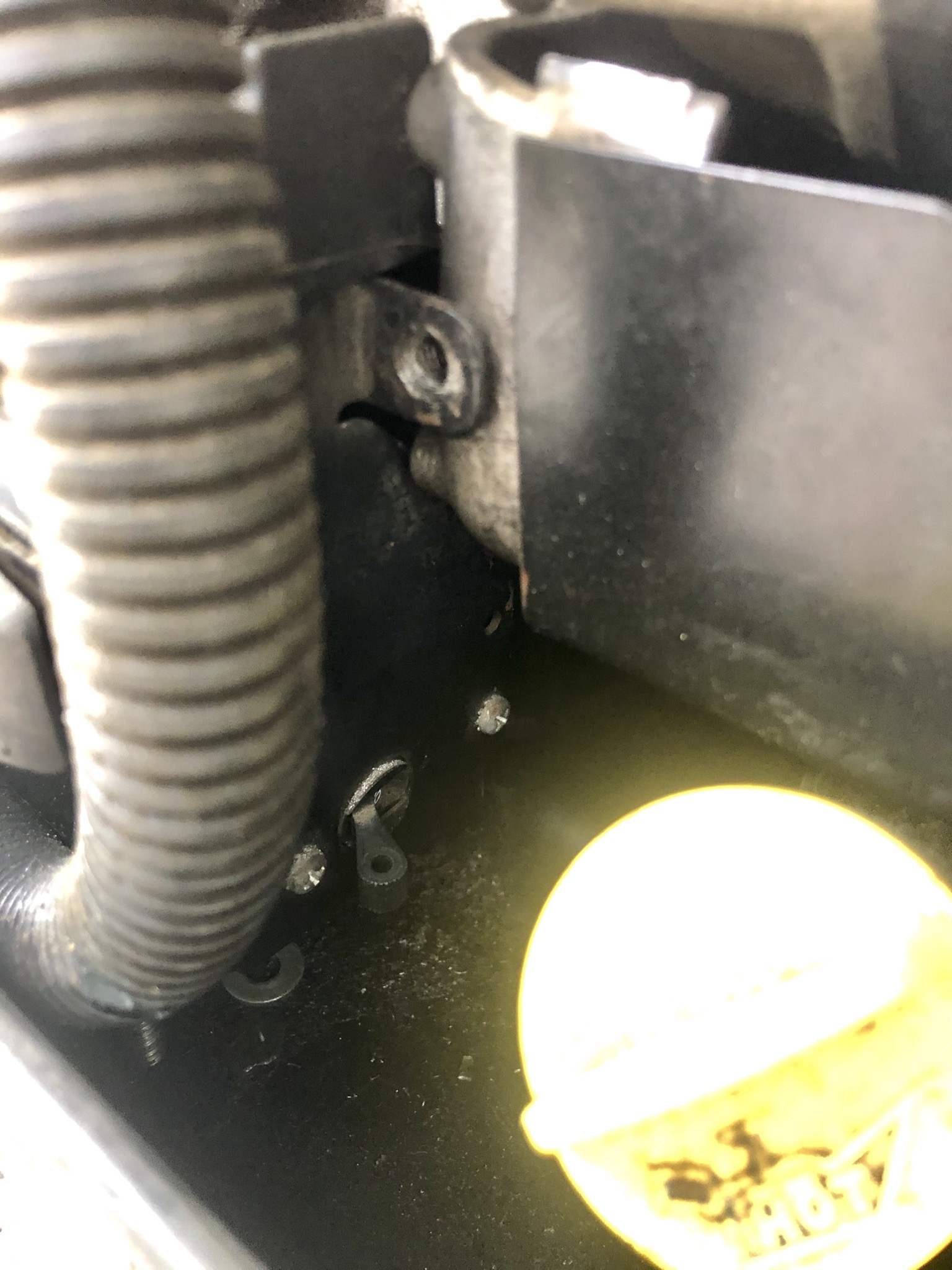

Can you tell me more about where the resettable breaker is? Mine is a slightly older model (2000) and so far, I have not able to locate this breaker

That breaker is part of the 12 volt DC system, its not going to prevent you from having AC voltage. Let me rephrase that, as long as your generator cranks and starts, it isnt going to prevent you from having AC voltage. Its usually inside the generator compartment screwed to the interior compartment wall on the left hand side of the generator. The cable goes to the start solenoid inside your generator housing.
If that breaker trips, your generator wont even crank let alone start.

Oh yeah, I knew it is not related to the issue that the OP has. I have a resettable breaker on the manual diagram, but I can't find it anywhere. Some have it under the hood, and in the picture, it is attached to the genset case. I was not able to find it in either location. Since it is the first time I see a picture of it other than the one under the hood, I just want to take the opportunity to ask him where exactly his is at.dougm wrote: ↑August 22nd, 2020, 3:54 pm That breaker is part of the 12 volt DC system, its not going to prevent you from having AC voltage. Let me rephrase that, as long as your generator cranks and starts, it isnt going to prevent you from having AC voltage. Its usually inside the generator compartment screwed to the interior compartment wall on the left hand side of the generator. The cable goes to the start solenoid inside your generator housing.

It is not attached to the genset case. What youre seeing in the image is ghost light being reflected off of the generator from a camera flash. Look at the wire looms, are they also magically vanishing threw the side of the genset case? It is mounted on the interior wall of the generator compartment. Take the front cover off of your generator, find the start solenoid on the left side near your fuel pump, trace the cables, one goes to the generator starter, the other goes out of the generator case and attaches to that breaker, or in your case who knows where it ends up..... Someone could just as easily have removed it because it malfunctioned so rather than replace it, they attached the two cables together and trashed the breaker, who knows.

It’s right next to the oil fill cap reservoir inside the generator. Its towards the front of the generator, easily seen as soon as the front cover is removed.chin_k wrote: ↑August 22nd, 2020, 8:16 pmOh yeah, I knew it is not related to the issue that the OP has. I have a resettable breaker on the manual diagram, but I can't find it anywhere. Some have it under the hood, and in the picture, it is attached to the genset case. I was not able to find it in either location. Since it is the first time I see a picture of it other than the one under the hood, I just want to take the opportunity to ask him where exactly his is at.dougm wrote: ↑August 22nd, 2020, 3:54 pm That breaker is part of the 12 volt DC system, its not going to prevent you from having AC voltage. Let me rephrase that, as long as your generator cranks and starts, it isnt going to prevent you from having AC voltage. Its usually inside the generator compartment screwed to the interior compartment wall on the left hand side of the generator. The cable goes to the start solenoid inside your generator housing.

dougm wrote: ↑August 22nd, 2020, 3:54 pmThat breaker is part of the 12 volt DC system, its not going to prevent you from having AC voltage. Let me rephrase that, as long as your generator cranks and starts, it isnt going to prevent you from having AC voltage. Its usually inside the generator compartment screwed to the interior compartment wall on the left hand side of the generator. The cable goes to the start solenoid inside your generator housing.
I pressed the red button today as shown on this picture and the generator does not crank or start at all. Once flipped back to the original position, generator cranks and starts right up.
