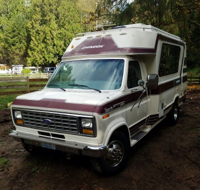

Mechanically, it needed two new batteries, all fluids changed, glow plugs, fuel return lines, thermostat. It needed a transmission. I added a transmission cooler. I replaced the vacuum pump and modulator. I put shocks on it. I replaced the heater fan and cleaned out the heat duct system. 6.9 IDI diesel has 90k miles on it.
I replaced the windshield, since it leaked, and door gaskets, fuel gauge, and one electric window motor.
Still needs galley redone, floor covering, electrical upgrades, entertainment upgrades, and solar. Tires, brakes, and other systems are okay. Cab air conditioning needs to be upgraded to 134 system.
The odometer does not have the last digit, so it is functionally impossible for an 87 to only have 20k miles. More likely 120, which is better. The 460 doesn't like sitting around and is notorious for bad exhaust gasket. You'll have to pull the motor to replace it, if it's ticking.
Chinook was reaching it's prime in the late 80's and are worth restoring, yet I draw the line at fuel injection on the 460. I've had two of them, and they're great workhorses, but very thirsty at the gas pump.
Repainting graphics doesn't scare me. Gel coat fiberglass buffs out real nice. Be prepared to spend 3 to 5 grand on it getting it up to speed. They're worth between 5 and 7 grand on the low end, and can bring 15 grand on the high end redone and documented.
Spare tire is on the back bumper like on all 18+ Chinooks
