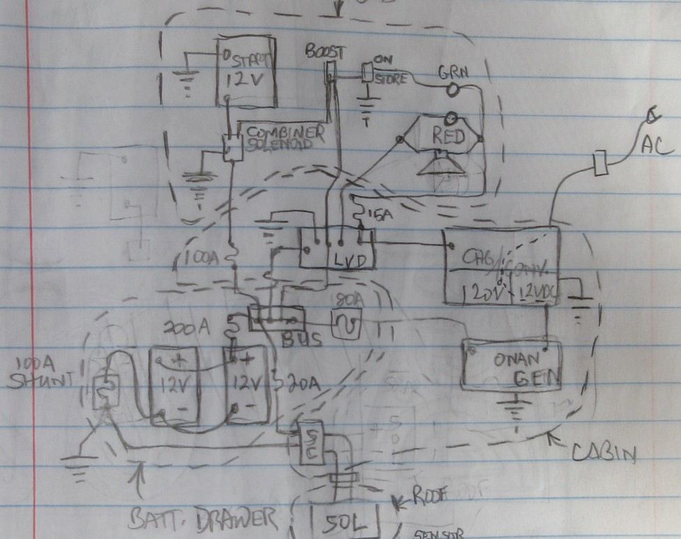

I finally was able to remove the couch panel and get better access to the LVD. I first found that the grey wire was loose in the spade terminal connector; it came out of the crimp. So, I replaced the connector and reconnected the wire to the LVD, and plugged in the shore power – fingers crossed. No such luck, still no red light and alarm. Ok, unplugged the shore power and I disconnected the grey wire and connected it to the white wire connection on the LVD. I turned on the couch batteries, and as you told me, the alarm went off and the red light turned on!

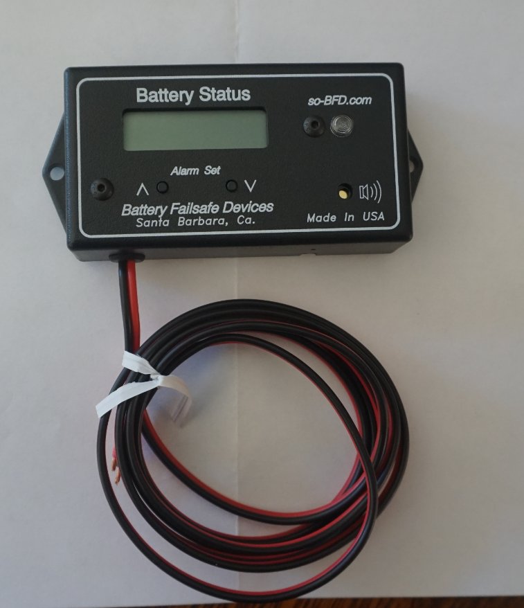

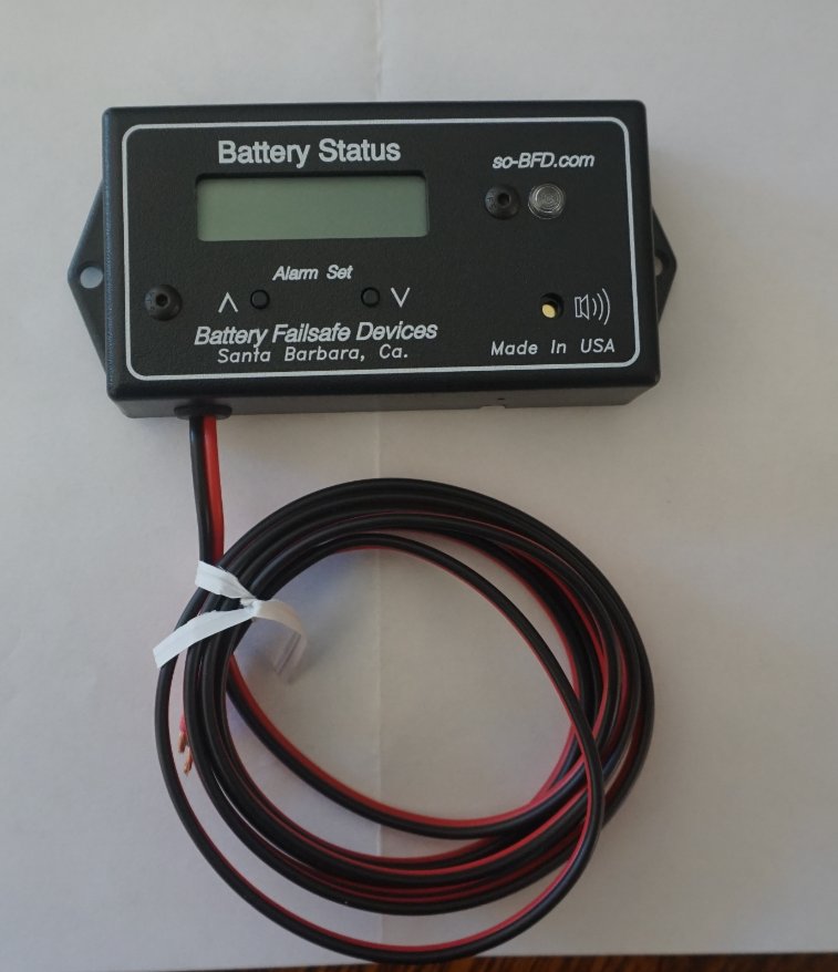

So, back to square one. I think my problem is inside the LVD. But I got the Battery Fail Safe alarm in the mail today. See the attached photo. Can I simply connect its red wire to the red sense wire on the LVD and its black wire to the white terminal of the LVD? Otherwise, I’d have to run the wires down to the battery, which I could probably do.
I can set the new alarm to the same set point of the LVD – 11.8 volts.
I am now afraid that the LVD will not sound its alarm...

11.8 is a good setpoint, but I would be more comfortable with something higher, like 12.00 or 12.20. If it has too may alarm going off, I can always lower it later rather than having to deal with deteriorated batteries.
With your battery safe alarm, I think you will be all set. The good thing about the LVD is that not only it alarms you, but it also disconnect your power. You will need to get the optional switching relay if you want that function on your new gadget.

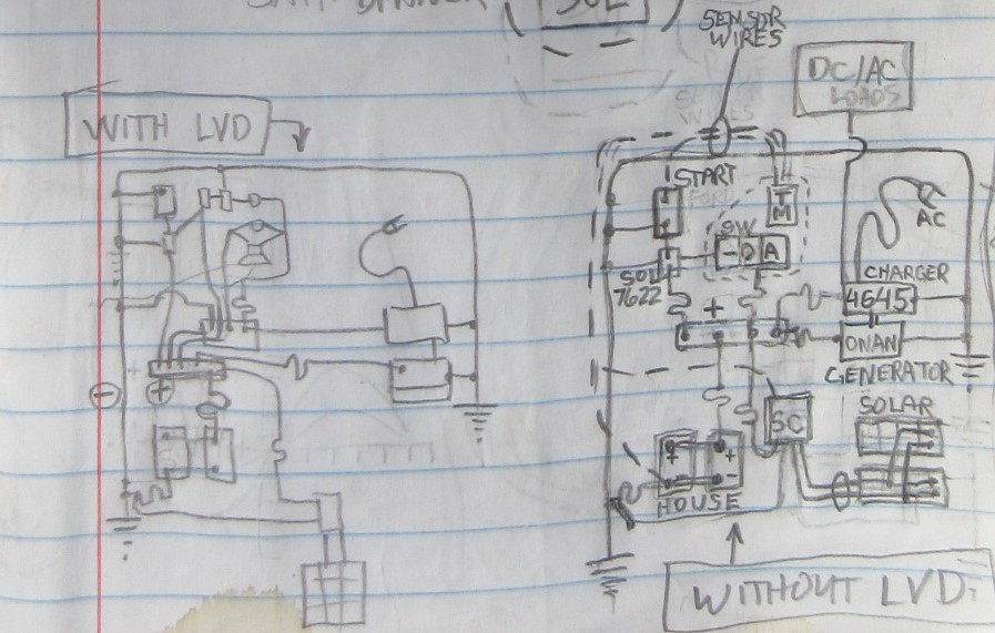

I eliminated the LVD, and replaced the battery combiner with a marine one, added bigger conductors, more fuses, and a 200 W solar system. This is somewhat what Blue documented herein elsewhere. I find it simplifies things, and makes for a more robust setup. There is more to be done when I get a roundtoit. The first diagram is solar system added before removing the LVD. Second is how the LVD was bypassed. I now have no overhead switching (My Premier did not have the overhead gen start switch connected anyway) My switches, cabin loads disconnect, and battery combiner override, are now behind the driver's seat at floor level, and batteries there, too, under the sofa,. The Bogart Industries battery monitor let me see what is charging or discharging and I can decide if the voltage is so low (12 vdc or less) as to disconnect, until the sun shines next...

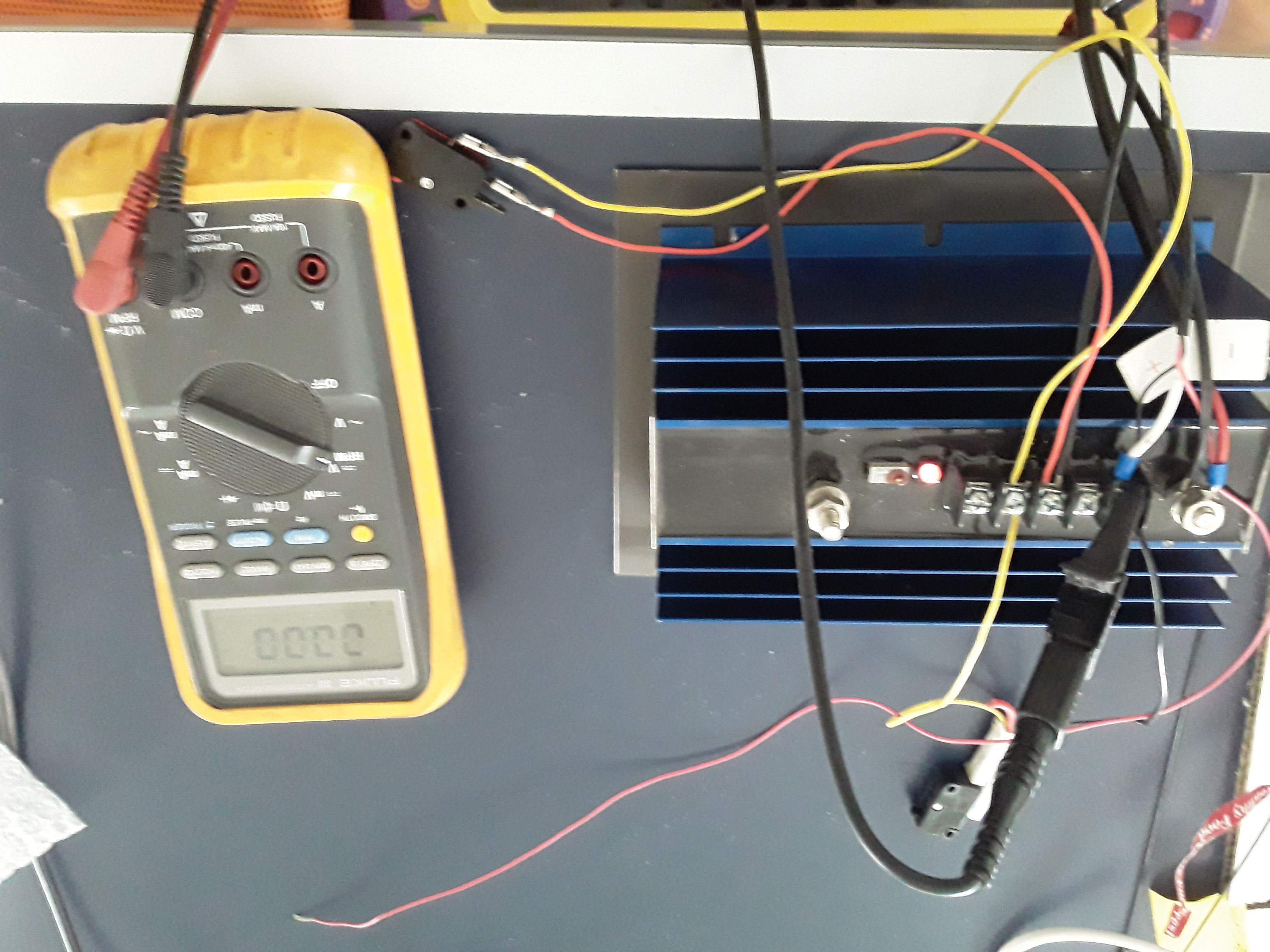

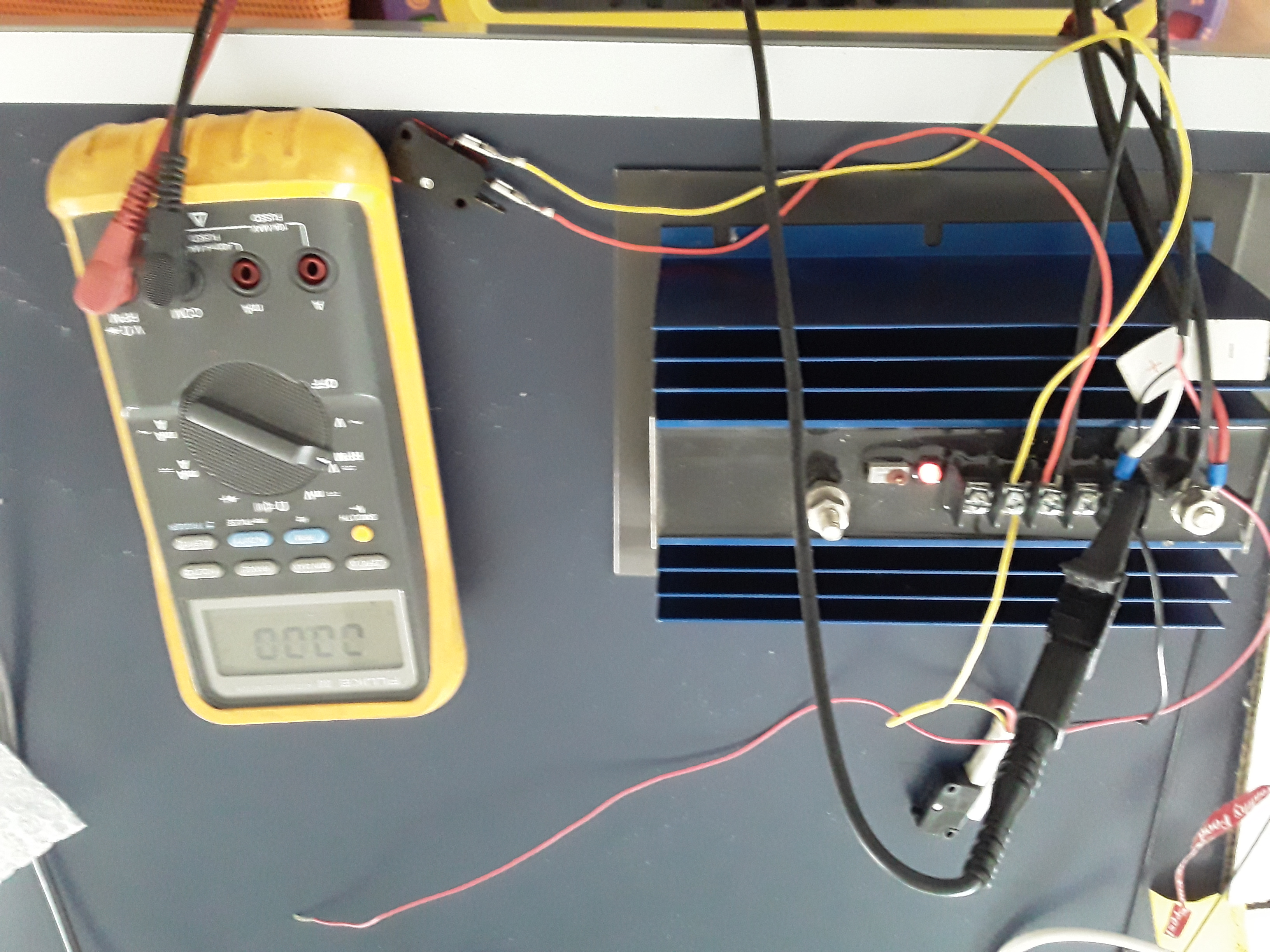

I disconnected the LVD and tested the voltage. The result is very similar to the table that Clay linked in the reference section.
The main difference is that I have 0.32 V on the alarm (cf 11.80 on the reference doc) when I measured the potential. It means that the voltage is indeed from the alarm/LED that connected to the V-out. I got different voltage on the O/R (blue) wire too since I do not ground it like in the actual setup in the rig.
voltage related to ground when OFF:
V-in 12.47 (12.47 ON)
Sense 12.47 (12.47 ON)
O/R 5.23 (10.09 ON)
alarm 1.07 (0.32 ON)
V-out 0.00 (12.47 ON)
There is no difference when I connect both V-in to V-out (to simulate when the converter is on).
I may want to put a buzzer on the setup to hear the alarm, but I need to think more what to do to make it more helpful. One thing that I noticed is that to get the LVD to be OFF, I have to press down on the switch for a few seconds for it to work. I am using a momentary switch. In the Chinook, it has a regular switch on the OFF position.
