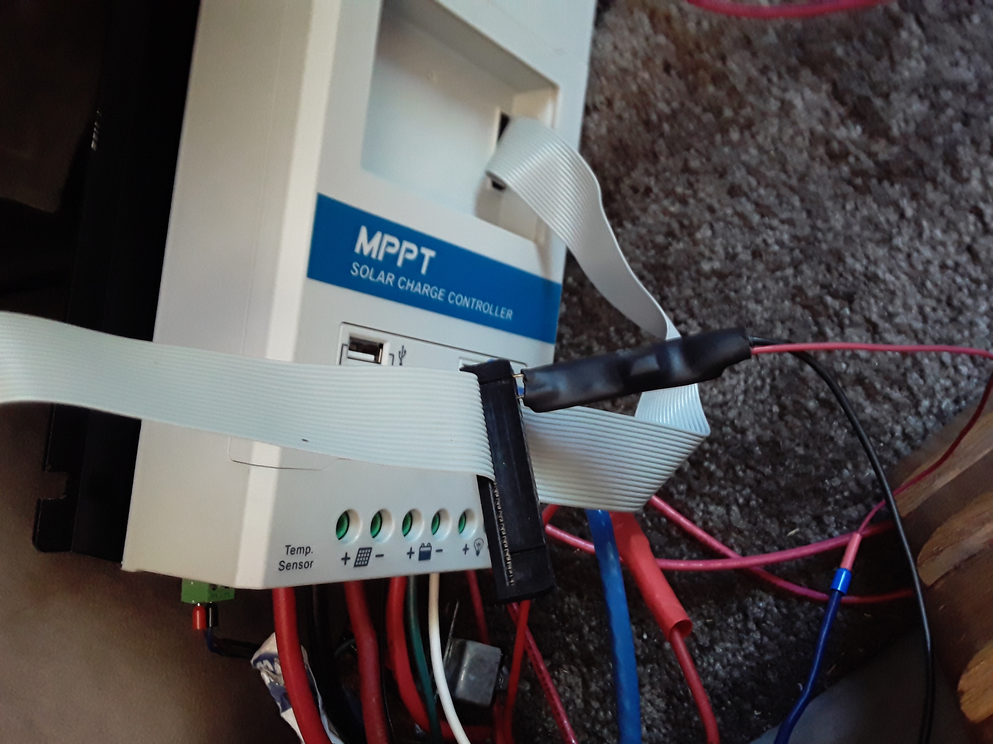

I removed the LVD, since the EPEVER controller has the load function that allows me to discharge up to 30A. The original LVD is rated much higher than that, but I think I hardly need more than 25 A. Just make sure I don't run the fridge on DC mode unless I really have to. Anyway, I removed the LVD, and mount the solar controller in the same location. It is difficult spot to work on, and I removed part of the sofa when I was doing the task. I mounted the controller below the sofa so that no one will hit it when we sleep on the bed. It also means that we can't see the display on the DS-2 module on the controller, but it is not that important since I have the remote display. I also have a temperature probe for the controller, and I instead it thru the floor opening down to the battery drawer.

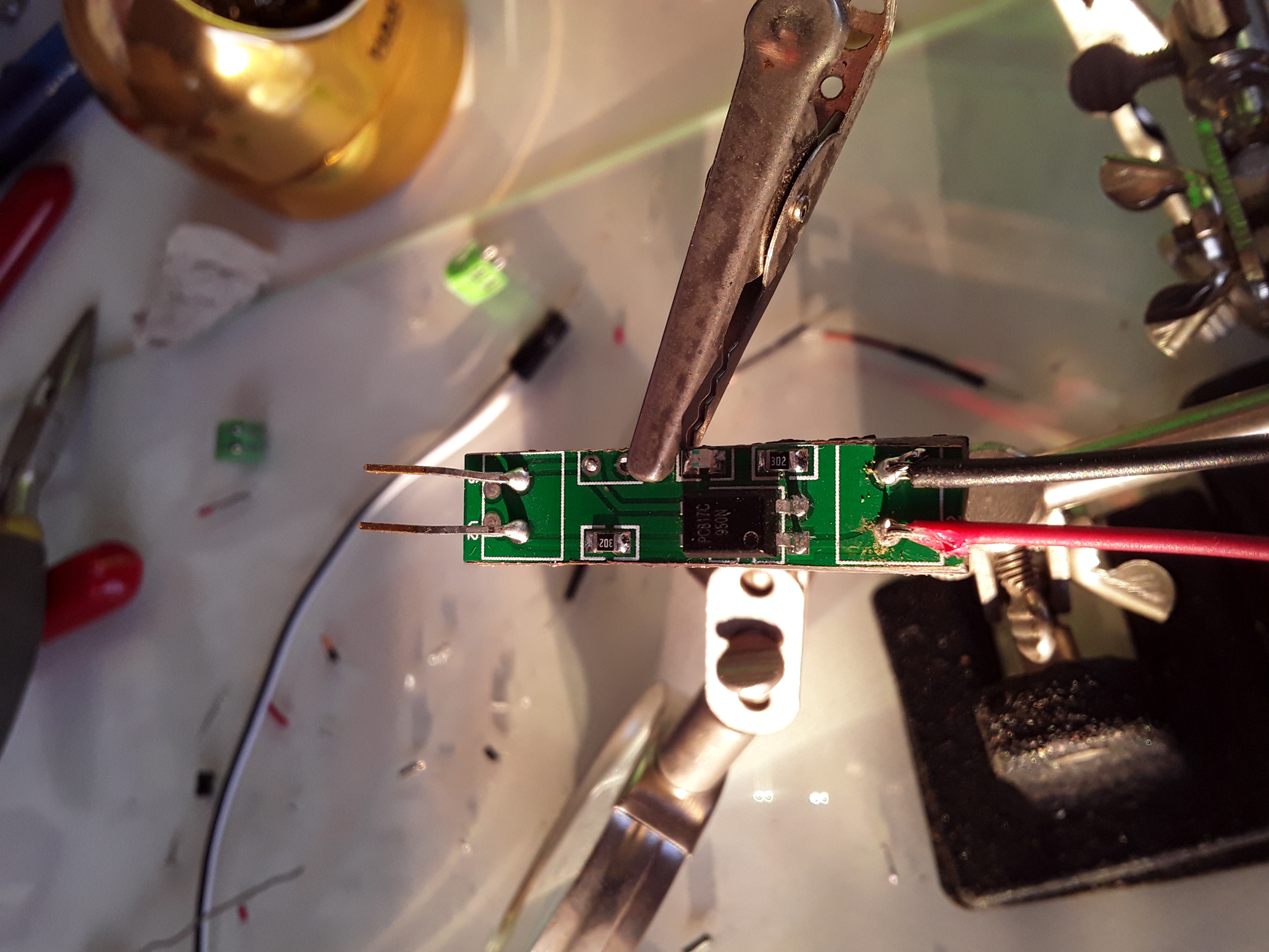

I want to preserve as much of the Chinook control as possible, so I connect the green wire from the LVD to the load output. When the load is active, the green "in-use" LED will light up. I also repurpose the blue wire to allow me to toggle the load on the controller on/off. This involved some reverse engineering, and I found out that I can ground the pin #3 on the controller to toggle the load. Since the voltage on the controller is 5V, I want to be more careful and decided to use a PC-817 optocoupler to isolate from the 12V DC from the rig. I think it can be done simpler with just one transistor, but I have the optocoupler around anyway. Since I need to tap into the controller, I used an old harddrive cable and adapter and mount the DS-2 display further up so it actually have two remote displays right now. In order for the blue wire to work, I connected the red wire from the battery (via the 15A breaker) to the red wire going to the vehicle battery switch above the driver seat.
