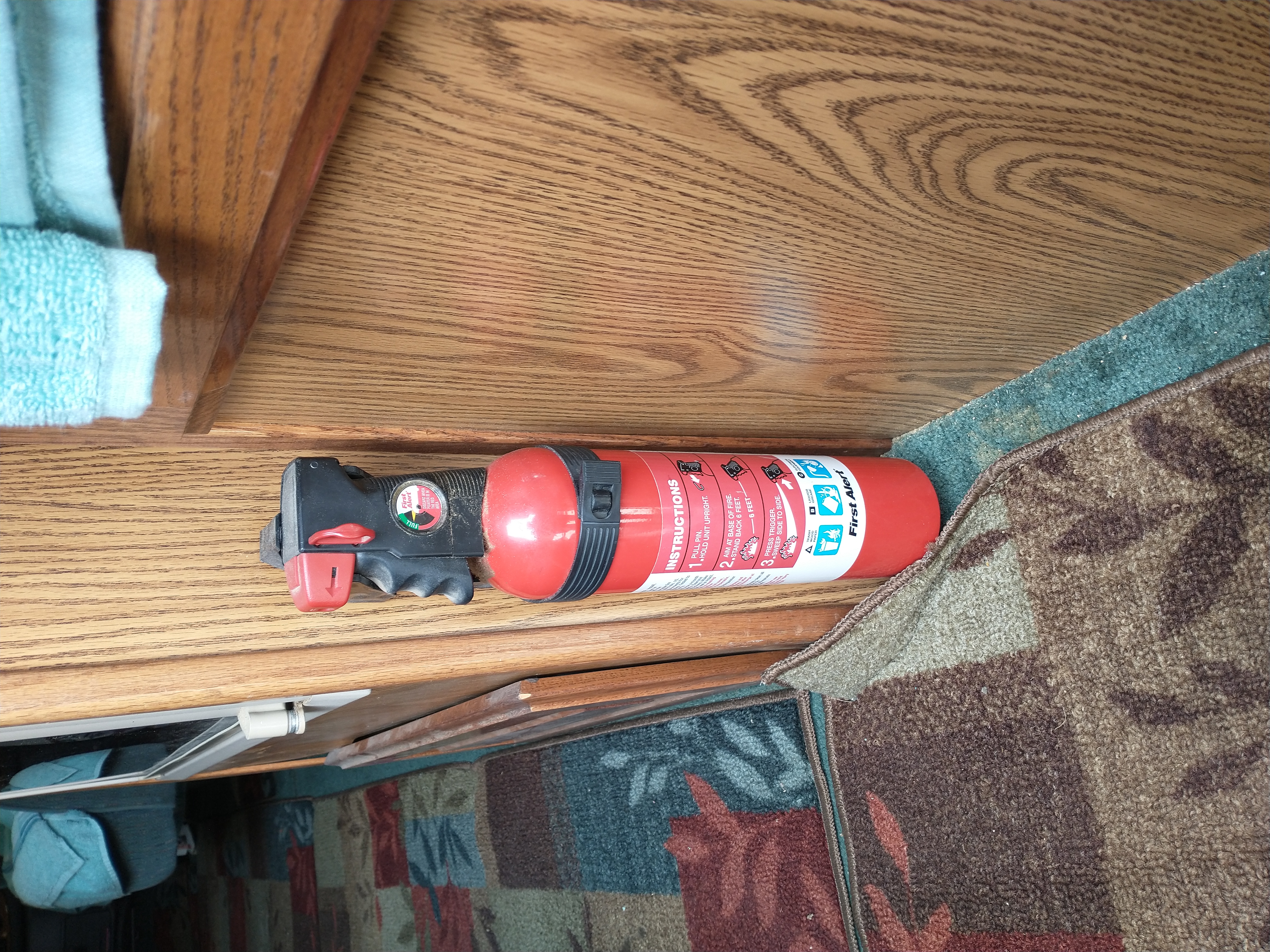

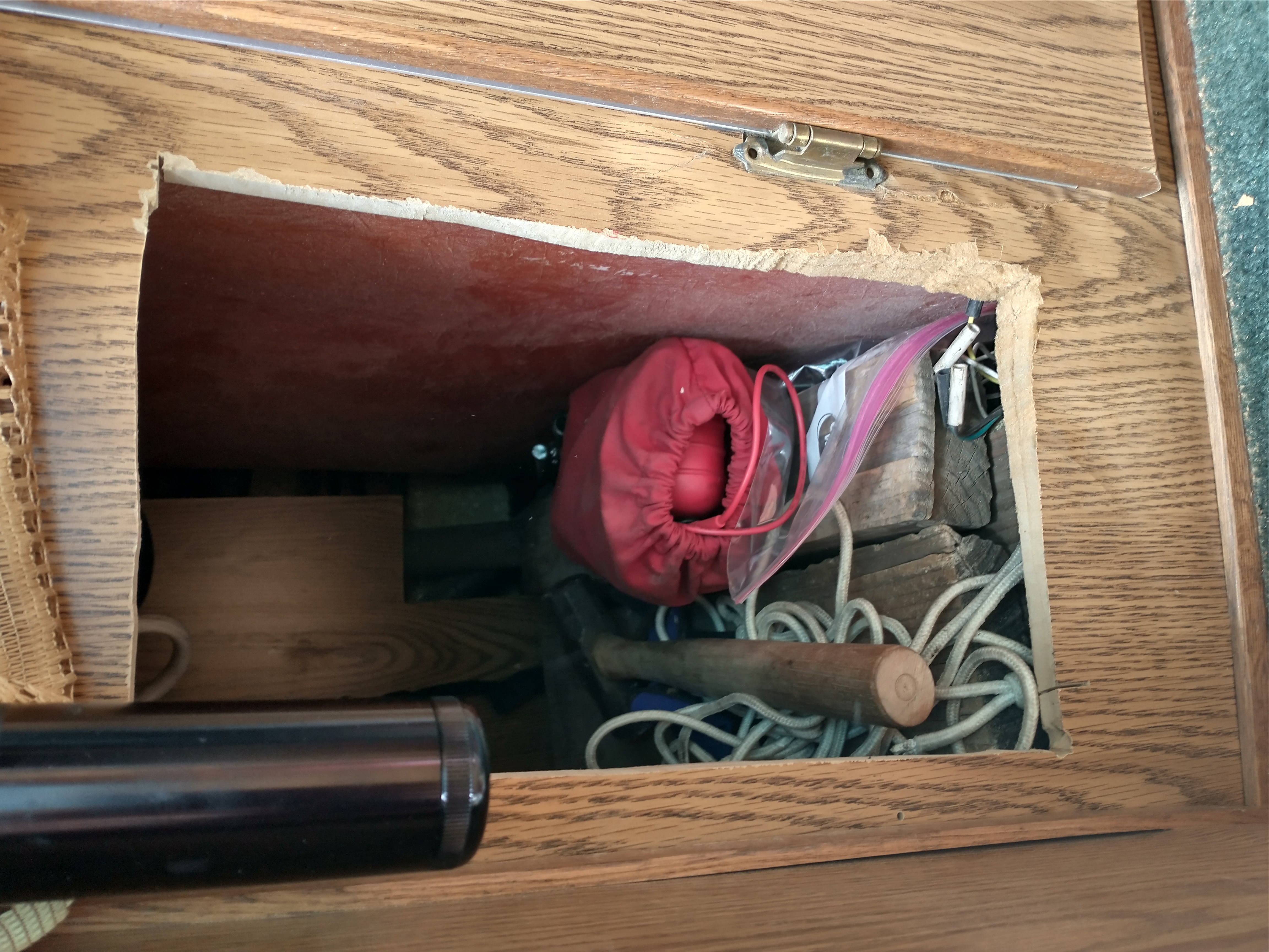

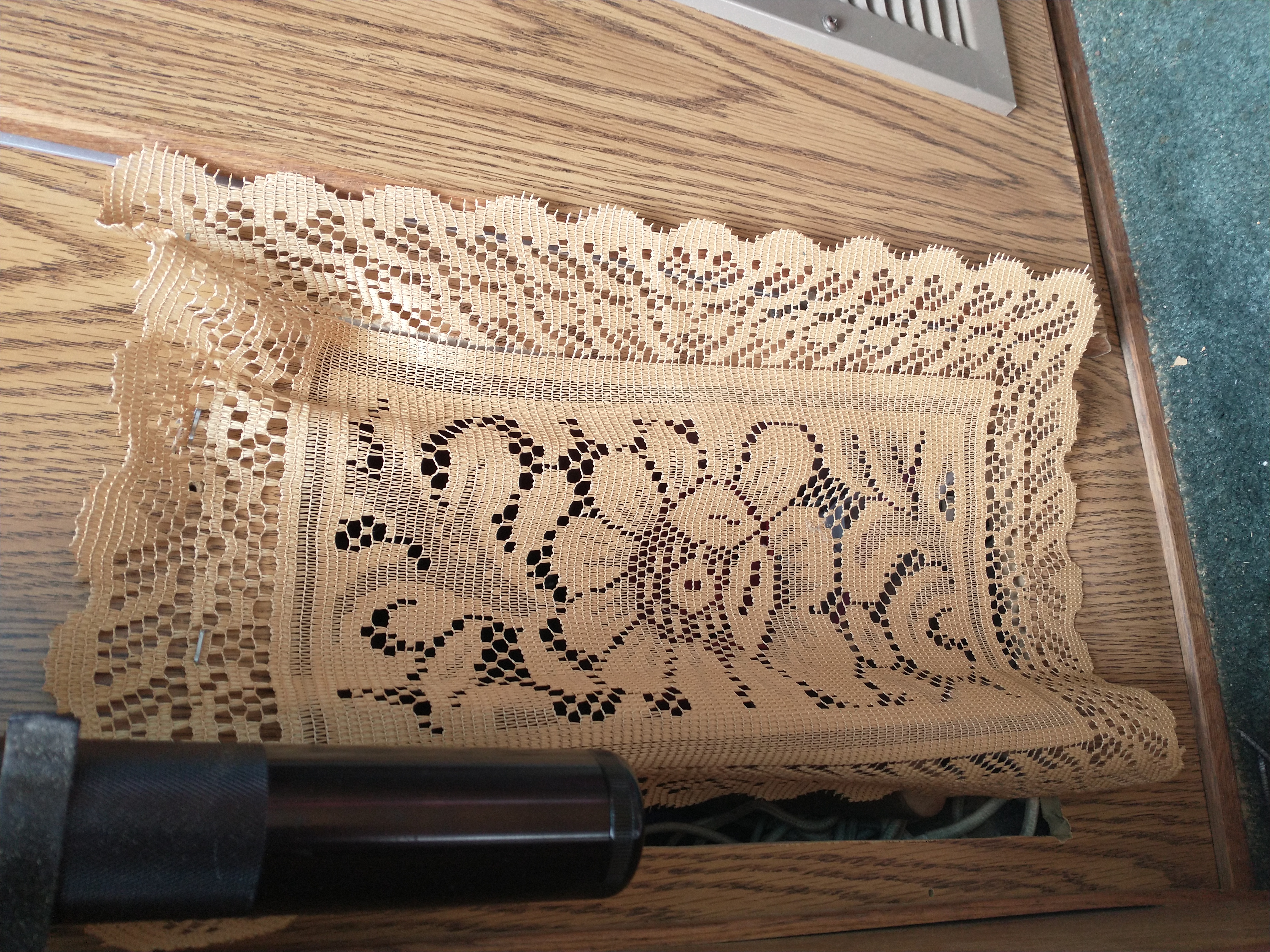

Everyone knows what a pain in the butt it is to drop down the spare tire to access the rear storage compartment so I borrowed a solution from someone on the I Love My Chinook Facebook group. I cut a door from just inside the back door into the compartment. I had to take out the false wall but now I have much more useful storage space. I presently have it covered with fabric until I can fabricate a small door. Also move the fire extinguisher across the hall.
