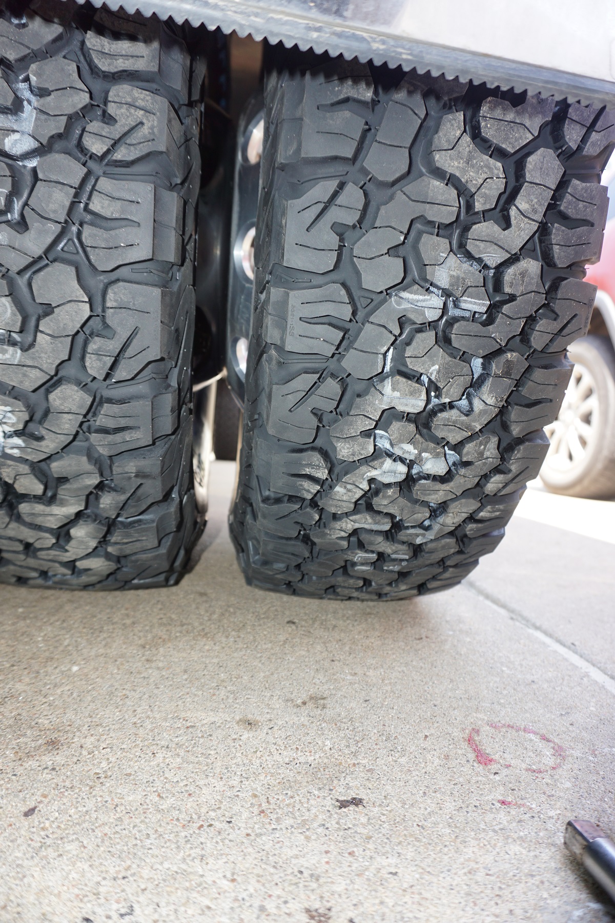

This is what i have for clearance between the two rear dually 245/75-17 tires. They are 9.6" wide each. I wanted to try a full set of the new BFG KT commercial terrain tires, but they are hard to get your hands on around here.

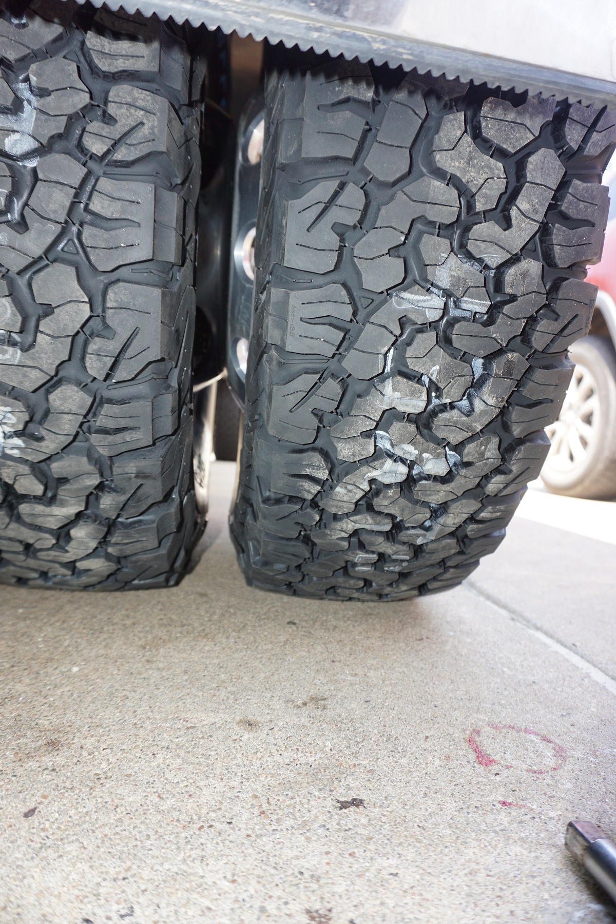

Holy cow those tires have never rolled!
Still have that new tire smell
With KO2s and 4x4 I don't think airing down will really be a concern for you... or will it? Looks beefy.

I find the KO2 to be a middle ground compromise in the interest of lower noise levels than other all terrains, perform ok in rain, but not so great in mud and or wet snow and sand. The reason being is that they dont throw off mud, wet snow, or damp sand, instead the treads clog up to the point the tires become like drag race slicks. Thats why i mentioned the new commercial BFG KT Terrain tires. But if you look at them they are more of a mud type tread, so noise levels will be higher and with the bigger lugs it will affect steering characteristics to a degree.
I just put those KO2's on the back when i swapped the 17" wheels onto the rear axle last week. I could not locate anyone around here that has the BFG KT terrains in stock to even look at them first hand.
