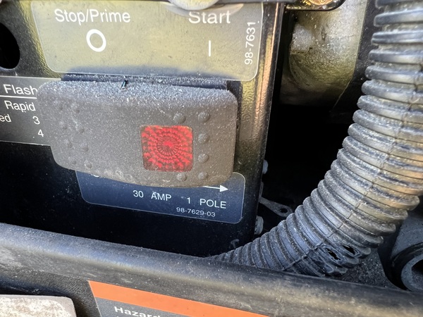

My Onan 4K generator does have a circuit breaker in it. The image below shows the manual switch, and right below it is a label pointing to the circuit breaker to its right (you can see the handle).

I don't have any breaker like the one in your pic or anywhere in the compartment or unde the engine hood.
