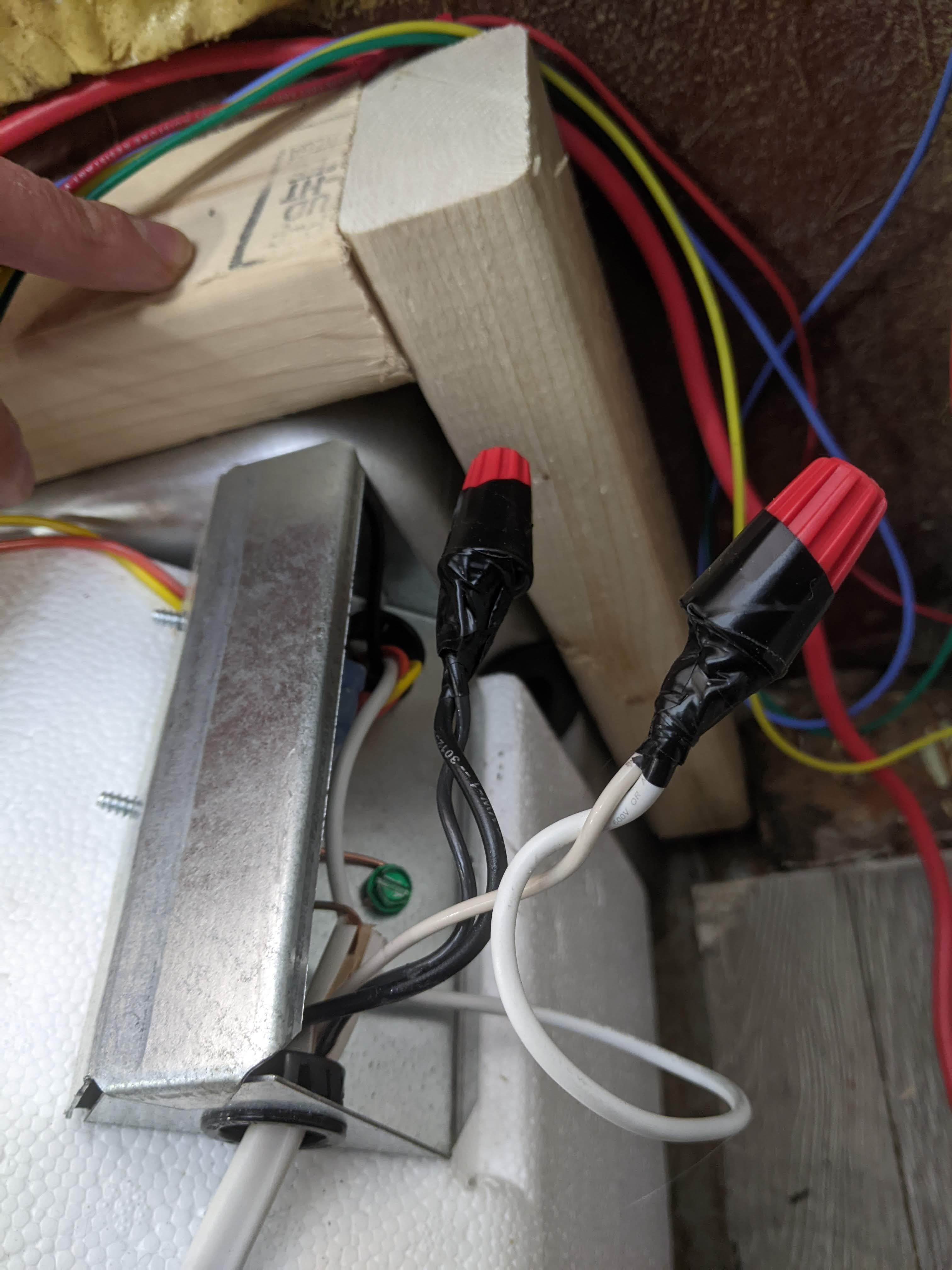

As suggested in an earlier post, I strapped the water heater to the floor and then began working on the electrical connections. I believe I am done with the electrical connections on the water heater. I connected the 12VDC side through the relay switch to the breaker box and then added a 120VAC, 15A switch to the panel and connected the 120VAC side of the water heater to that with a 14/2 romex cable. I've attached a few pictures to show the progress. I also completed most of the plumbing today (I'm hoping to finish after the holidays) and I have been referencing the chinook manual for the plumbing diagram.

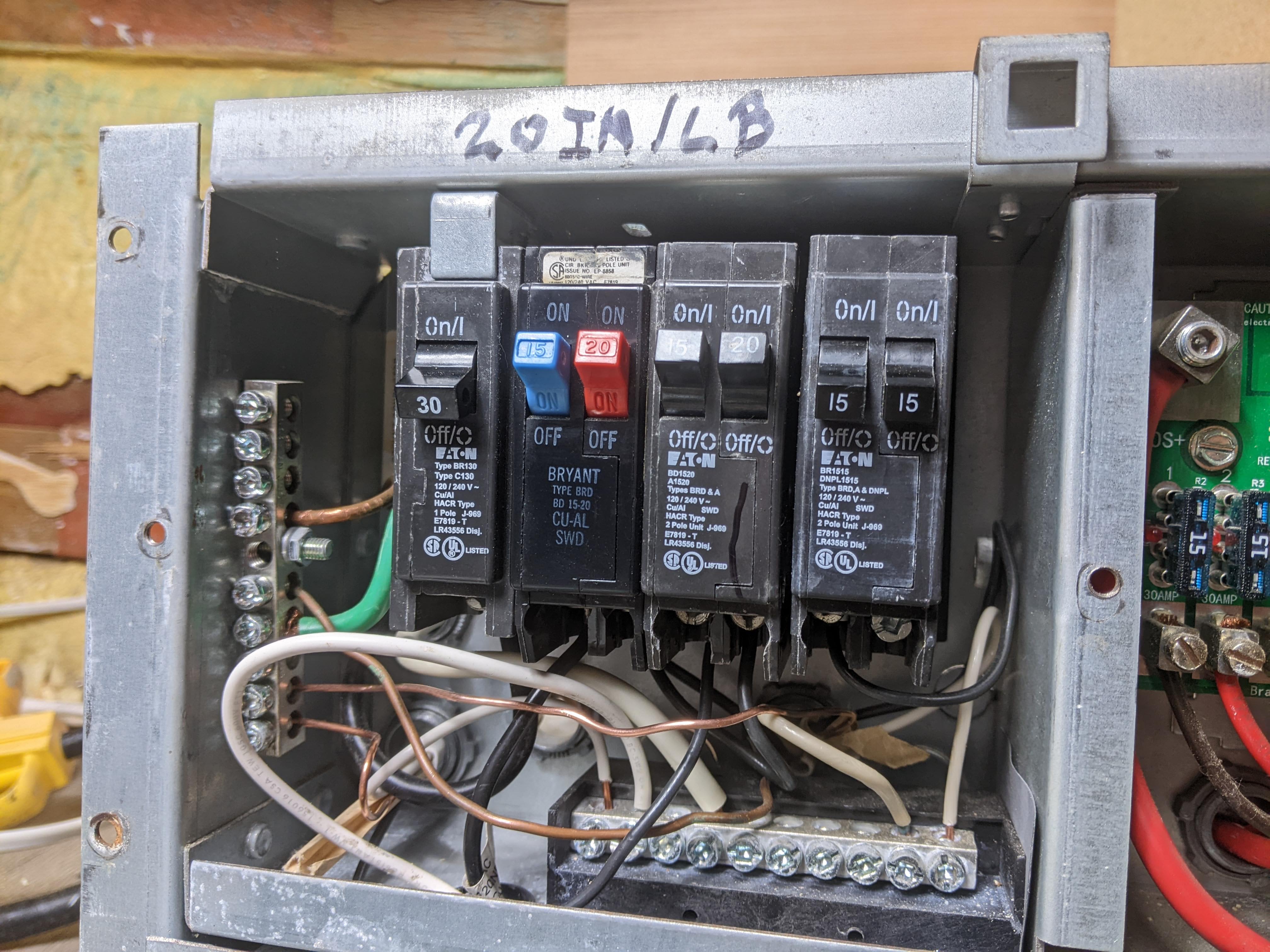

120VAC, 15Amp breaker switch added

Just some question out of curiosity.
1, what gauge is the AC wiring on the heater that the ROMEX is connected to? It looks bigger than 14 AWG.
2, I did not realize the AC panel have room for a 4th breaker. For mine, it only have cutouts for 3, so I have to replace the double-width 30A breaker with two single-wide one. I am going to take a look at mine and see if it have the space for the 4th one like yours, and also look at the panel specification to make sure it is safe to do that.
3, I see two wires on the yellow-sleeved connector on the back of the heater switch panel. I assume you are using it to bundle the two switches together, correct?
(4, the yellow wire on the back of the heater panel looks like it was not crimped properly. I assume you did it yourself. I am a bit OCD, and would redo it so that you can't see the copper, but that is just me. )

1. It is 14/2 Romex (with ground) wiring that I purchased from Lowes. I used it on a few projects earlier in the year and had some left over for the water heater.chin_k wrote: ↑December 24th, 2022, 11:26 am Just some question out of curiosity.

2. On my panel door it has four "knockouts". Three had already been removed for the preexisting breakers and the fourth I removed to add the fourth breaker switch.
3. Correct. I followed the electrical diagram for the switch and those two terminals connect to (+)
4. Yes, I've been doing everything myself so I appreciate the second set of eyes (and guidance) on these things. I'll be sure to fix that before heading out on our trip.
Re: Water Heater Replacement
For #1, I was referring to the wire from the heater. Just curious if the heater manufactorer used a bigger wire.
My rig has the old Parallex AC/DC center. There is only three knockouts, and it is limited to 5 AC circuits. I assume that your is a different make and model. You may want make sure it can support the fourth breaker (looks like it is) and the number of circuits. I would not be comfortable with having 7 circuits on a 30A panel, for example, but apparently, it can be done.

I was looking at your photo of the breaker panel. You might want to wrap part of the one ground wire that has a section which looks to be maybe a quarter inch or so from the neutral busbar - that looks like an accident waiting to happen (it might get pushed a bit when closing the panel one day, and poof!).
Yeah, the general appearance of the AC panel looks very disorganized. I always have the ground wires all the way in the back, parallel, neat and straight, and no where near the neutral bus bar, or hot breaker/parts. I do not like to comment too much on the appearance, since I can sound a bit critical. The good thing about the neutral bus is that it is not as bad if the ground wire does touch it compare to hot wire. It probably won't make a poof like BobW9 said, but it certainly is not a good safe practice. It will be a safety hazard if you plug in your rig to shore power, since it will have multiple grounded neutrals, and it won't be good if there is fault in any equipment that you plug in. With that said, I would redo the panel since I can't stand haphazardly done panel. With that said, I would redo the panel since I can't stand haphazardly done panel.BobW9 wrote: ↑December 26th, 2022, 9:31 pm I was looking at your photo of the breaker panel. You might want to wrap part of the one ground wire that has a section which looks to be maybe a quarter inch or so from the neutral busbar - that looks like an accident waiting to happen (it might get pushed a bit when closing the panel one day, and poof!).
