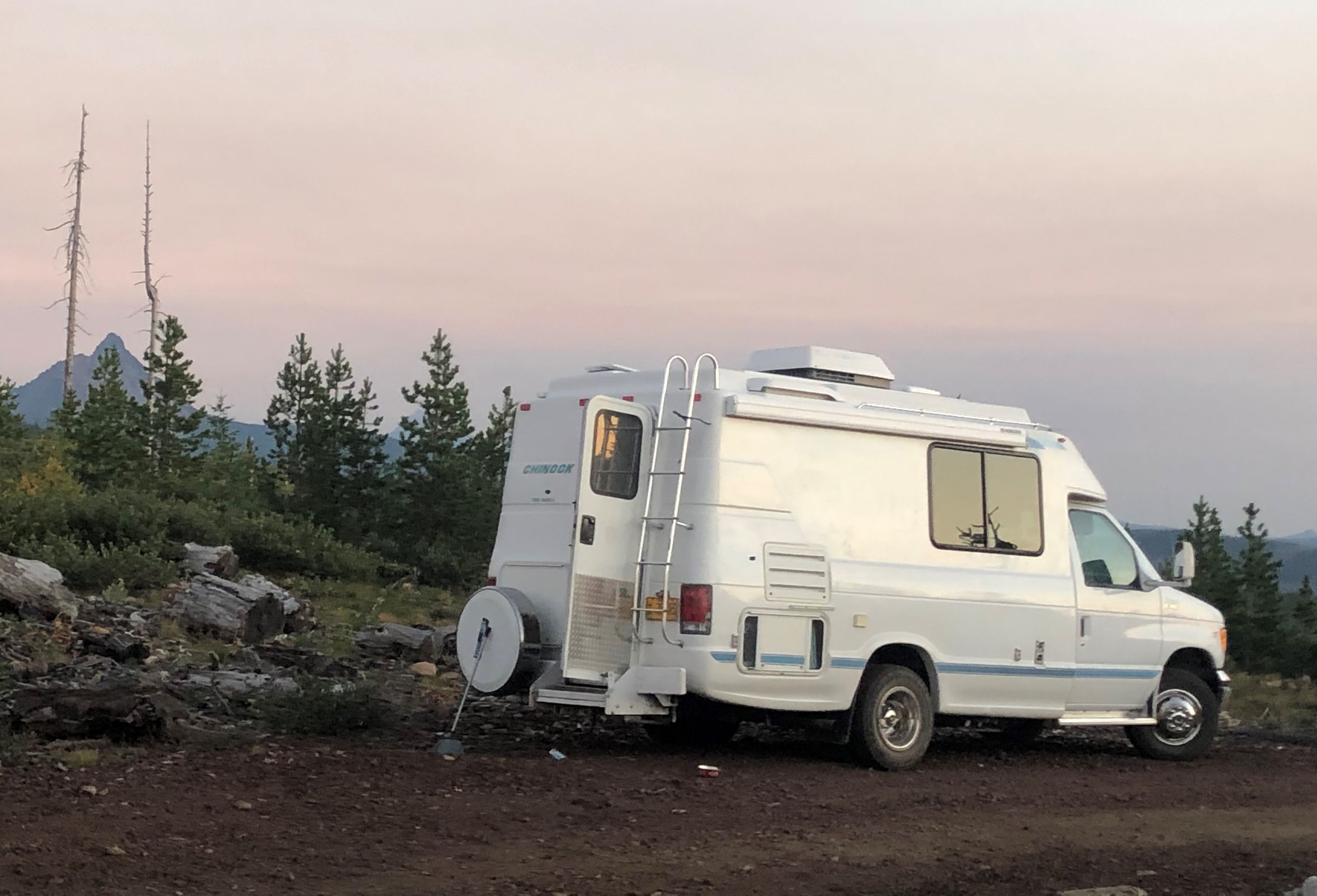

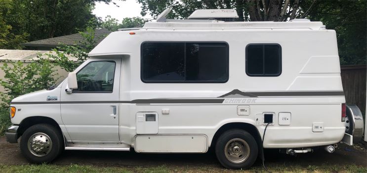

Had a request for an "after" photo so here is one. Note that I still have not pulled the upper and lower blue stripes although the passenger side upper stripe is mostly obscured by the awning. Before I pulled the stripes I removed the stripes via a photo editing program and then re-drew them in several iterations in a graphics program I have. We were wanting a bit of an updated but classic look based on the original, but, a little more monochromatic. That is in the second photo. After all of that we are thinking we may like the "bare" look better as well.

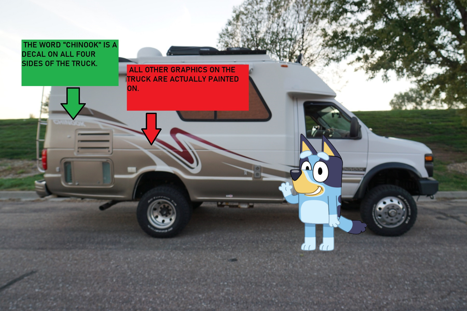

Re: Gel Coat Restoration, Sealing & Stripes
Concourse has decals as well....
My Concourse is an 05 and the graphics are painted on with the exception of the decals on each side and front and back which say CHINOOK.
That is interesting, since I remember that they are either painted, or decal, but maybe at later years, they are doing both on the Concourse.
