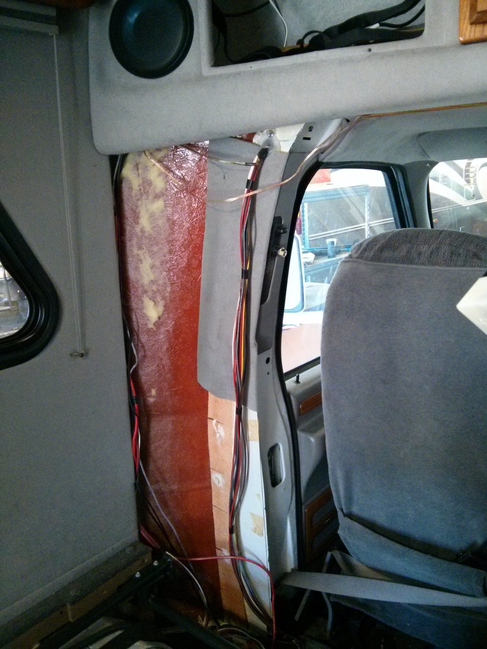

I agree with Chin_k, if possible you're better off getting 12V TV and DVD, more efficient. The wiring from the converter/charger does go under the sink, behind the shower, then up along the left rear of the shower stall, back forward along the top, then behind the carpeting of the side overhead compartments, around to the front overhead. From the battery compartment, it comes up behind the fiberglass corner panel between the couch and driver's seat, where the LVD is attached.
To open the fiberglass corner panel requires removing screws for the seatbelt and along the panel, then the panel itself pulls out from the driver's seat and folds around towards the couch. It is a tight fit to pull the lip out from behind where it is tucked into the side wall behind the couch, because the lip curves a bit. The first time in my Concourse, I had to remove the couch seat before I could fold it towards the couch enough to pull that lip out.

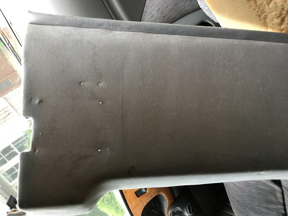

This is the fiberglass pillar after I removed it. The seat belt keeps it attached like a leash, so here it was twisted around the driver's seat into the front, trying to get it out of the way. It is upside down (when you click for the large version, here it looks sideways), you can see the lip on the right side of the image (which is the left side of the panel when it is installed). You can also see the screw holes where the LVD goes, and the short cutout at the top of the image (really the bottom of the panel) is where the wires from the battery compartment go into the pillar (at least in my Concourse, the battery wires came up through the floor, moved over 6" or more and then went into that cutout to get behind the pillar and up to the overhead). This is the wall with the corner panel removed. You can see there are 2 bundles of wiring, I think the one on the right was more cab-related and the one on the left was more coach, some coming down from the overhead (like for the water heater). This is the passenger side overhead, you remove various screws you'll find, and the dividers, and then you pull the back piece out, like you can see here (it is jammed pretty tight). This is the wiring behind it

Thanks Bob, your pics and information is exactly what I was looking for. The PO had a DC TV installed, but was plugged into 120 outlet with a power adapter, I need to get creative with connecting the different 12v barrel connectors for the TV to existing 12v already there. The Samsung LED backlit TV is name plated at 14 VDC, will it protest at 11.9 or even 11.7 vdc. ( guessing a bit of voltage drop, I don’t plan on regularly discharging batteries that low.)

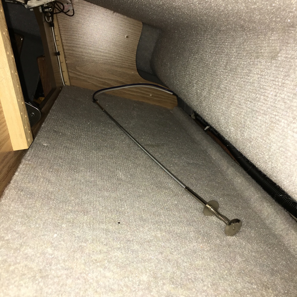

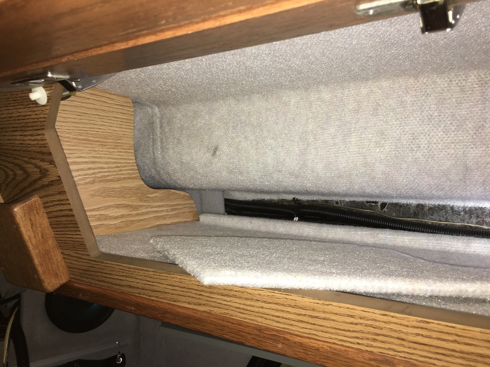

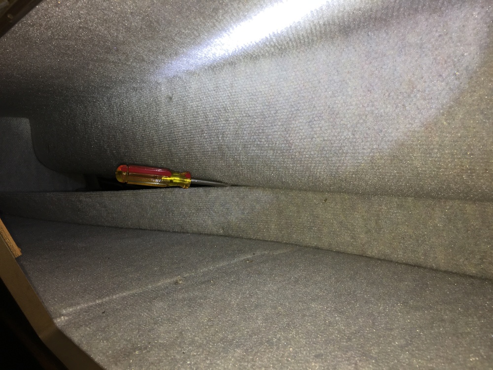

If you need more pictures, let me know, I've been behind almost everything when I was upgrading my wiring and have pictures for a lot of it (I sometimes forget until too late). Oh, word of caution, take plenty of pictures as you remove screws for the couch and that corner panel and take things apart - I didn't, and left it off a long while, and I'm not sure I ever got it back on exactly the way it's supposed to be
Did your Premier originally not have a TV or DVDR player of some kind - if so, there might be some left over 12V wiring in the front overhead (or possibly even pre-wired if there wasn't anything installed). Otherwise, you can add wiring from the passenger side lights around the corner to the front (when you open that chase in back, you'll see the wire conduit goes around the corner - in mine, I was able to just use a 2 foot long stiff wire to reach through that corner, attach the new wires (just bare wires, but there is nothing back there that really requires it be in the conduit), and pull them back through to the front). This is a picture of the tool I used - it has a plunger on the end that opens a little claw at the tip (I forget where I bought it years ago). In this picture I was pulling new wires up from the sink area below, probably not recommended, as the wires aren't being held by anything coming up the wall back there, but it's just 2 wires I needed and I did the best I could under and behind the sink area to support them and secure them.
