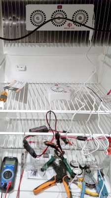

I recently embarked on another mission to enhance the performance of my Dometic RM3663 3-Way refrigerator by installing internal fans. After conducting thorough research I stumbling upon recommendations from fellow RVers, I decided to give it a shot and purchased a couple of internal fans to see if they would improve the cooling efficiency of my fridge. Today, I completed the installation and eagerly await tomorrow's test to gauge the impact.
The installation process itself was fairly straightforward, thanks to the accompanying images and instructions provided by the manufacturer. The fans were designed specifically for absorption refrigerators, and their compact size fit perfectly within the unit. The materials used felt durable, ensuring they would withstand the demands of the RV lifestyle.
The true test, however, lies in the performance. The internal fans are intended to circulate air within the refrigerator, aiding in temperature regulation and ensuring a more even distribution of cold air. If my initial observations are any indication, these fans should make a noticeable difference. In terms of potential future modifications, I am contemplating installing an external fan at the back of the refrigerator. This addition could potentially provide an extra boost to the cooling process and further enhance the overall performance.

Here are some additional images of the installation that was completed.
Regards!

Hello David, I greatly appreciate the information you provided. Prior to your suggestion, I was unfamiliar with JC Refrigeration. The reason I opted for these fans was due to their low amperage per fan (0.2A) and their quiet operation as brushless fans. Considering I have a total of four fans, with a combined current of 0.8 amps and a voltage of 12 volts, the overall power consumption amounts to 9.6 watts. This level of power consumption should not have any adverse effects on the MICRO P-711 board, especially considering it is equipped with a DC 5 amp fuse. Furthermore, I've been exploring the idea of replacing the incandescent bulb with an LED alternative, as this switch is likely to reduce the overall amperage usage. In terms of the installation of external fans, one of my concerns is ensuring the protection of the 12-volt circuit while also taking advantage of the 5 amp fuse on the P-711. I am considering piggybacking out of J2 on the board. I would greatly appreciate your thoughts and insight.

To put the theory to the test, I decided to assess the effectiveness of the internal fans I installed in refrigerator. These fans are designed to circulate air within the refrigerator, contributing to temperature regulation and ensuring a more uniform distribution of cold air. At 12:00 PM, I switched on the refrigerator using propane, and at that time, the internal temperatures stood at 77 degrees Fahrenheit.
After two hours of operation at a setting of 4, I measured the temperatures in the freezer and refrigerator compartments. The freezer reached around 47 degrees, while the refrigerator showed a temperature of approximately 61 degrees. Admittedly, I did not capture the readings with my Remote Digital Wireless Fridge and Freezer Thermometer, as I was already contemplating the addition of external fans.
Curious to see if the installation of external fans would yield any improvements, I connected an oscillating fan to the back of the fridge and rechecked the temperatures at 7:00 PM. To my amazement, the freezer temperature dropped from 47 to 8 degrees, and the refrigerator temperature decreased from 61 to 48 degrees (images available below). Although this experiment lasted only 5 to 7 hours instead of a full day, the results indicated that my refrigeration goals could be met with the help of external fans.
Based on this small test, it is clear that both internal and external fans contribute significantly to maximizing the efficiency of my over 20-year-old refrigerator. Therefore, I have decided to proceed with purchasing the external fans this week. I intend to provide an update after their installation to share the overall impact on the refrigerator's performance.
In conclusion, my experience with JC Refrigeration and Dinosaur Electronics has been positive thus far. Their responsiveness, expertise, and willingness to explore alternative solutions have instilled confidence in me as I seek to improve my RV refrigerator's cooling capabilities. I look forward to the installation of the external fans and the subsequent positive impact on my refrigeration system.

M_Mincey, to be a viable test you need to let the temperature of the fridge and freezer stabilize before adding the fans. These 2-way and 3-way fridges take many hours to get to their normal operating temps - much more than 2 hours. I'm not even sure you reached normal temps for your fridge by 7pm, certainly the fridge at 48 degrees makes me think not (unless you're having an issue with the normal operation).
When I start up my fridge after the RV's been in storage, I always turn it on the night before. Then when I'm ready to start packing and loading the fridge in the morning, it's been at least 12 hours.
I do use internal fans in the fridge, but it is a difference of only maybe 3-5 degrees at most. The best thing the fans do is to circulate the air and keep the temperature more even over all the food, especially when the fridge is full. I find it also helps a bit with the metal fins icing over less. I have never found the freezer to need a fan - it is small enough, and always operates more efficiently than the fridge section, anyway. I also have never really found the need for external fans, though I do tend to avoid areas that are above 90 and humid.
