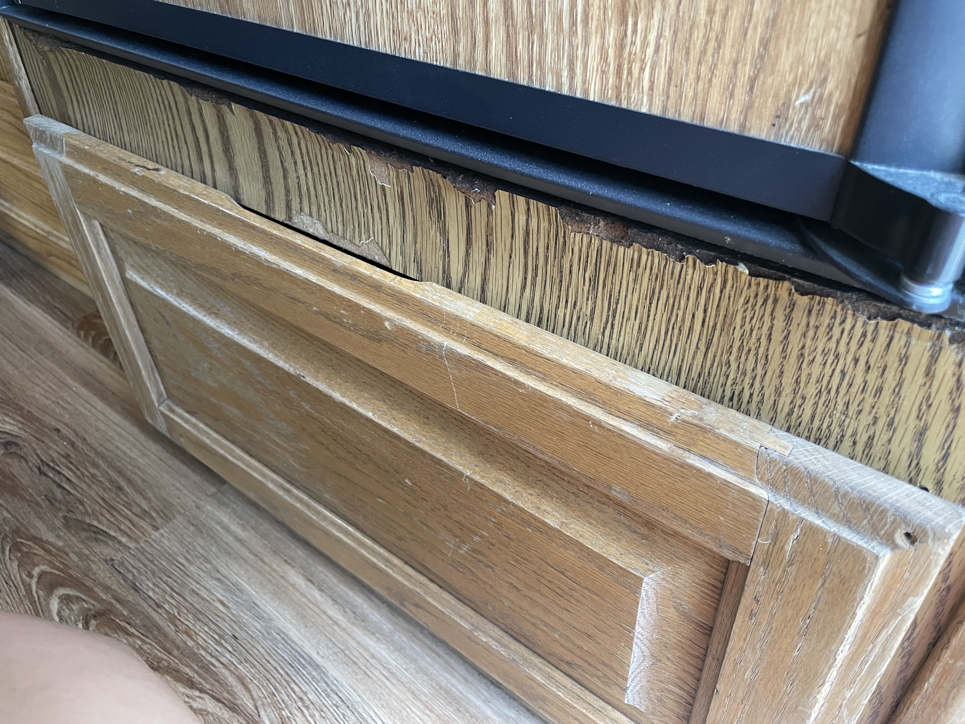

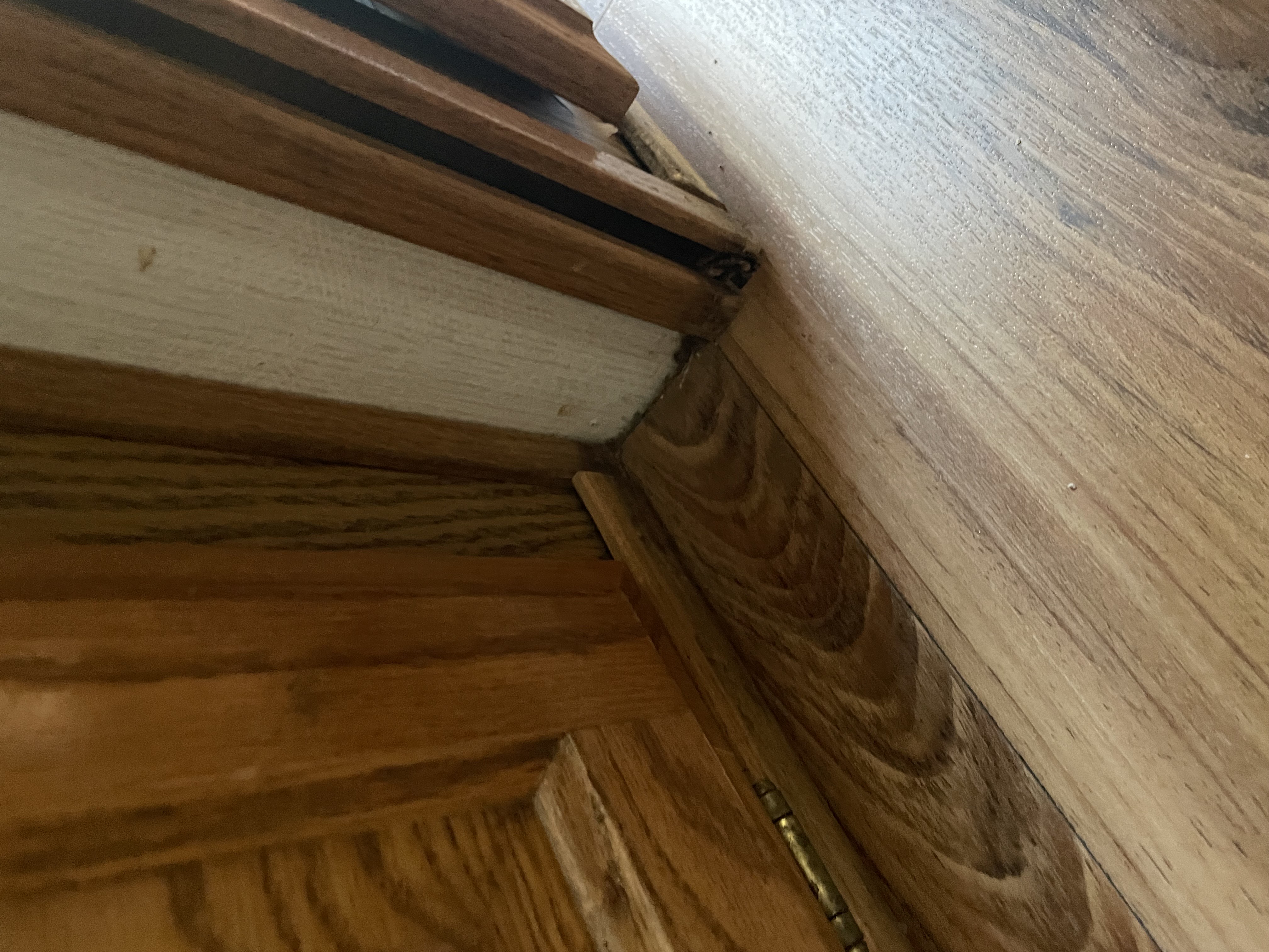

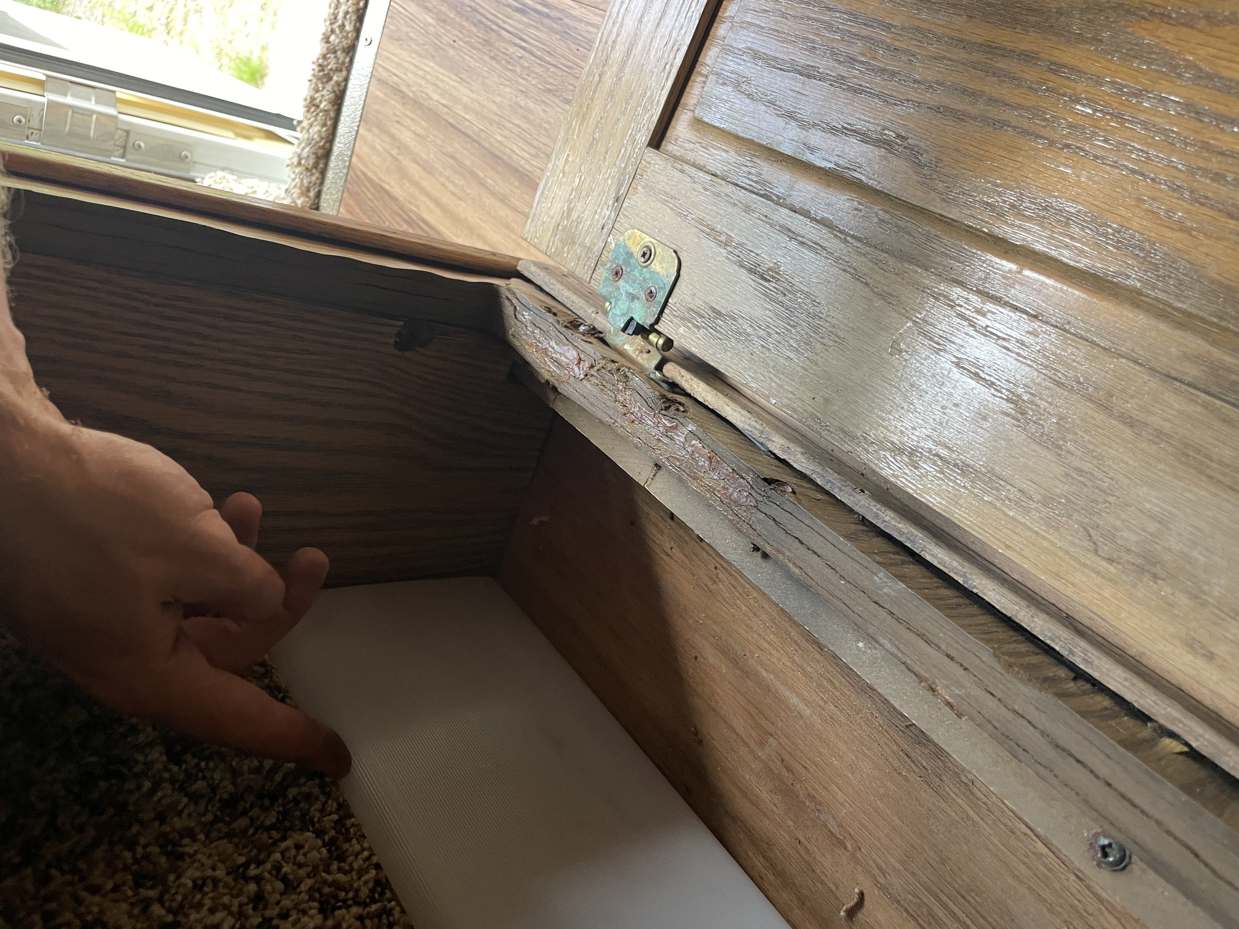

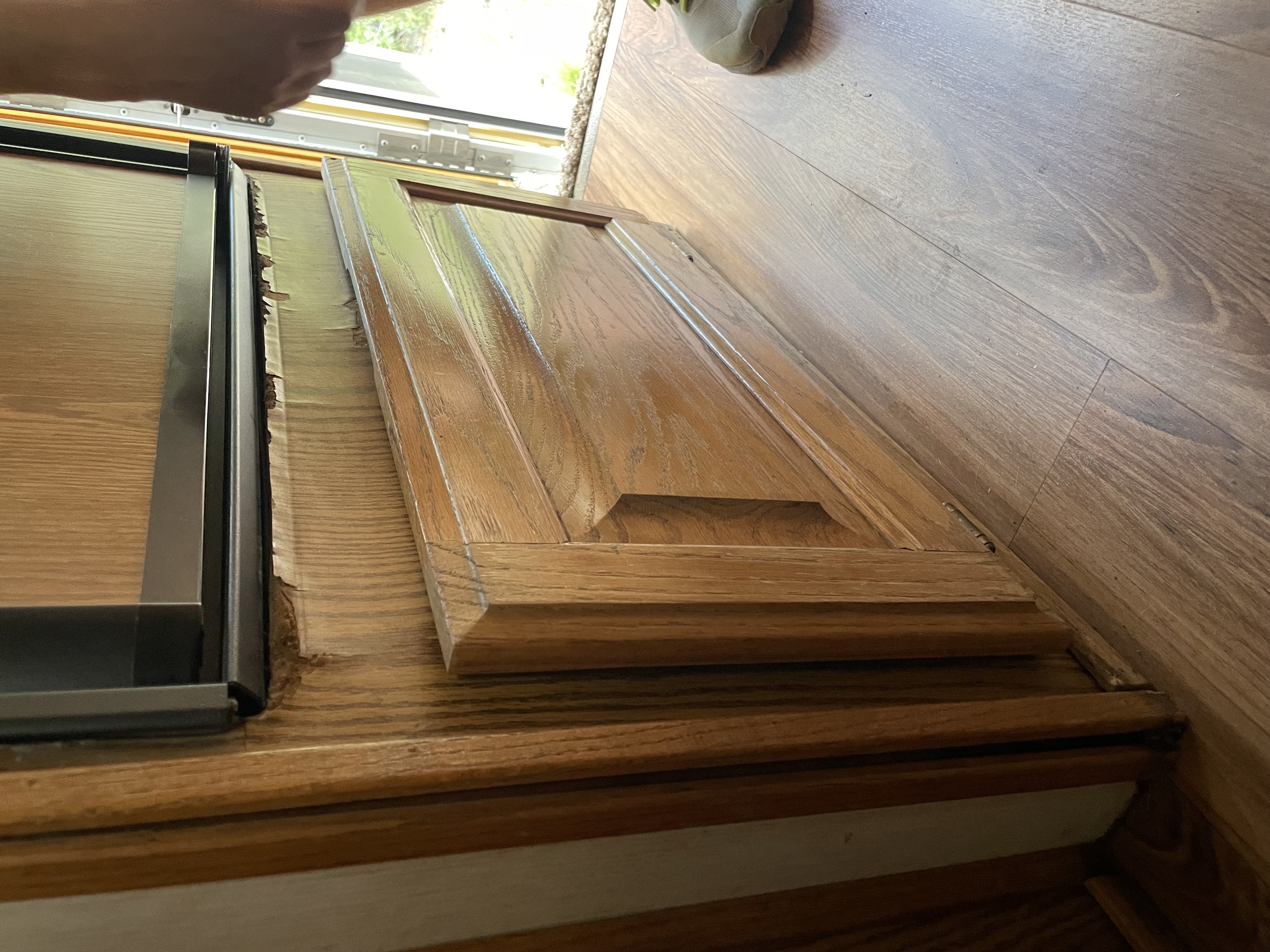

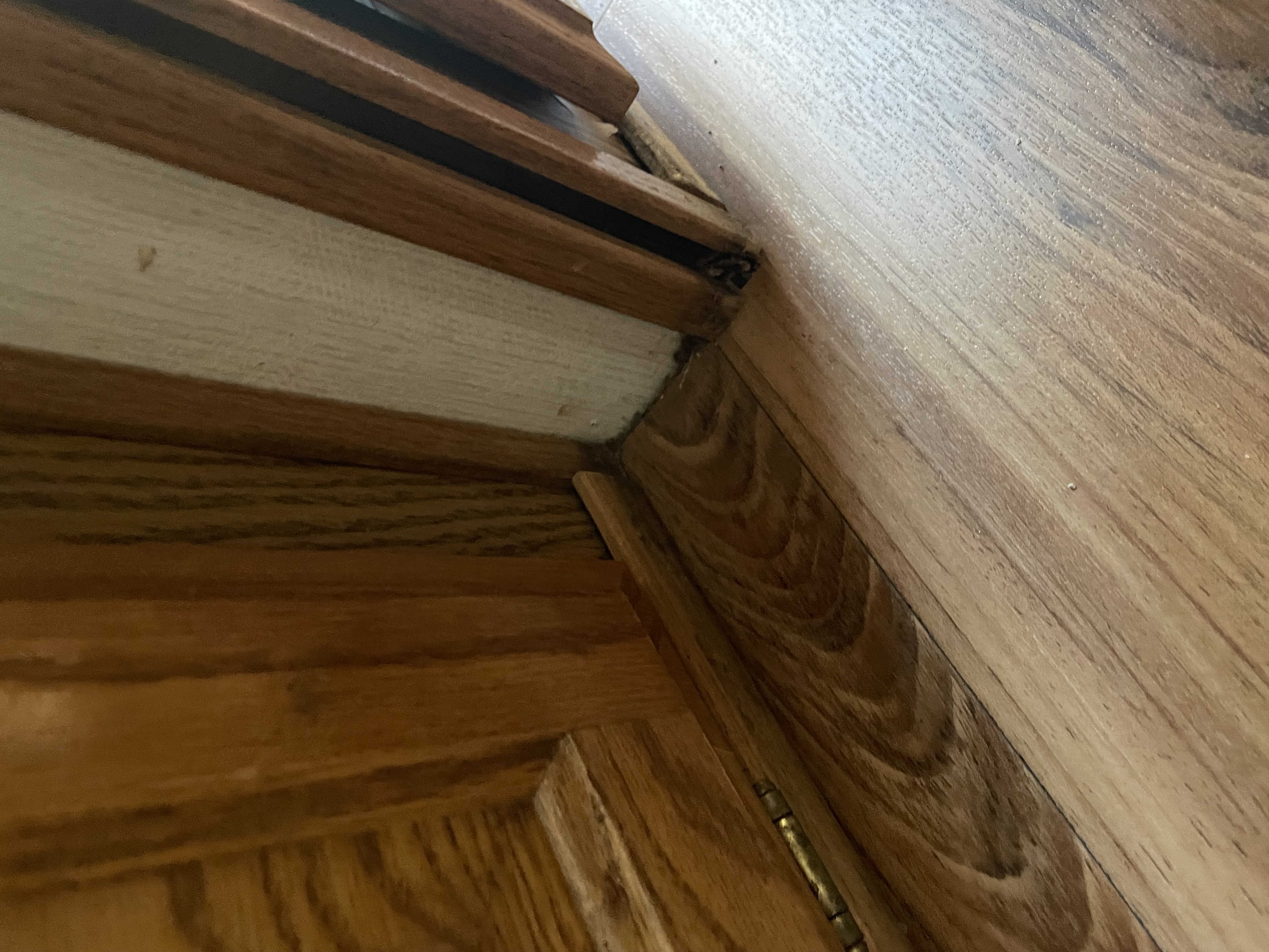

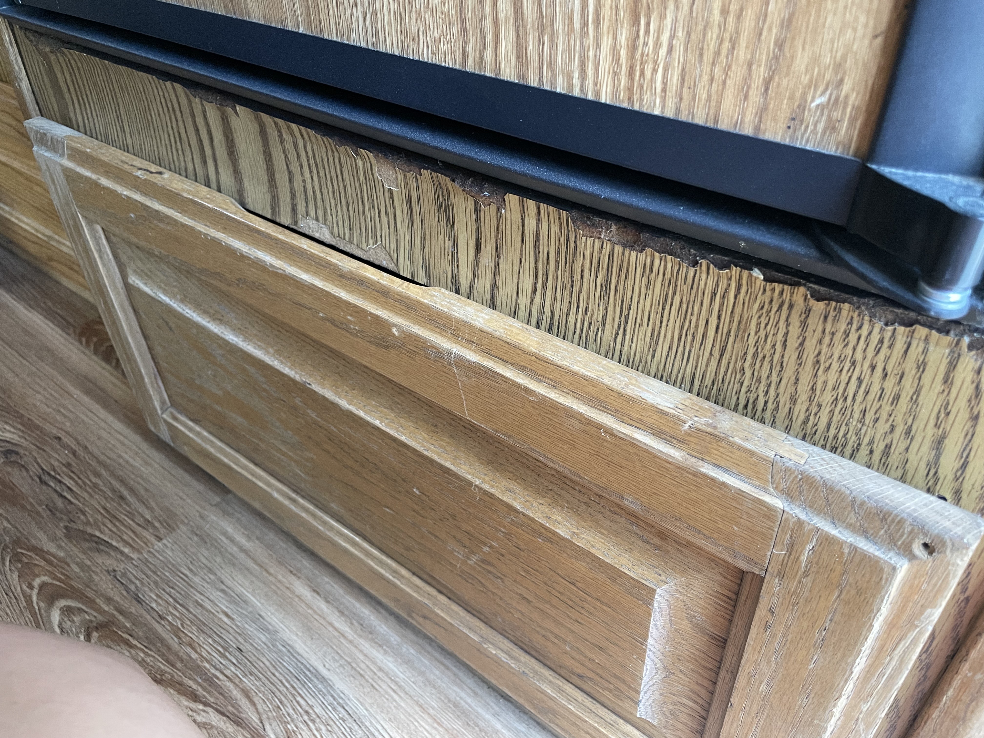

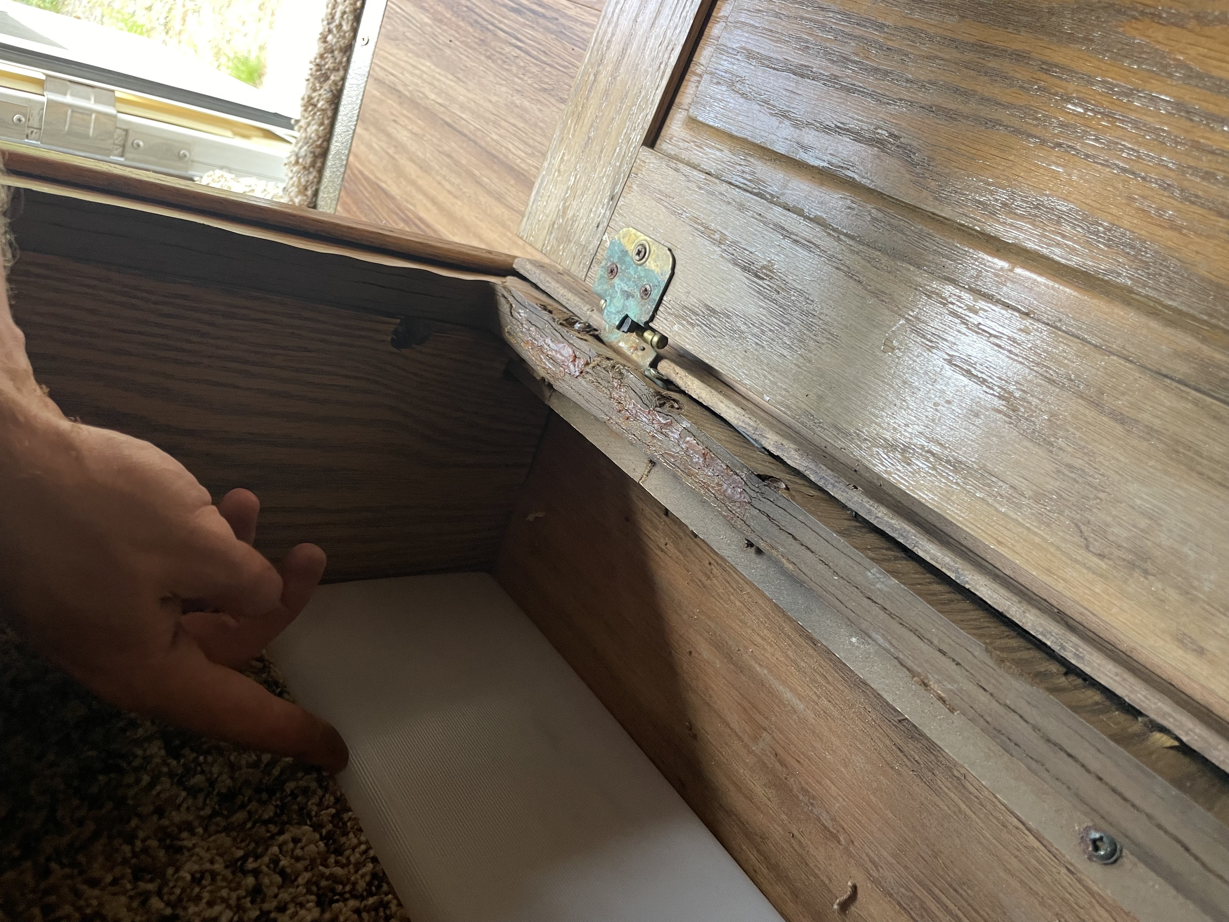

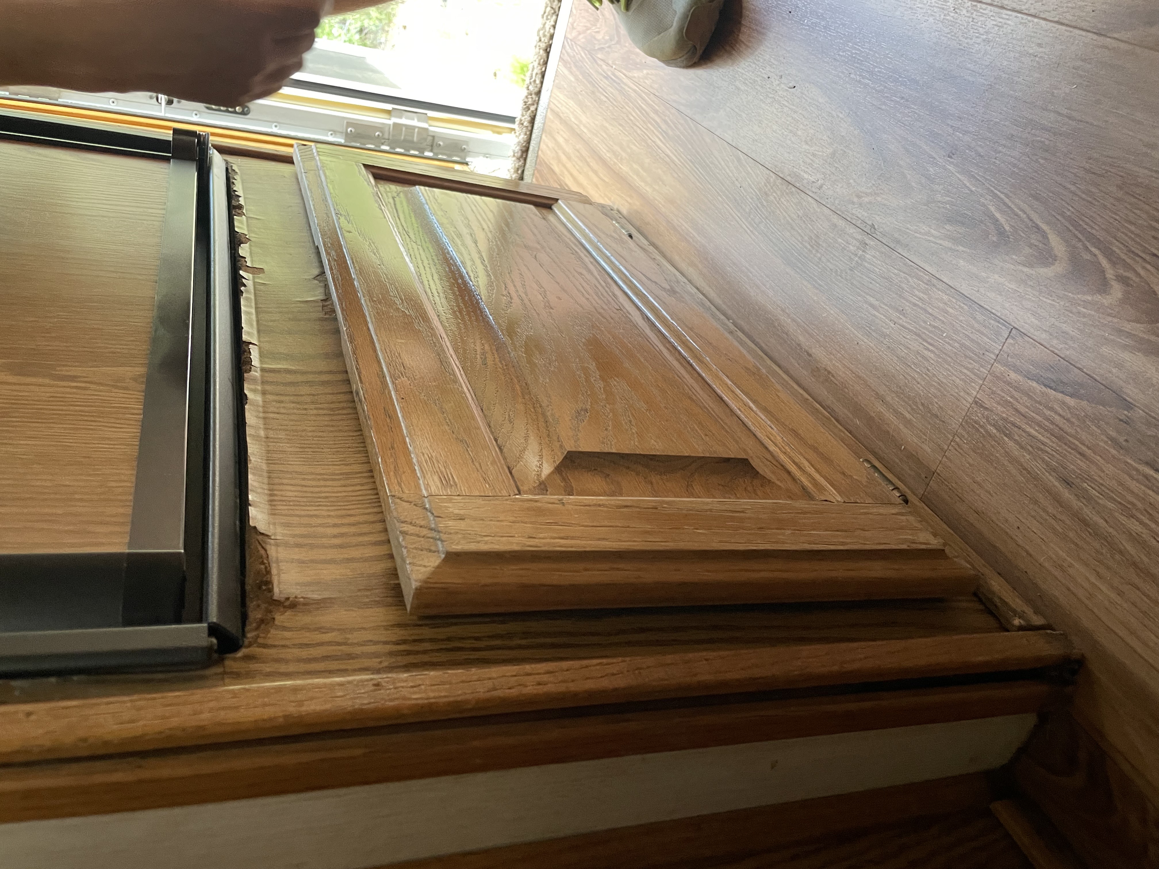

Water damage below refrigerator
Looks like the fridge dethawed into the RV. I don't know what is below the floor but I'm worried whatever material it is, it'll need to be replaced. I've attached images. I think I'd have to pull out the structure which houses the fridge. Pull up the flooring. Then I have no idea what's below that flooring but it could be water damaged... Anyone have any idea what's below there and what it could take to repair if it has water damage?

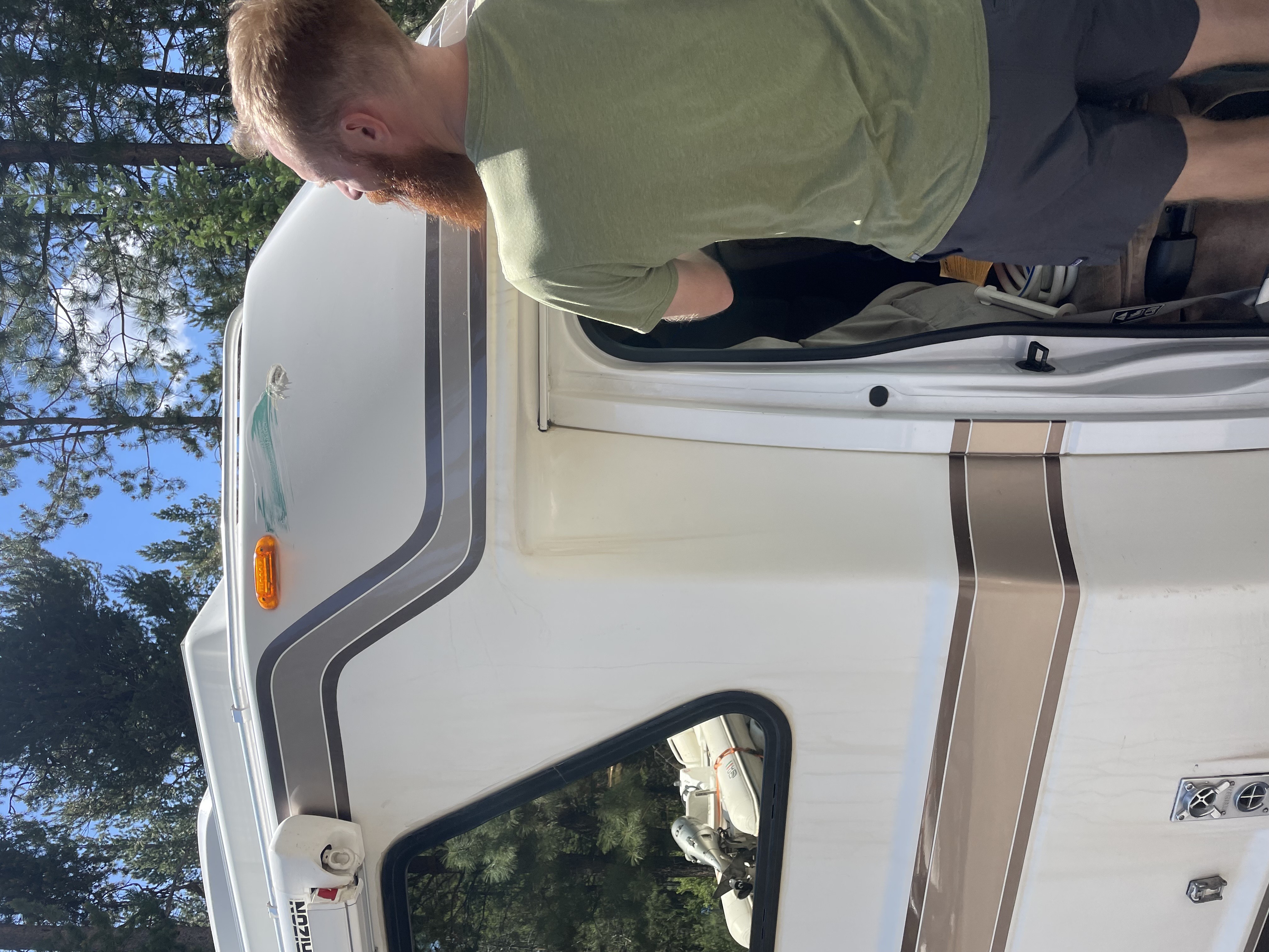

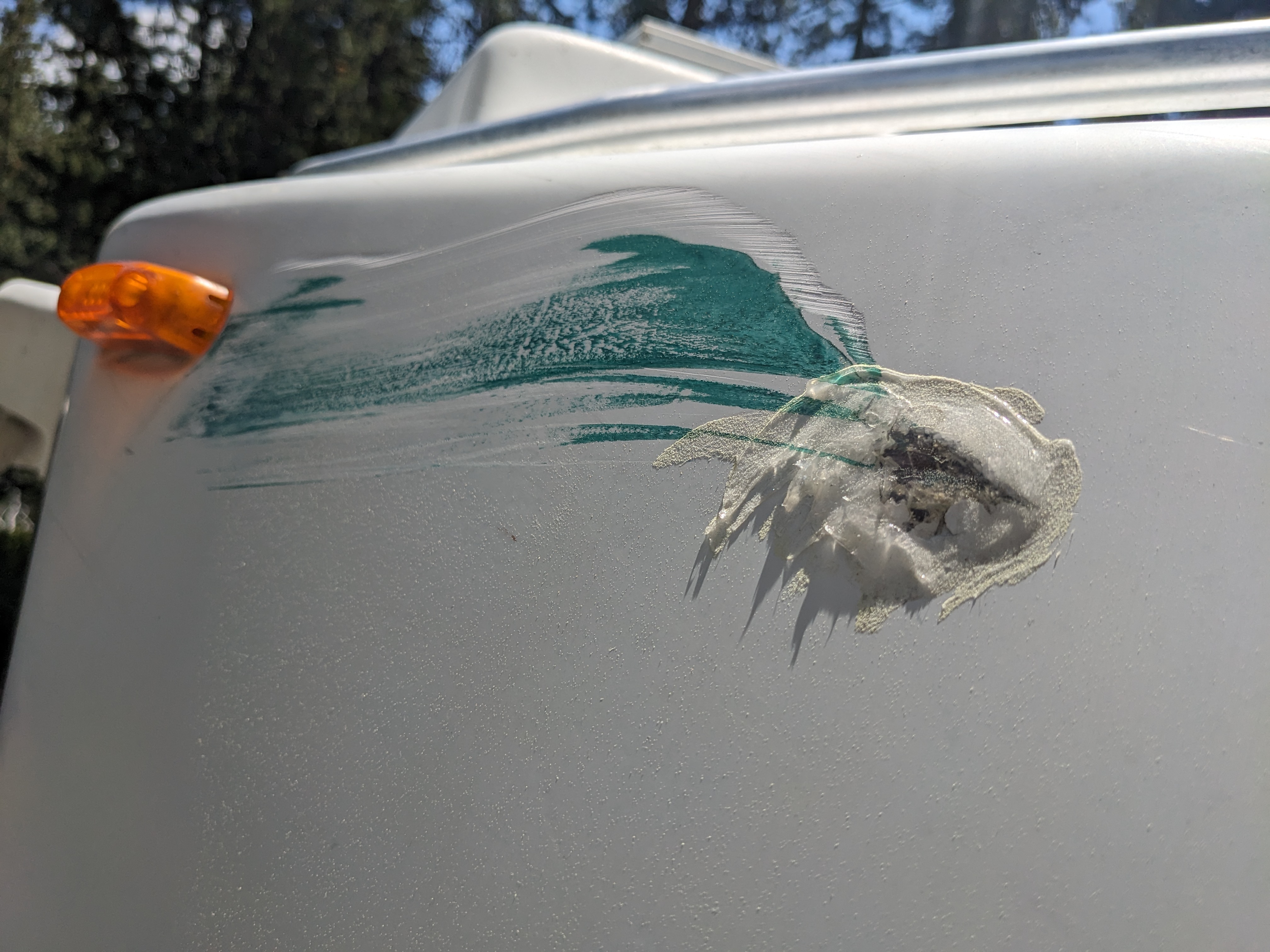

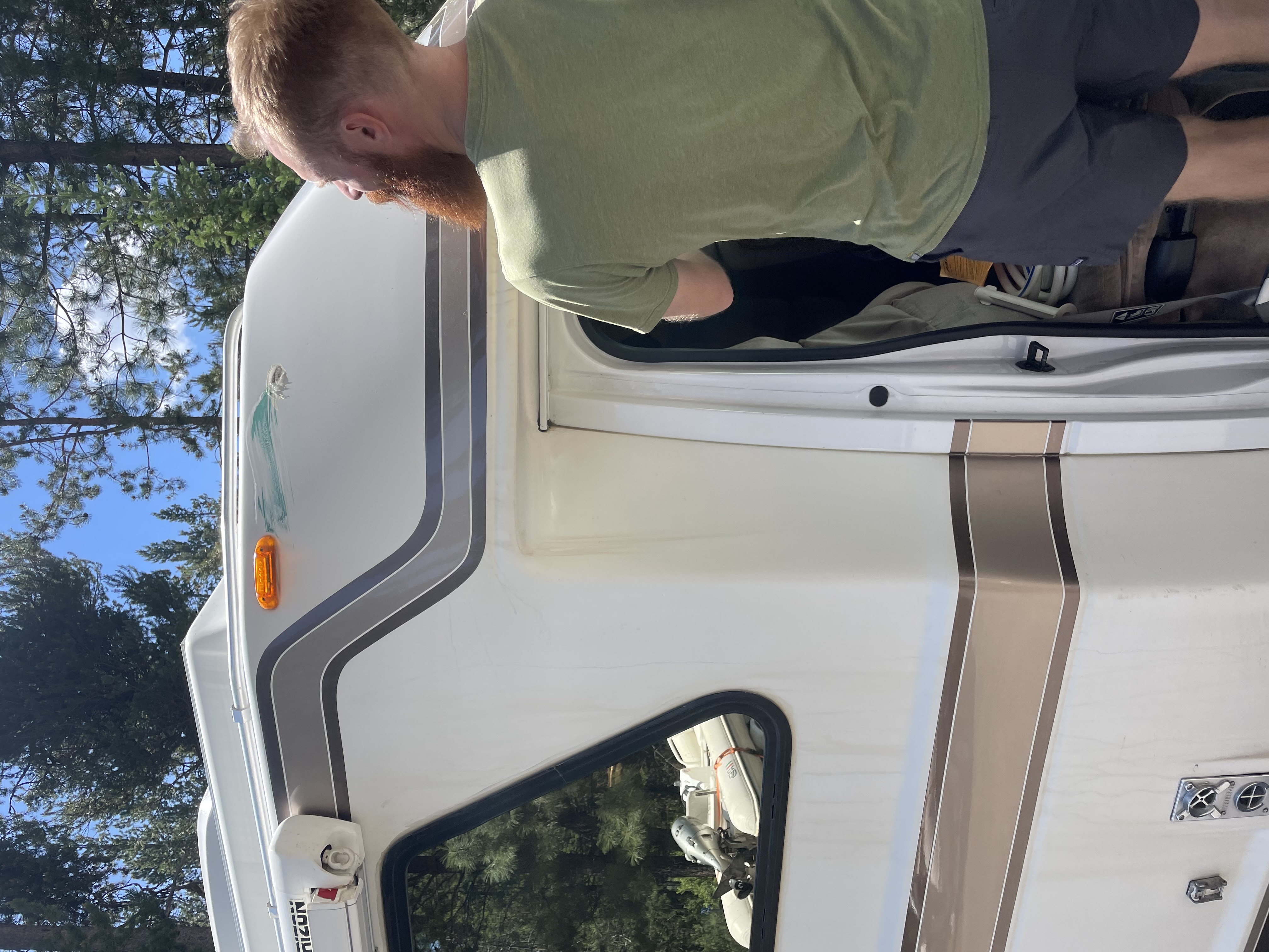

Gouge in fiberglass shell
There's pretty substantial gouge in the shell. He clearly hit something. I'm not sure how wide spread the delamination goes in the composite shell but assuming I'll have to have someone cut that out and patch it up.

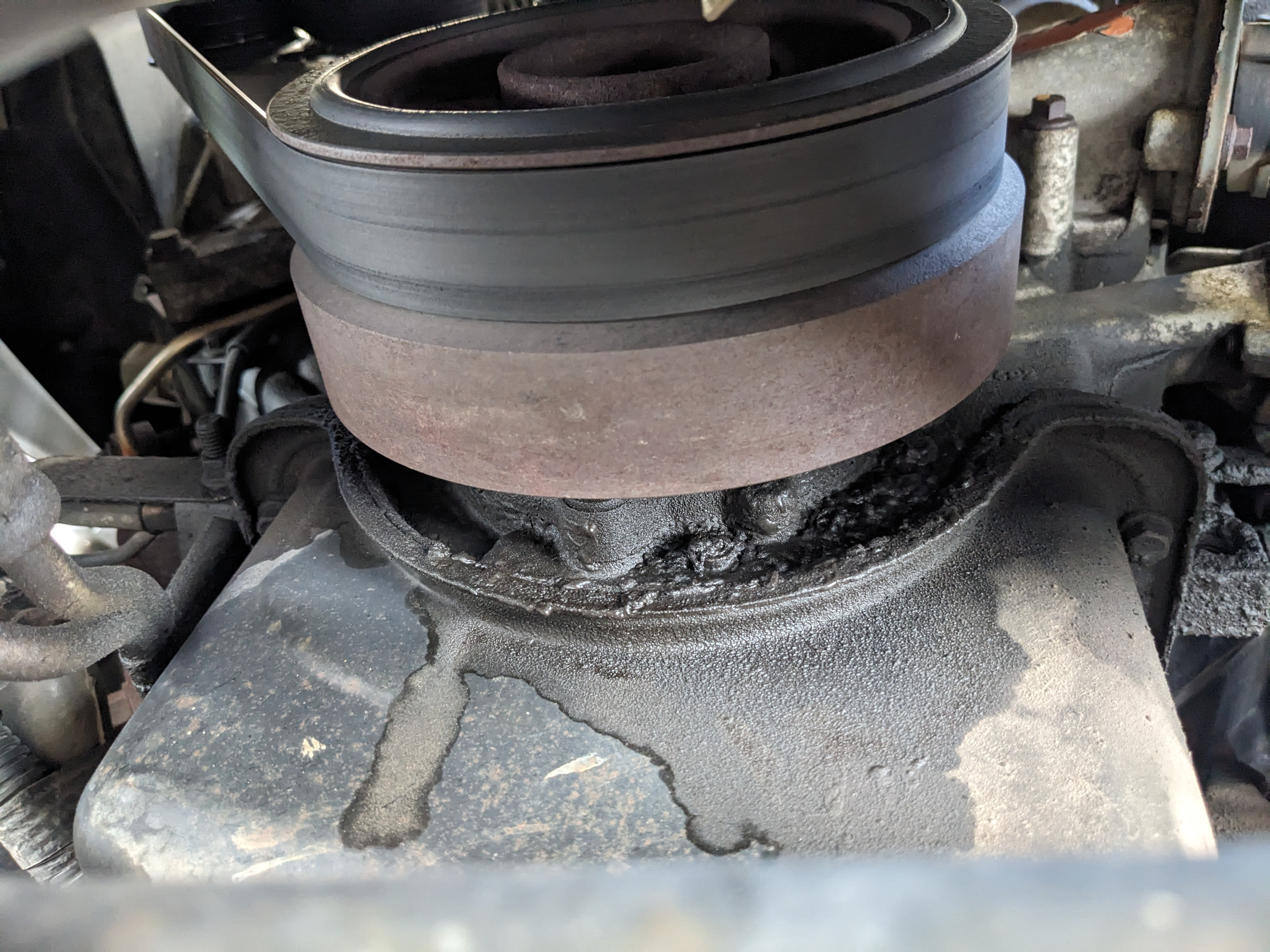

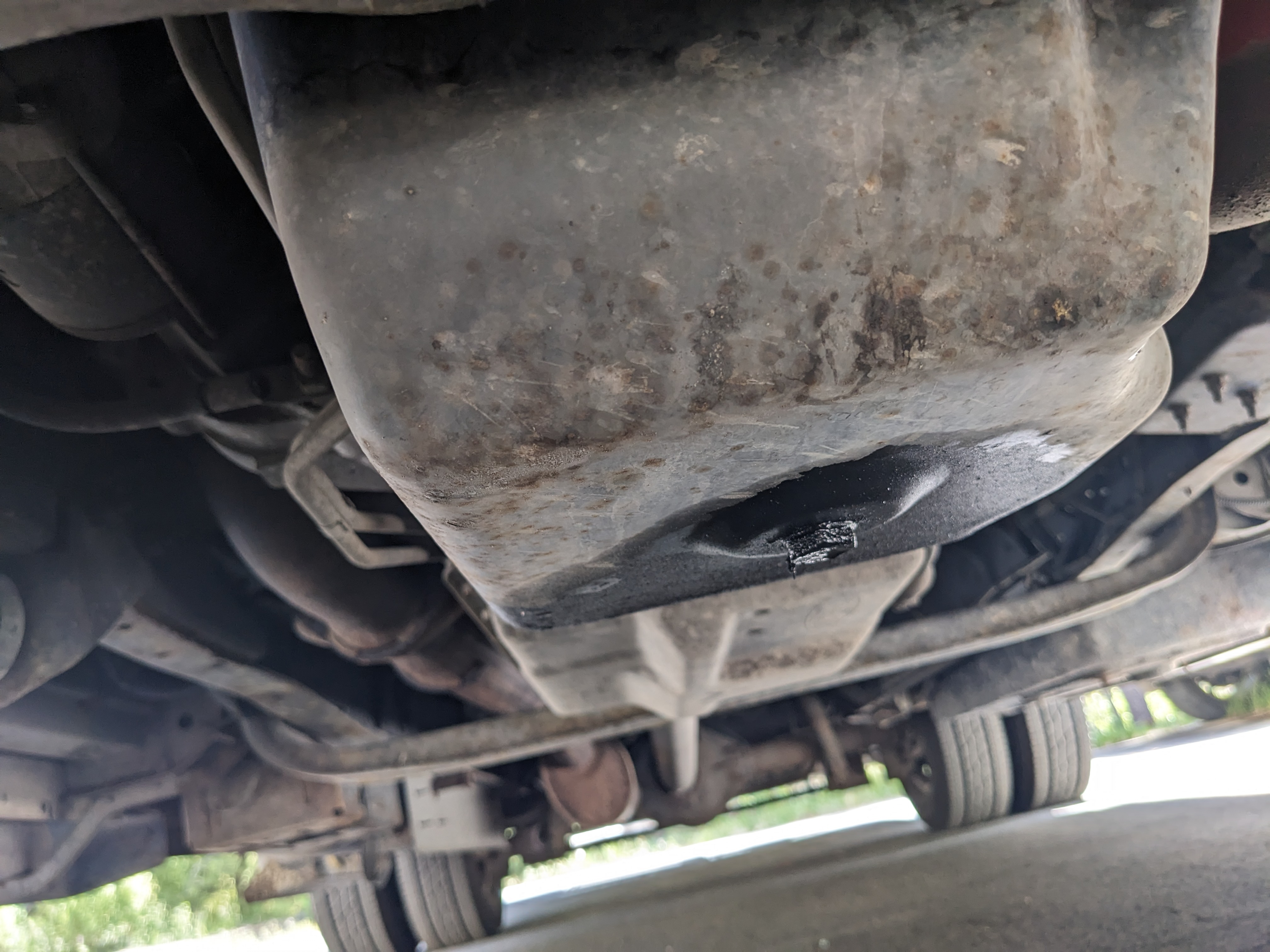

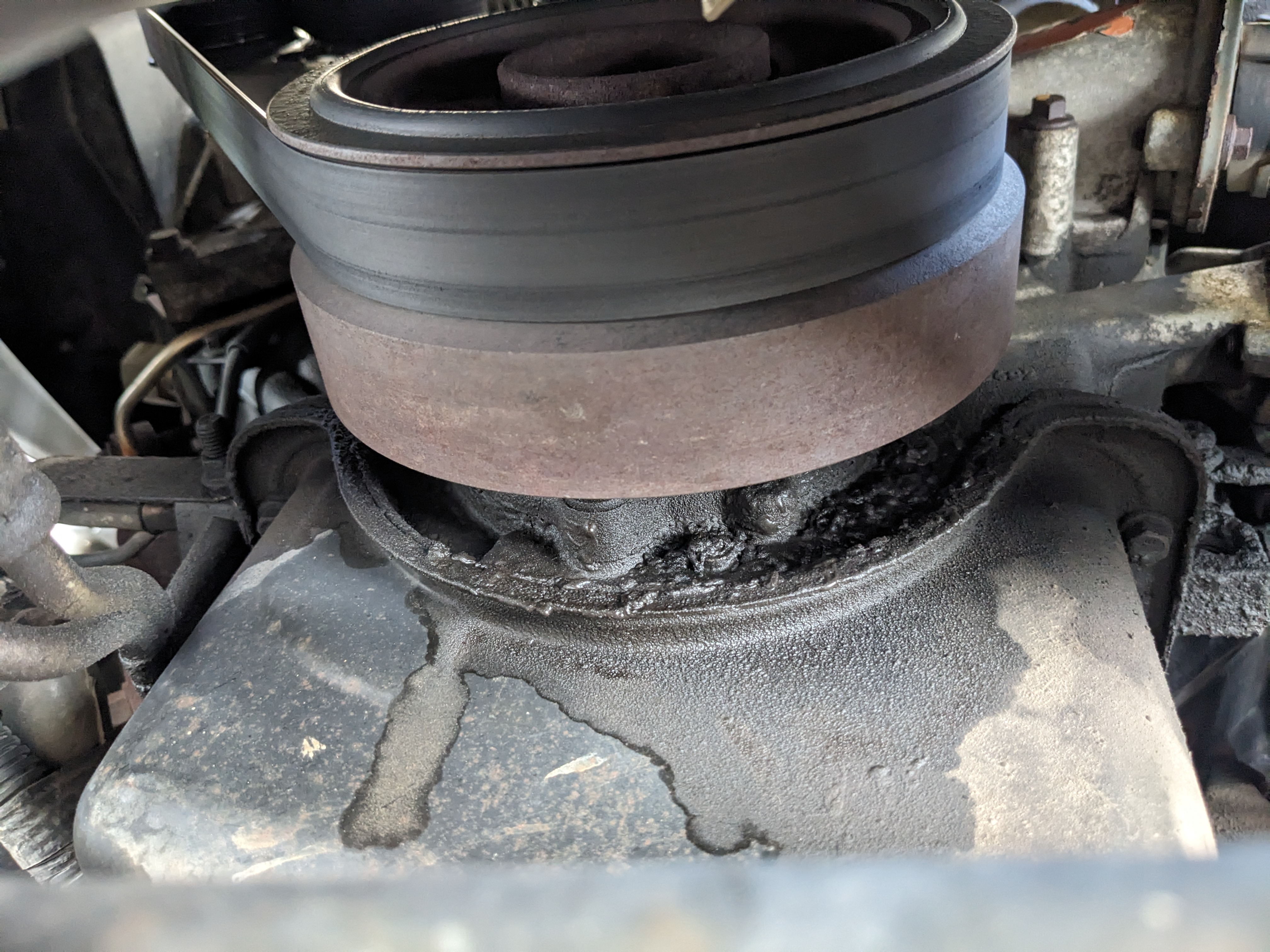

The engine and drivetrain are not looking great either. Lots of oil leaks. Starts and idles but wobbles with any increase in throttle.

The water damage does not look that bad, but it is difficult to assess until you start to rip thing out, and open up the can of worm. For some people, diesel is a big plus, but consider the condition the drive train is in, I do not know if it is worth your time unless there is a substantial discount in the asking price. Have you been looking at other RVs and see if you can wait for rig in better condition to show up?

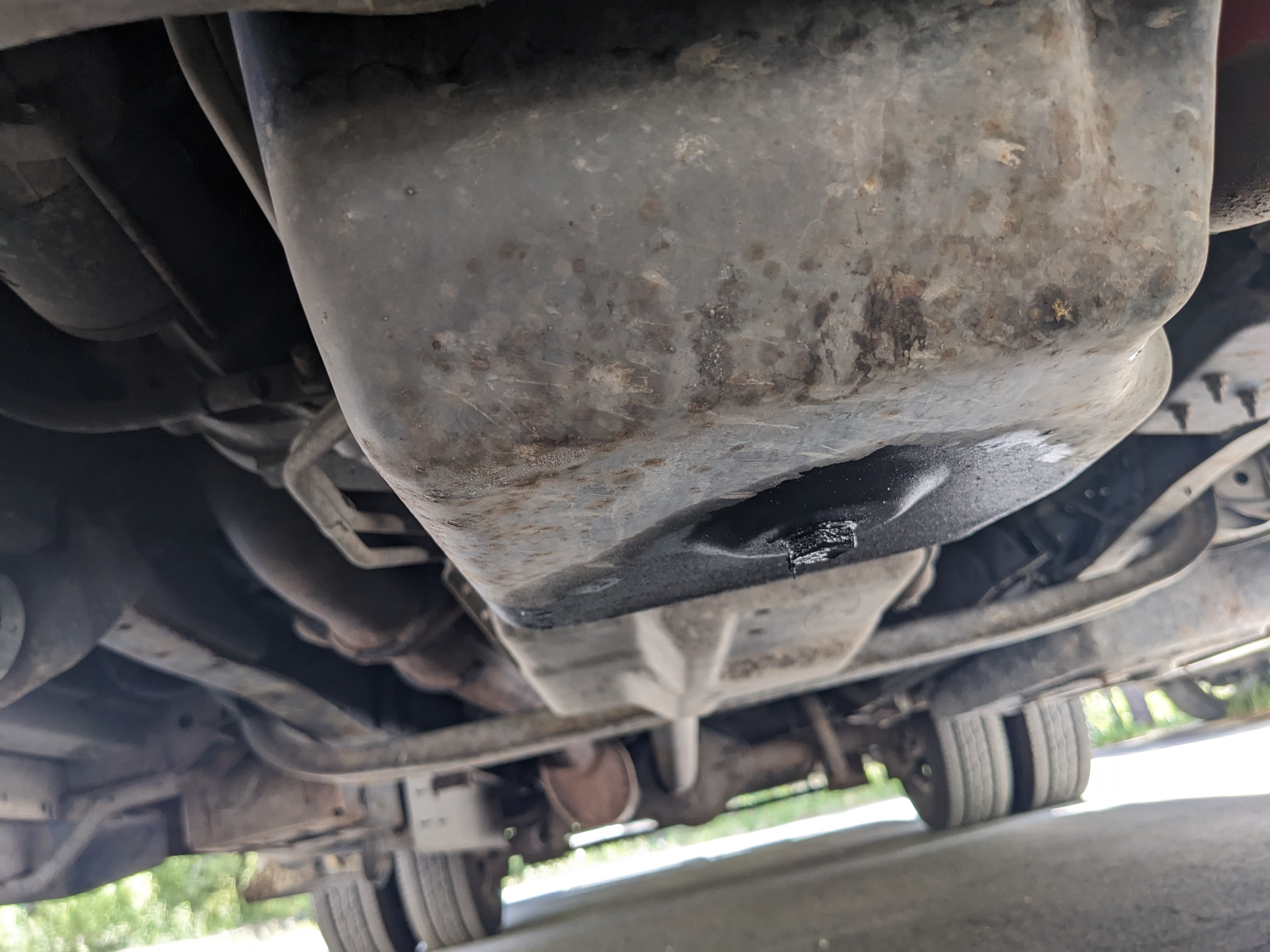

I'll attached pictures of the fiberglass damage here as well as some leaking from the oil pan.

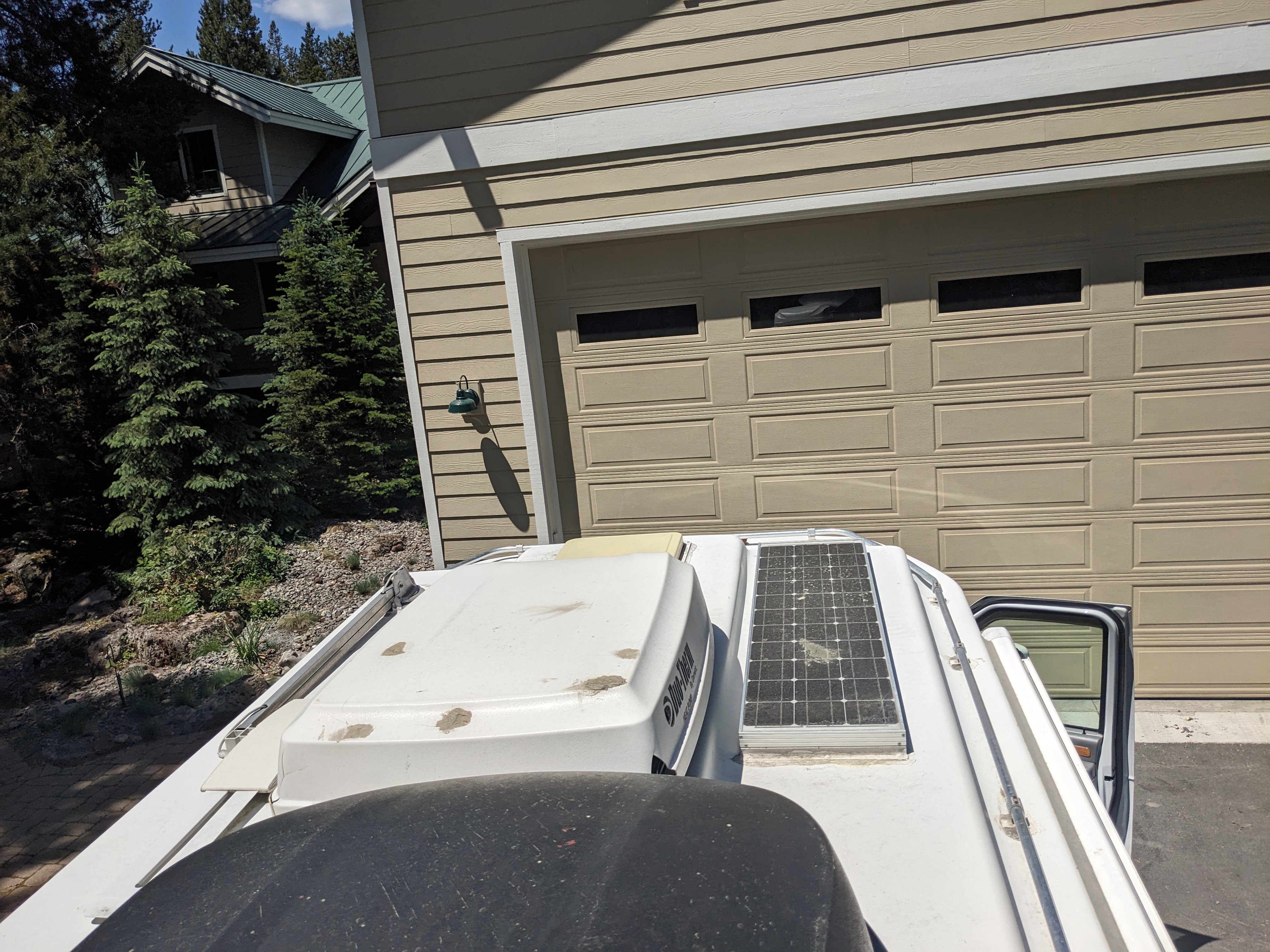

I've called around a bit and got very loose estimates for engine work and fiberglass repairs. I'm thinking this should be selling for closer to $25k... I don't know tho... Any chance you have an opinion on the price reduction? Also noted that the AC unit is cracked, look slike he hit something up top as well. This scares me because I'm hoping he didn't cause delamination up there as well.

Water damage under the fridge is common. It usually enters through the lower exterior fridge vent. It's discussed here in other threads if you want more information. Looking at the corrosion on the hinge, I'm guessing this is not recent water intrusion. What's shown is not terrible, but the sub floor might be another story. The haunting question: Is there other damage that you can't see? There are a lot of places to hide in RVs.
Fiberglass can be repaired to look a lot nicer than what is shown. I wouldn't be too concerned as long as it's water tight. That particular spot faces a lot of wind and wind-driven water while driving, so it's important to have it especially robust. At least it's not hiding.
Diesels leak oil, so that's not a huge deal either if it were me, going by your pics. A lot of people love the 7.3, so you'll be competing with them on price. The 7.3 is a fine powerplant, but you really reduce your shopping options if that's the only motor you'll accept. And you'll be paying way more for a Chinook of otherwise equal value.
