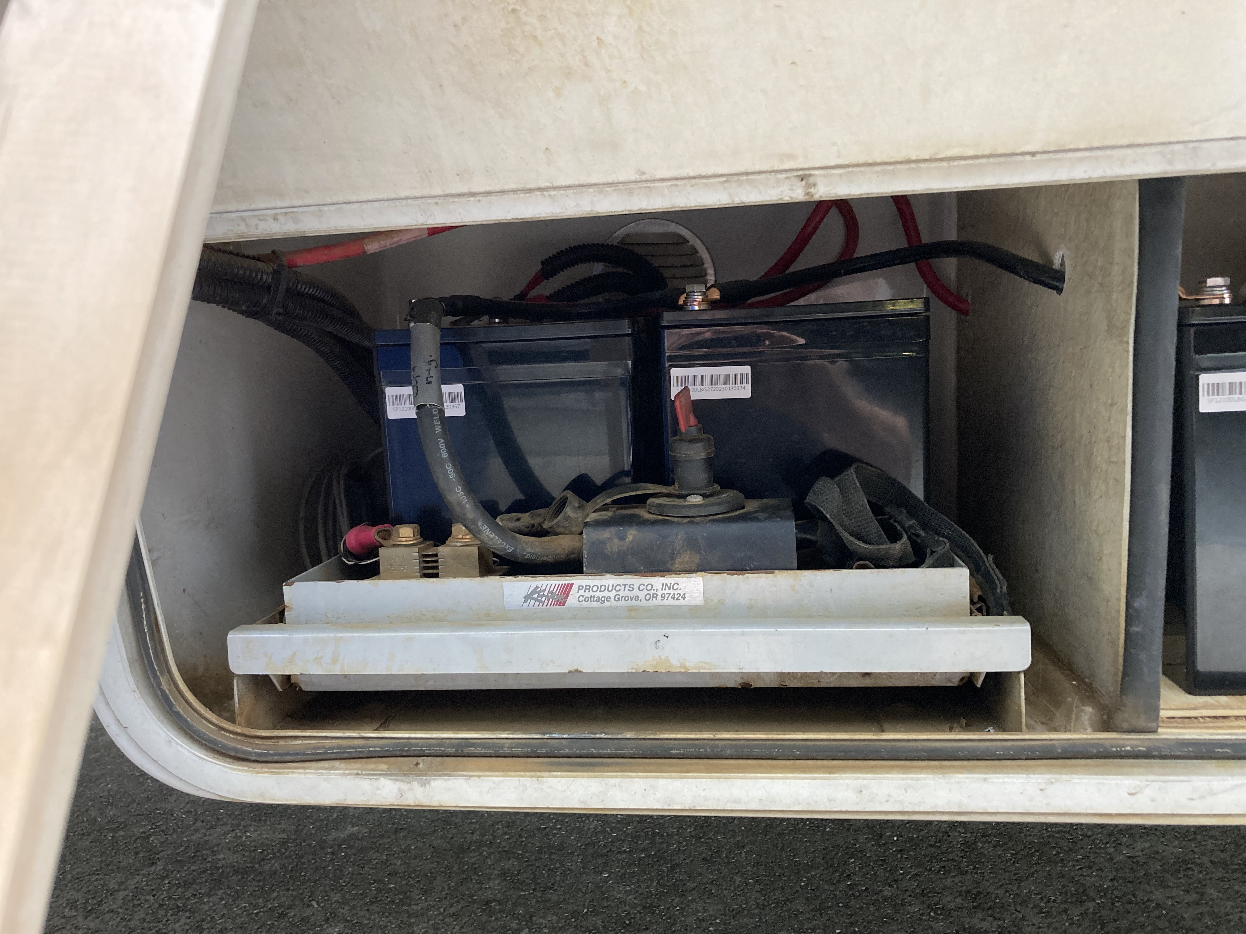

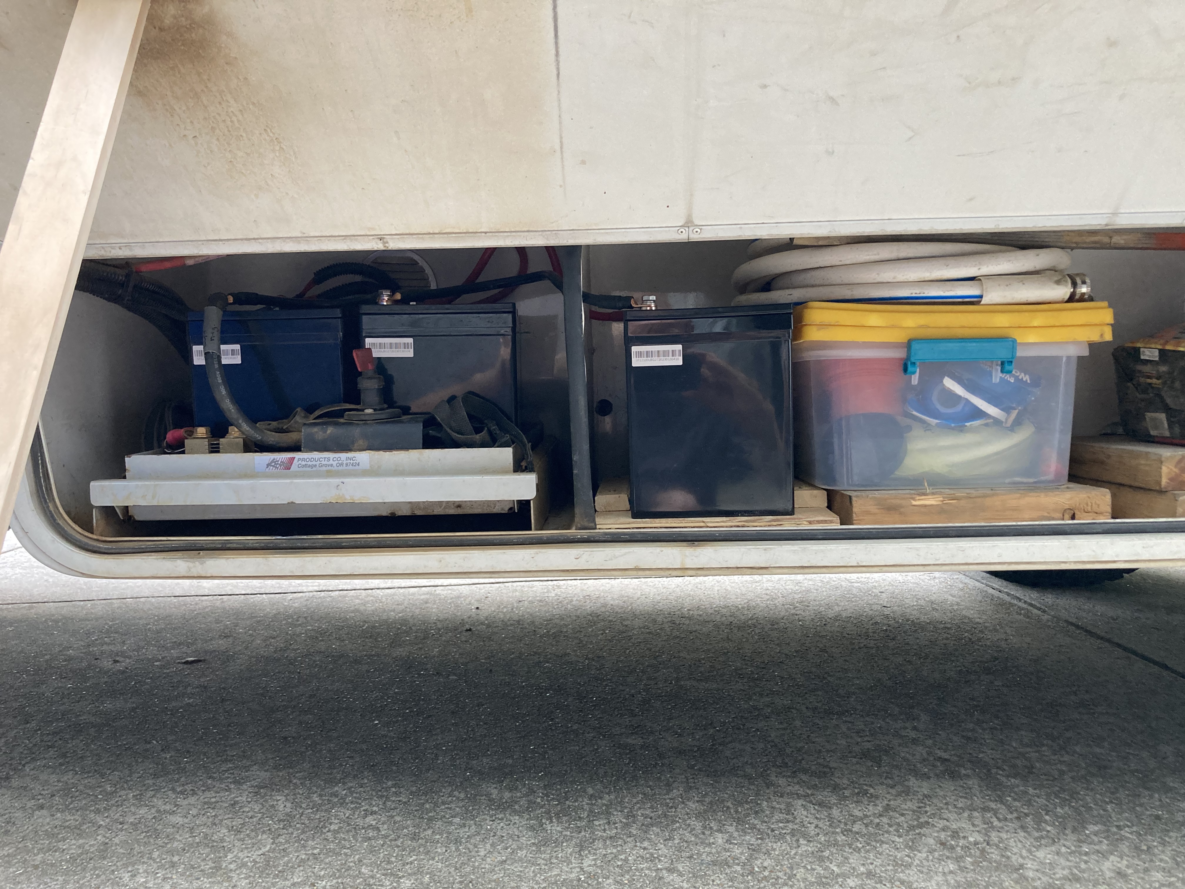

Here are pics of new battery bank.

Anyway, you may want to describe or take picture of your cable setup, since the connection you said above sounds not quite right... We want you to get a good night sleep instead of worry about if the battery going to melt the wire and made you stranded at your camp.

The thing in Camaro's second picture is a shunt (in front of the left battery). It's a precision resistor that diverts a tiny percentage of current. That diverted current is measured for voltage delta against system voltage to estimate how much current is going though the main circuit. In a bidirectional application, the amount of power going into - or out of - the battery can be quantified, thereby providing a SOC based upon the bank's capacity. This value can then be displayed passively as a percentage.

I think the shunt in Camaro rig is for his current meter (ammeter, which is actually a voltmeter that measure the voltage drop across the shunt). Some sophisticated digital meter does count the electrons via the ammeter, and use that to calculate the SOC, but all analog (and most digital) SOC meter is just use the voltage as an indicator of the SOC.
