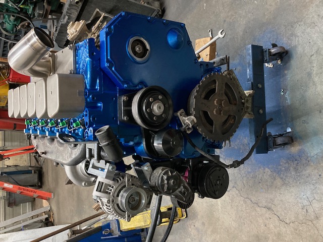

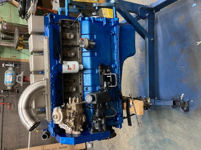

now that the mock up engine is out i have finished up most of the the welding, engine is together and should be shooting paint on it today

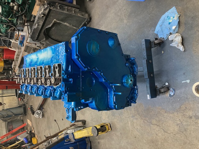

first coat
1995 chinook concourse soon to be cummins power

getting dressed up

Posts: 614
Re: 1995 Chinook major makeover
Looks mint!

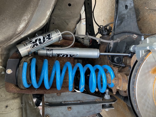

my front shocks showed up so got one installed

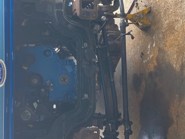

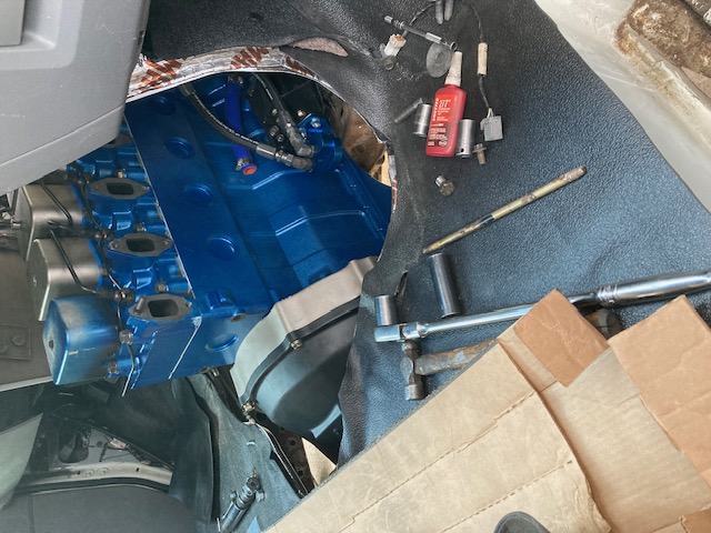

getting the last few things done under the coach before putting the new heart in, mostly wiring the abs sensors into the new harness, and stripping out the 2010 harness of wires not needed, i will be dropping out the fuel tack to modify the pick up by removing the fuel pump, and changing the filler to a diesel one( the hole is bigger for the bigger nozzle.

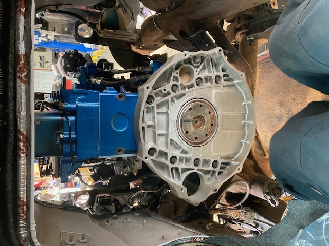

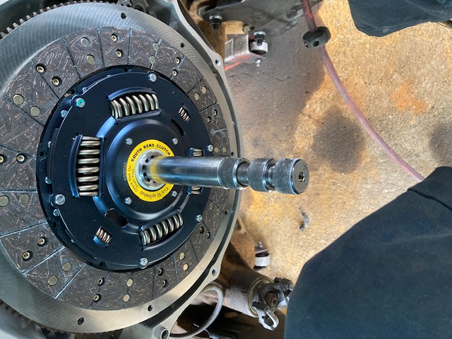

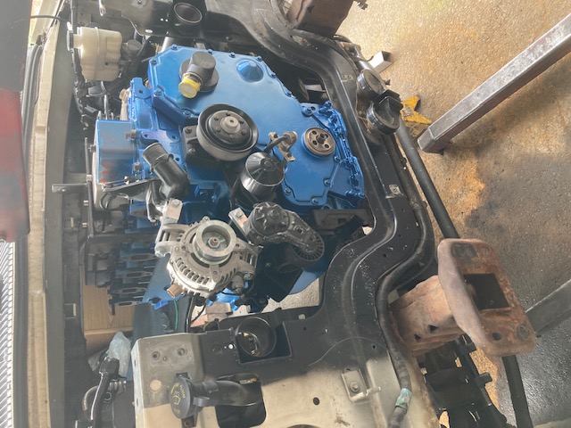

engine is in and will get busy hooking it up, been a long 6 months (longest project i have had) but i can smell the finish line, should be just final assembly as everything has been pre-built with the core engine. first time installing a clutch from the cabin area

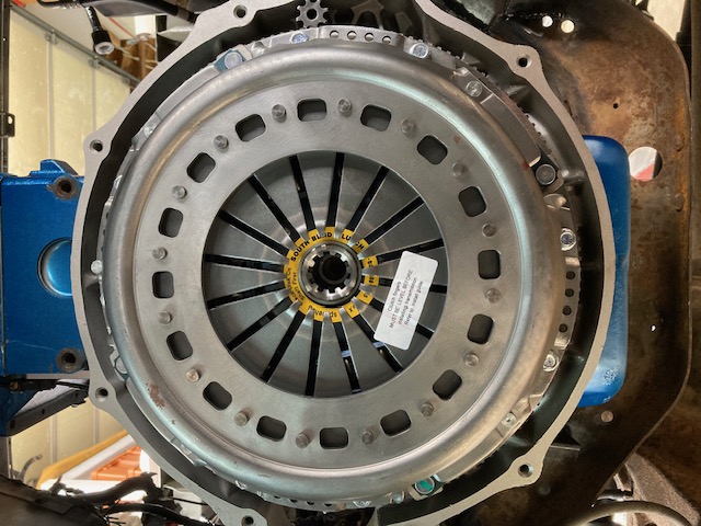

couple more

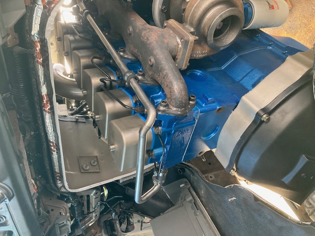

rear coolant line is complete 3/4" stainless tube necked down to 5/8" heater hose
