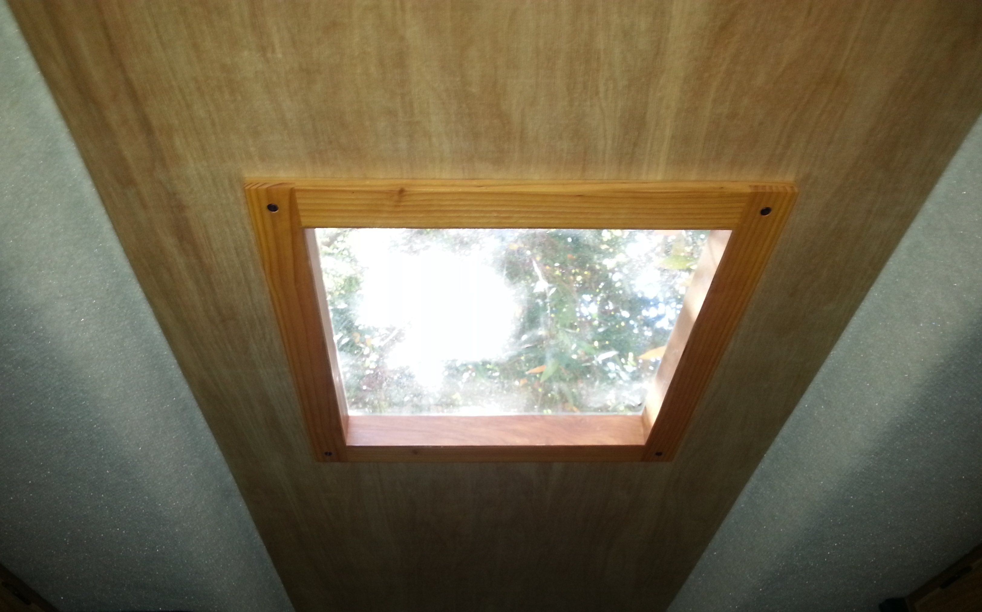

Finally made the wood casing for my skylight. I tried a couple methods not involving visible fasteners, but they were failed experiments since they weren't secure enough. I wanted this piece to be reasonably easy to take down and reinstall like a typical garnish, so this is the final outcome (for now lol). Window area is a little under 14 inches square.

Nice! What kind of wood is on the ceiling, btw?
Re: "Skylight" for standard 14"x14" roof hole (removed Air-c
I can't say for certain. Out of the 5 main categories of Lauan, and with tremendous variation within a given category, I'd guess it's Balau. It's not porous in this case, and it has a nice light appearance. I got it at a local independent yard. The trim is Montana Blue Pine that I salvaged from a friend's home-milled stash (it's not red as it looks in the pic).

Nice!! My Fantastic garnish (adapted to the skylight) is looking a bit ashamed
And, yeah, it's hard to beat the security of screwing into the (carpet covered) inner fiberglass liner. But nothing wrong with a screw where you expect it (corners of frame), IMO. It's not something you'll decide to move and leave random holes.
But wait... do we know about that overall wood liner you've put up? Did I forget or miss that? Must know more! On the topic, does your rig have a little extra thickness (like 1/2") in places? Mine has something like a built-down pad (this is all under the carpet) from the AC on forward (so AC, forward light, and fan areas) and then another little individual one back toward the galley that is just for a fluorescent light. Figured I'd add some thin insulation to bring the whole thing level if I put on some sort of ceiling.

Thanks guys for the positive remarks. In this realm of varied tastes, I do appreciate any feedback.
The tones in the photo are not entirely accurate since there was sunlight coming in and I had to use a flash to capture anything useful. Much of the project's intent was to make the ceiling as clean as possible with the hope of highlighting the sky view. I wouldn't have guessed, but the view now being 14x14 really makes a difference versus the < 13x13 inside area of the old plastic garnish with rounded inside corners. Also the daytime view is softened since there's no glare from the white plastic flange. A bonus was covering up marks in the hull liner from the air con and two ceiling lights. Next challenge is to do the same casing to the vent/fan over the galley.
A couple posts up, I linked the material which I "think" it is. The layout wasn't too bad, but nothing in this rig is truly square/perpendicular/flat, so some "angular influence" is employed to get things looking flush/even. I made a cardboard template for radii fitment, and just measured for vent hole locations. Having a large workbench was pretty helpful since this stuff is thin and flimsy. Sharp blades are critical to minimize chip-out, and the rounded corners naturally have a grain transition of 90 degrees which required some finesse to eliminate delamination. Am I boring anyone yet? I'm pleased with the appearance, but I had to rummage through the better part of a bundle to find a sheet with a near-flawless side across 8 feet.But wait... do we know about that overall wood liner you've put up? Did I forget or miss that?

That sounds a bit different than mine (I have a 3/4" plywood core). There were definitely spots that were not of equal thickness, primarily where the wires go to the air con and light fixtures.On the topic, does your rig have a little extra thickness (like 1/2") in places? Mine has something like a built-down pad (this is all under the carpet) from the AC on forward (so AC, forward light, and fan areas) and then another little individual one back toward the galley that is just for a fluorescent light. Figured I'd add some thin insulation to bring the whole thing level if I put on some sort of ceiling.
