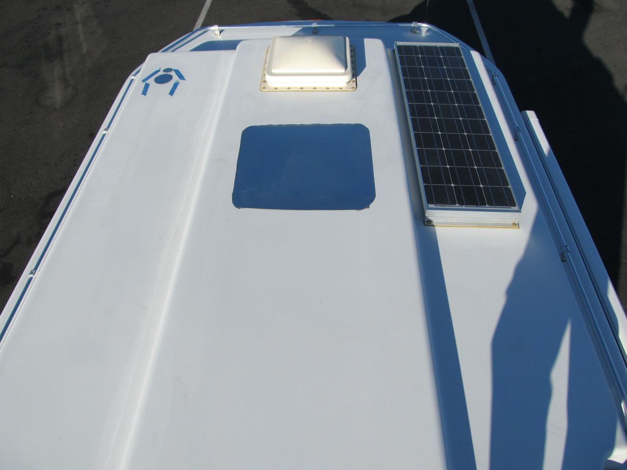

And here is the flashing on the roof. (The blue tape you see in upper left is where I removed the TV antenna, then filled the holes with epoxy. You can't paint or gelcoat epoxy until it has cured for some time, yet until then it is sensitive to UV, so I put tape over it while it finished curing - it's already totally hard and waterproof, but needs some weeks/months for the epoxy to finish so the paint or gelcoat won't react with it.)
