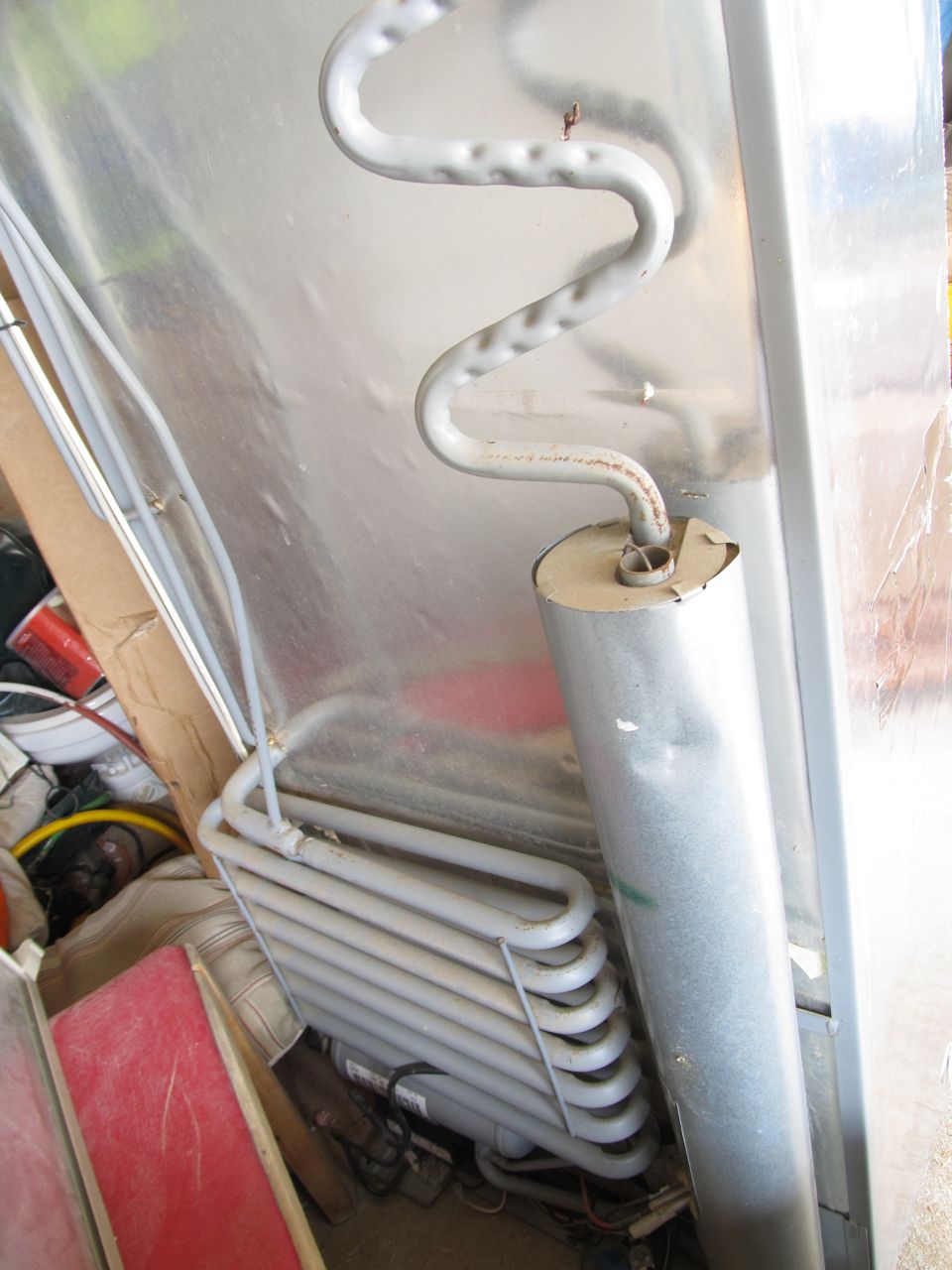

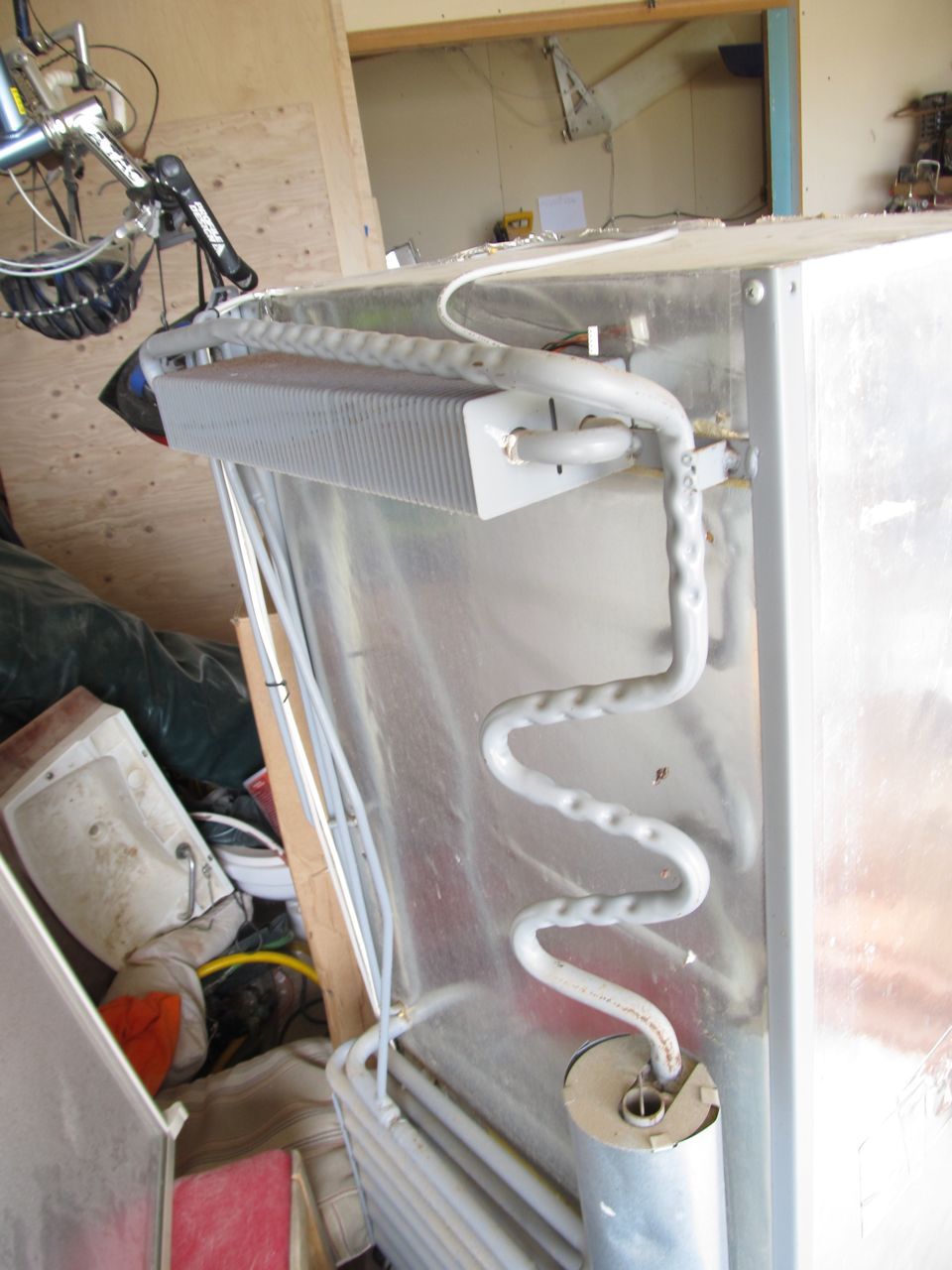

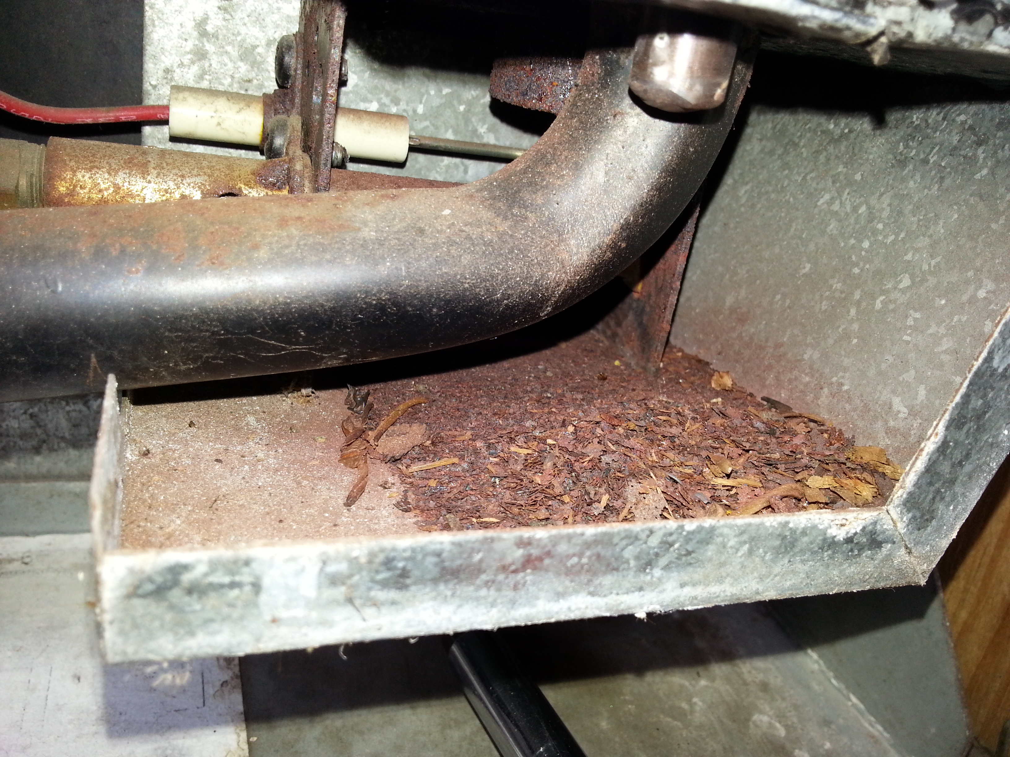

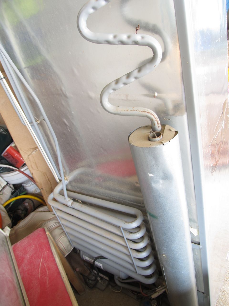

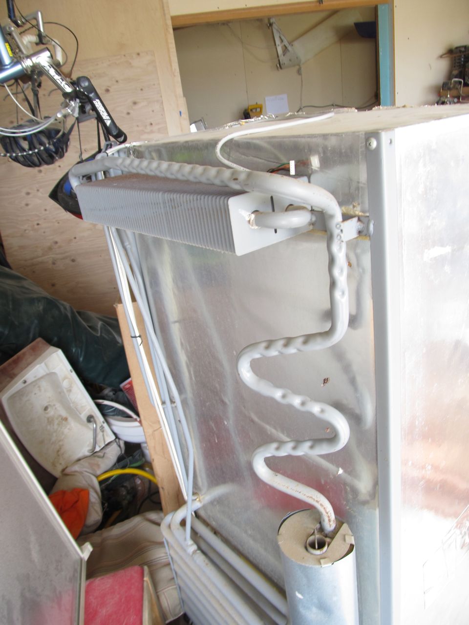

For starters, here are a couple of photos showing the rear of the original refrigerator, after it was removed. This is basically what any absorption (propane) refrigerator looks like on the back. The pipes/burner/etc. are the "cooling unit" and are affixed right to the back of the refrigerator.

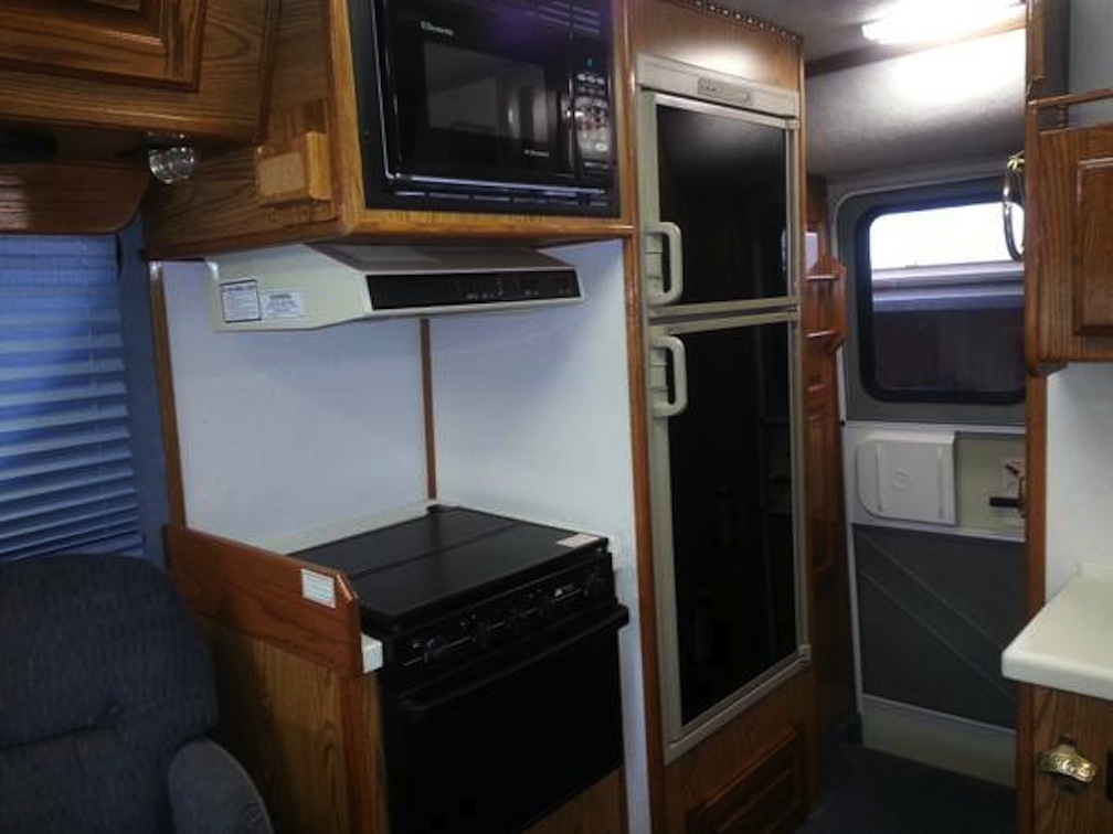

And here is a photo of the original refrigerator in the original Concourse cabinetry. Looking at this reminded me that the refrigerator didn't go all the way up to the ceiling (although there is no accessible cupboard space above it). So this leads me to the conclusion that the "vent indent" was simply avoided by having the refrigerator live completely below it. Hence as long as a new one is no taller one likely will not have to worry about said indent.

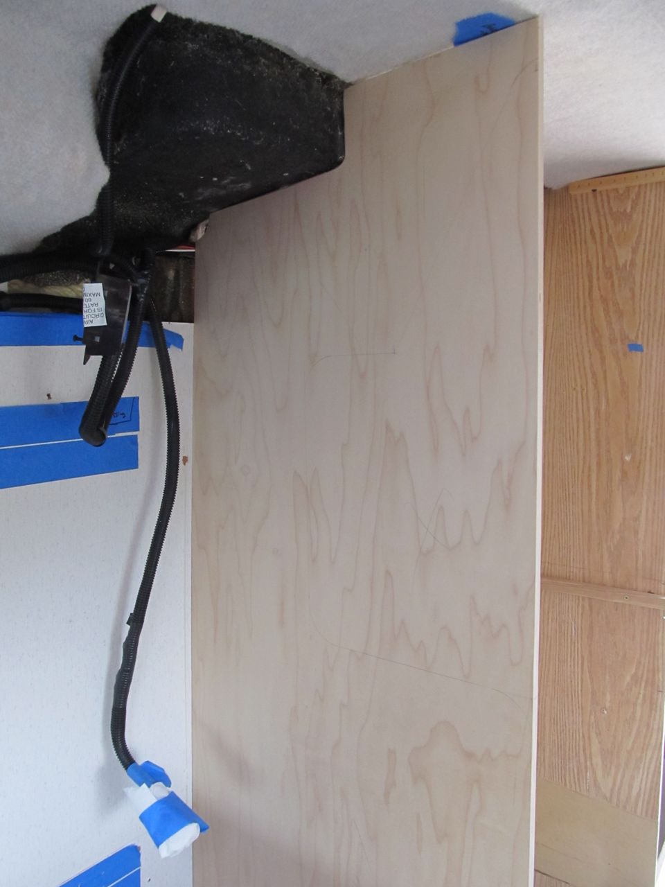

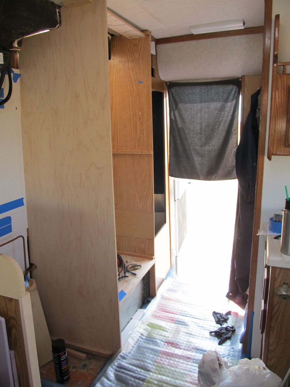

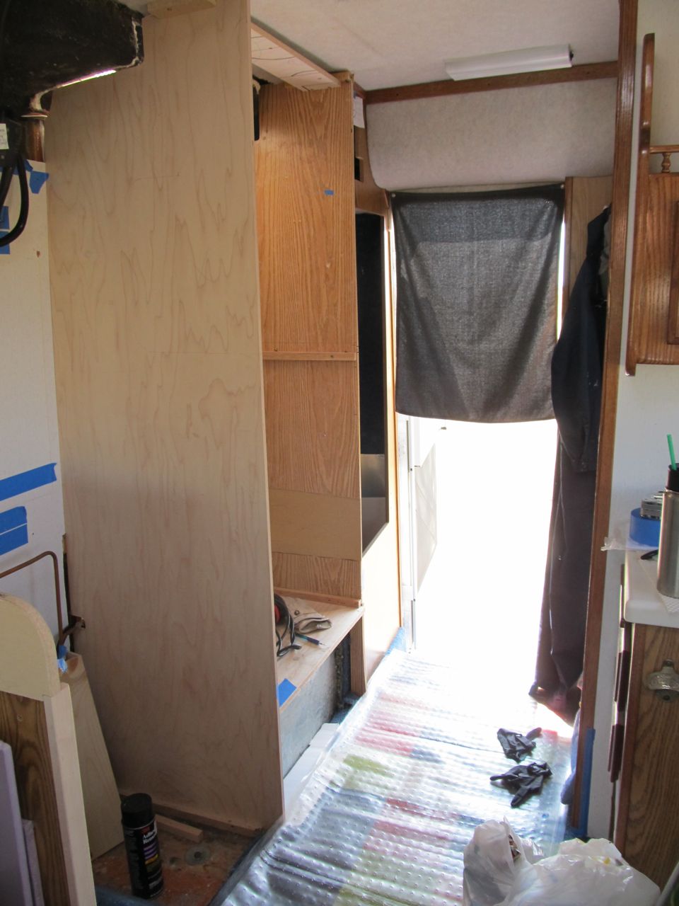

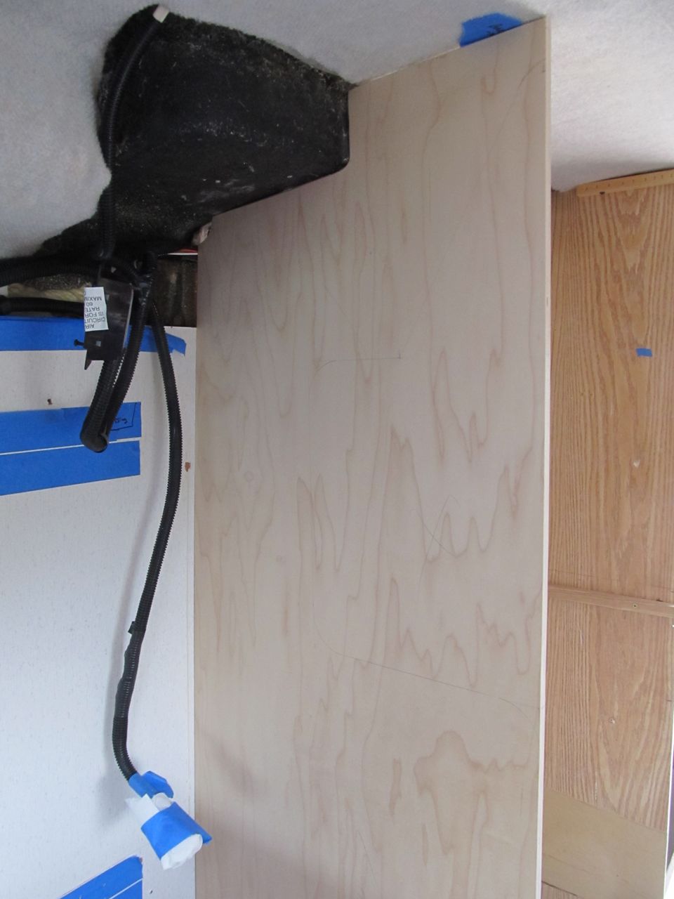

And here are a few construction photos that show some of the things mentioned above. I realize that I just said you probably don't have to worry about the vent indent, but since I mentioned it I thought you (and/or someone else reading in future) might like to see it anyway.
This first photo is of the forward closet wall. This would also be the "right hand" refrigerator wall as you face the refrigerator. You can see the vent indent at the top (black fiberglass). This wall is just aft of the end of the indent, so does not intersect it (instead it intersects the normal sporty dip that runs all the way around the roof edge). The white rectangle is just a bit of left over paneling that I was using to temporarily cover the vent hole to keep wind out.
In the next photo the darker wall in the background is the same closet wall from the previous photo, and the lighter wall is the beginnings of the wall that separates the refrigerator area from the stove area. This shows how the "vent indent" on the roof continues into the above-stove area. It's hidden behind the microwave in the original interior setup. You can also see how the vent indent relates to the "sporty dip" that runs around most of the roof edge. (The dangling wires are the microwave AC outlet and some of the roof air AC wiring.)
This photo shows the refrigerator as more of a compartment, which is also how it is originally. You can just see the black "vent indent" peeking out up at the top. Down below, you can also see how the generator box relates. In this photo the generator box has been stripped of all carpet/padding/glue so it's just the bare metal (in my rig it is a sheet metal box that extends both above and below the living area floor, and encloses the generator). This is before the addition of modern-day soundproofing.
The overall refrigerator compartment is less "protruding" into the hallway than the original (which was one of my big goals). If you look at the ceiling you can see a line in the carpeting that's some inches out from the new box - that's the line of the original refrigerator front wall. I wanted a more roomy hallway space as I didn't like the constricting effect of the original (and along the same lines, the "limbo cooking" position under the microwave).

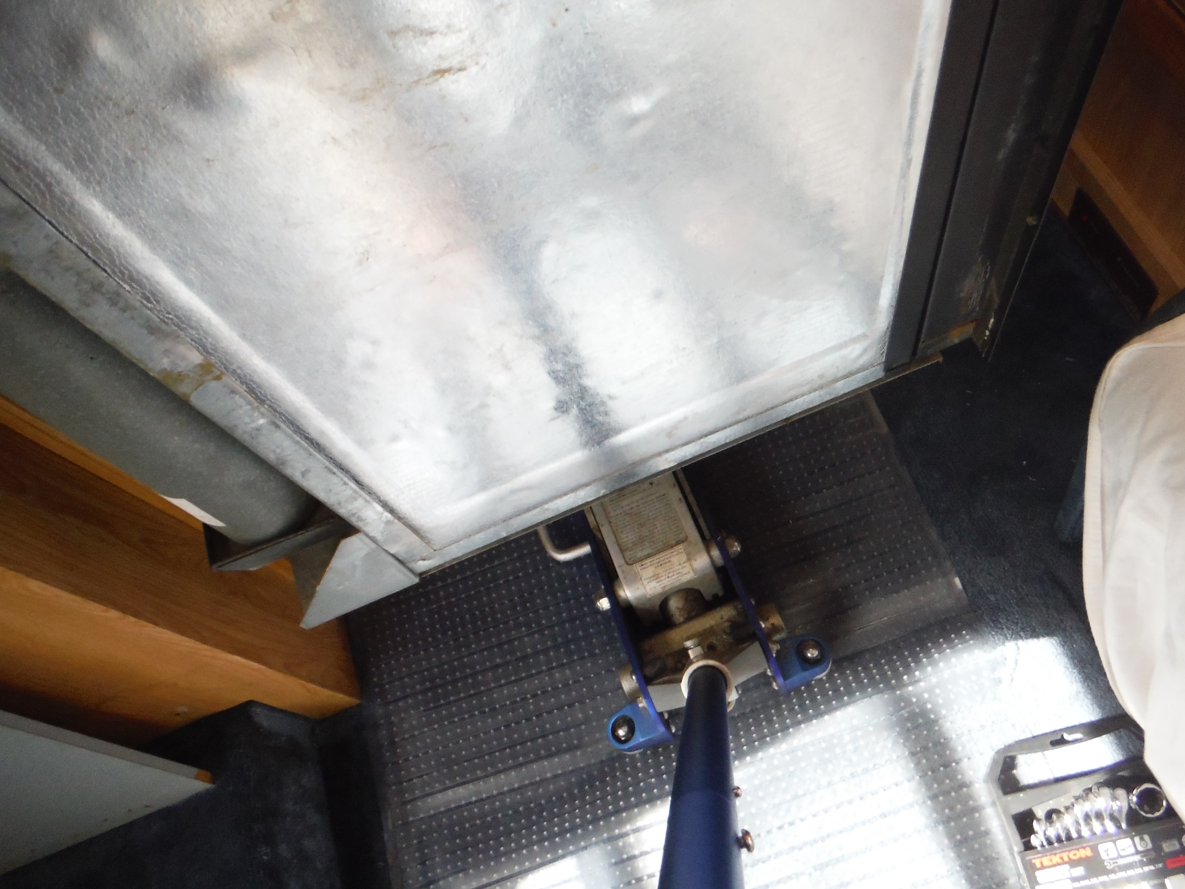

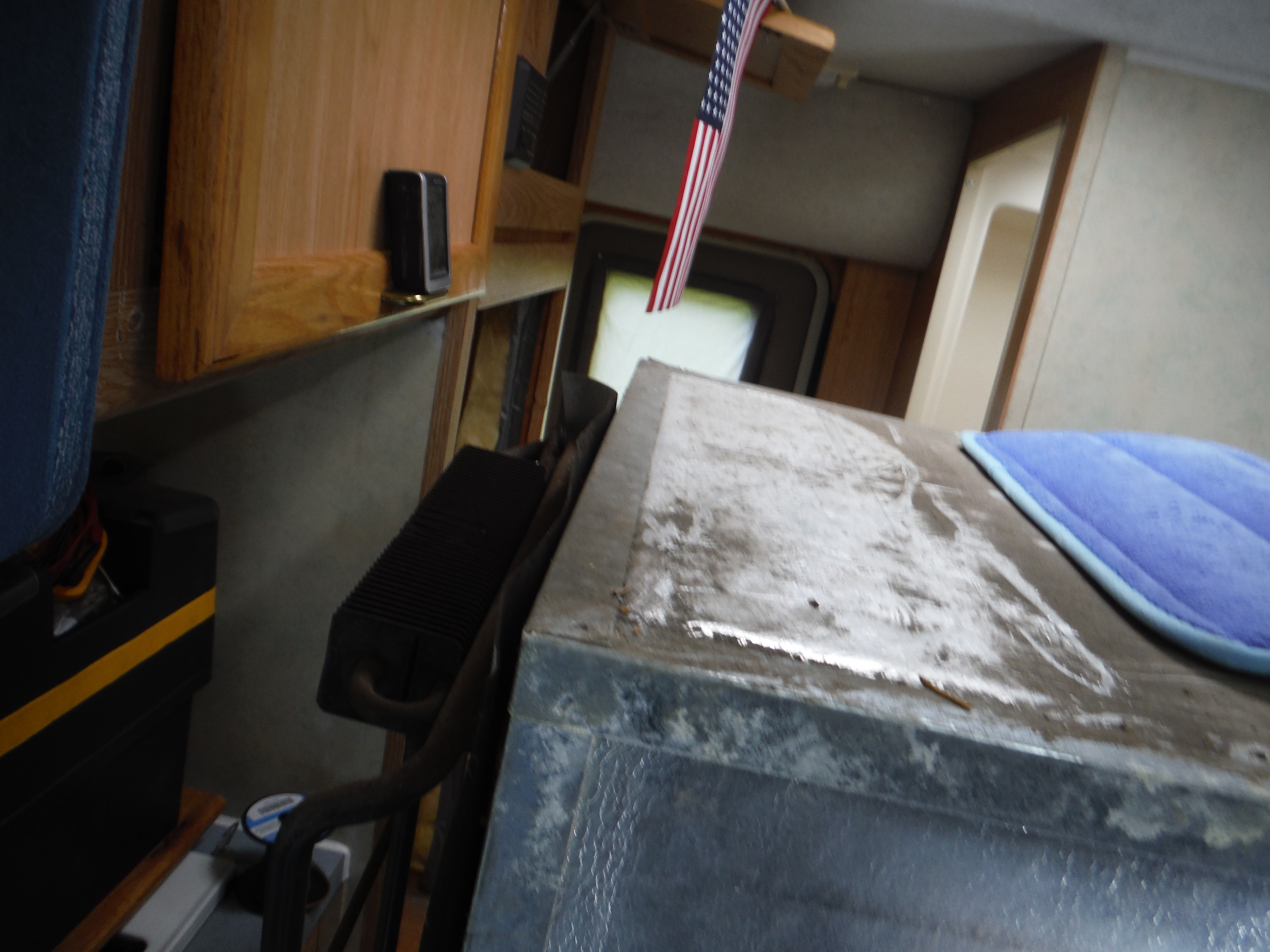

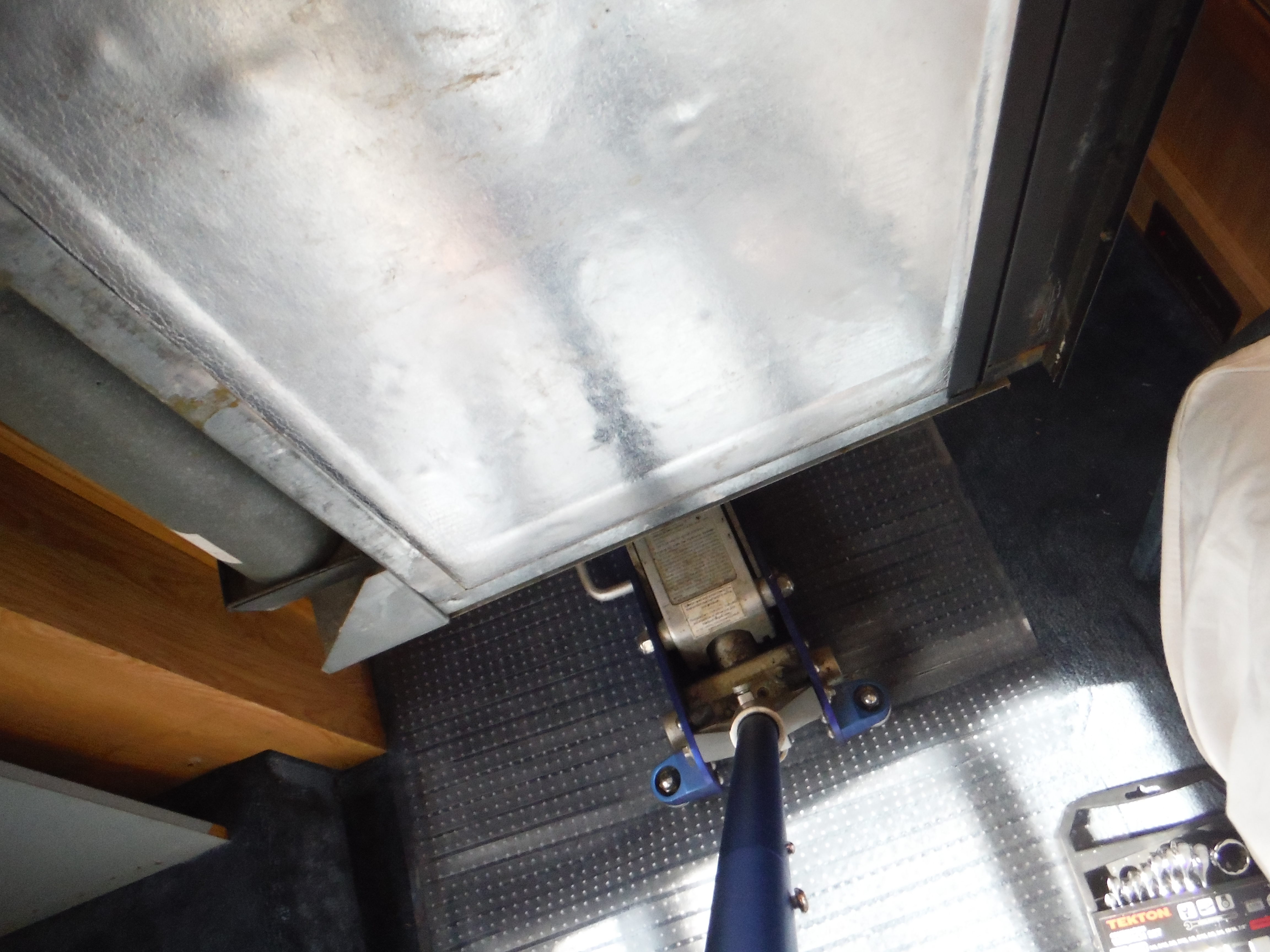

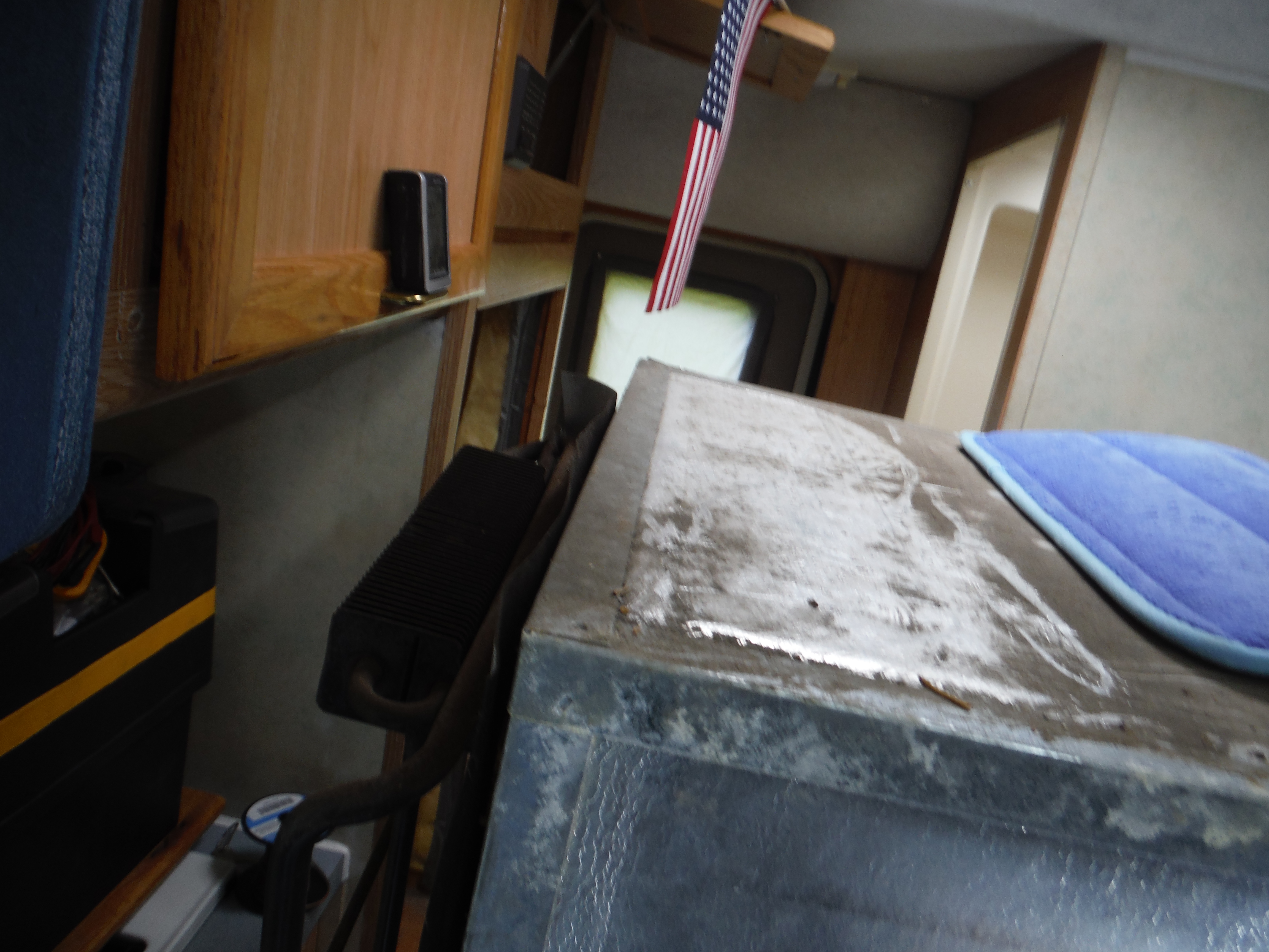

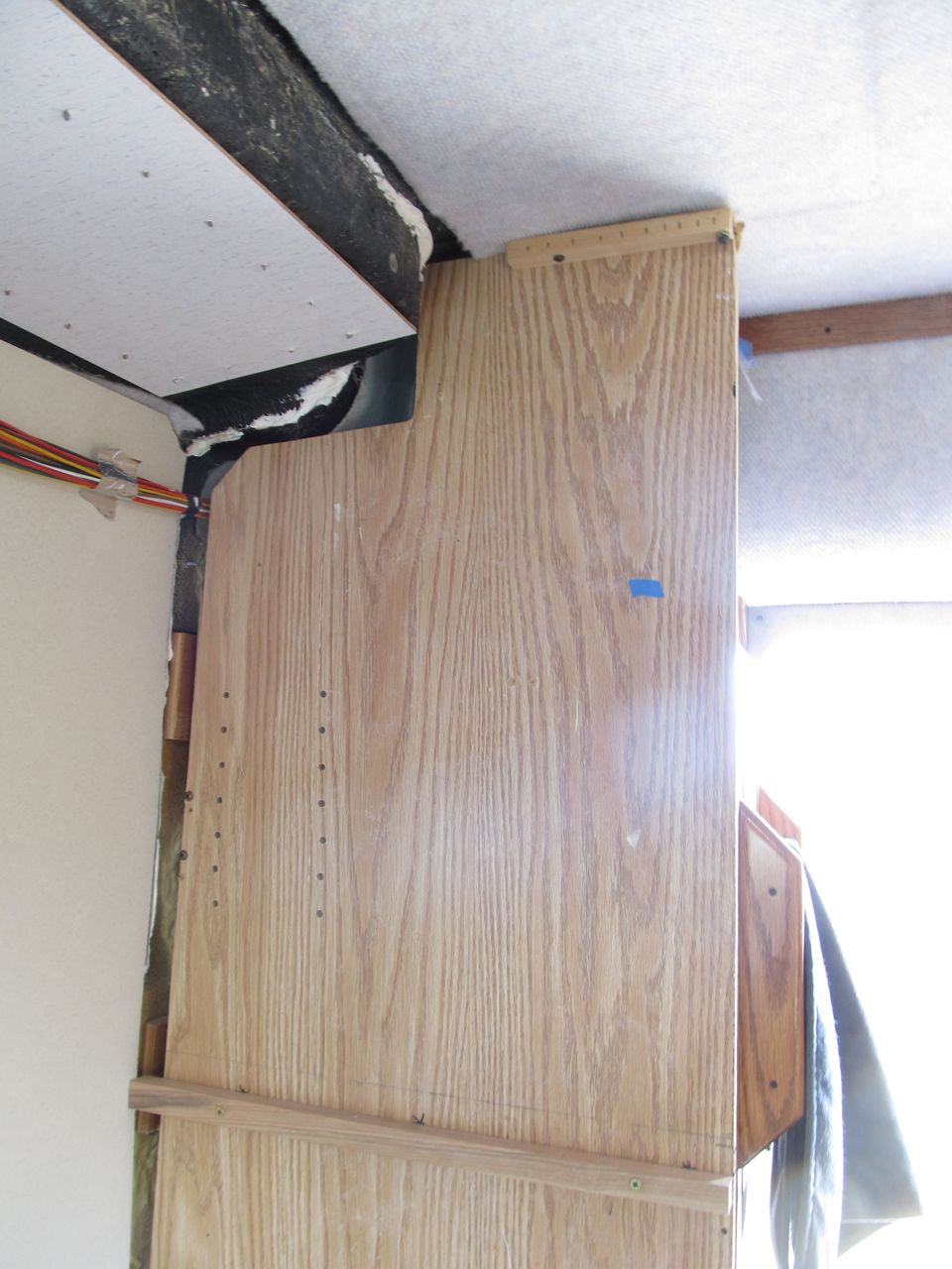

I just checked my records and my stock fridge was the Norcold 6052. Single door, short, and I have a cabinet above. I figured I could contribute with some pics for future generations. I don't have a pic of the final installation trimmed out, but should be able to get one tomorrow. For now, here's what I did.
